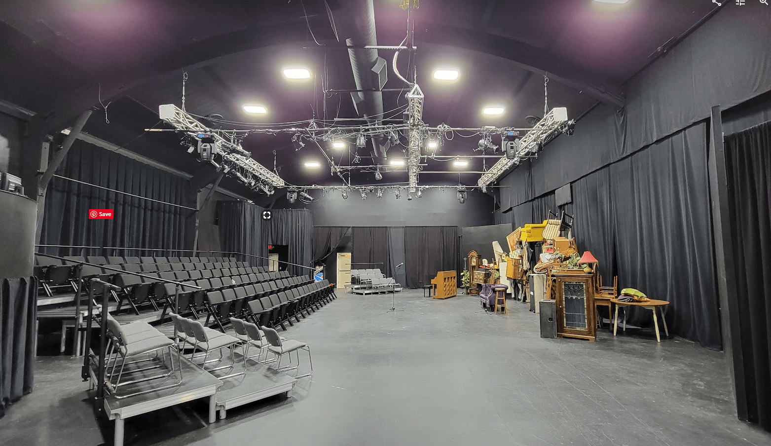

I did some poking around the main site and didn't find specs like freq response and waveform angles for the SLA pro. Hoping to get some info on them as a possible use for my live theater PA.
There is a photo at the bottom that will give you an idea of the space and I'll add more drawings when I get back to work.
Long story (skip if you don't care). This is a small, non-profit theater black box. 60' long (in the direction the camera is facing) and 50' wide. Grid is installed at about 15' above deck. Important part, the whole theater is modular. I can set up a stage anywhere and seating risers can move to any configuration; in the round, one-sided, two sided on an angle, 3/4 thrust, darn near anything. Even the tech booth on the far left, near, is on casters, so it goes where I want it. Current sound reinforcement comes from a Yamaha 750x2 with a few more amps on standby. They feed four Yamaha 12" cabinets (unseen) just above the lighting grid hanging from swivel links so I can spin the speakers to point toward the audience wherever I put them.

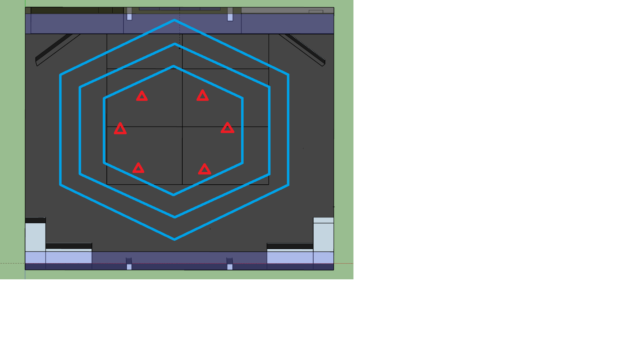

I agree. My concern is with the horizontal. Given the fact that my seating might be sections of 6 chairs wide (in the round) or 25 chairs wide (proscenium), I'm worried about putting all my eggs in one cabinet, so to speak. Two 4x6s would be great for 1/4 and 2/4 seating, but useless for 3/4 and round seating. I was hoping that more (and smaller) dispersion drivers would be more flexible, and that would have to be better than 4 big cabinets on the ceiling.
Let me get a sketchup together quick to demonstrate

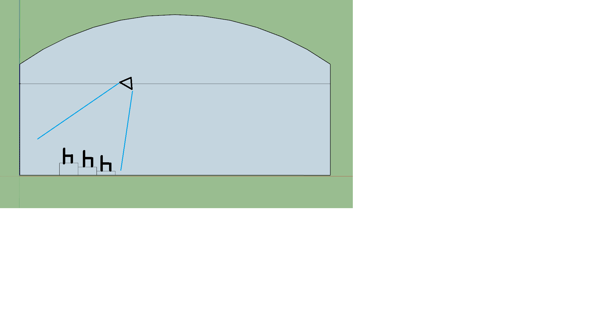

A quick and ugly section view of what it might look like in there with proscenium seating. The risers actually go to 5 levels, but I'm lazy. That seating is usually 32' wide, so a couple 4x6 would be perfect in this configuration. The other image shows what it might look like in-the-round, where I'm needing to focus on narrower sections, or trying to pull the cabinets back over the stage to utilize the wider dispersion.
So I think the question is, do I do more 2x6 or fewer 4x6. Which ones (or a mix of both) would be more flexible for this variable configuration?

You probably don't need as many sources as you think. The beam width of an array of sixes is 100 degrees, so superimpose that on your chart.

I don't have a problem with vertical dispersion necessarily. I'm trying to remember, but I think they are 40-degree vertical and 90 horizontal and they're hung angled to point at where I usually have audience set up. I think the primary problem with the four 12s way up high is that I'm driving them hard enough to reach 40 feet away from the most distant ear. By the time I make enough dB, I'm adding to the reverb. The closer I am to the individual ears, I need proportionally fewer dB to accomplish the same volume reaching the people, and also firing toward soft seats and soft bodies. Part of what I'm experiencing with the 12" cabs is that it kind of blasts everything in the room. I'm hoping for some discrete focusing on people. I think the lower SPL will make the reverb a hundred times better, and getting it closer is key to that. I'm not sure (given the angle at which they're firing) if broadening the horizontal is going to work in the round seating without pulling the sources back away from the seating and putting them over the stage, which could contribute to feedback.
I'll amend the previous drawing. Please note that the drawing IS to scale as it pertains to seating and the section dimensions of the space, but NOT as it pertains to speaker placement or the angles. I just drew in the speakers and the angles as a demonstration of what I'm looking for.

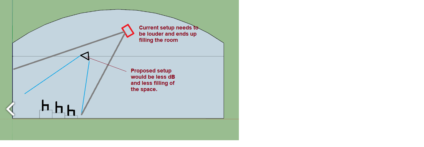

Here is what I was thinking. I know I'm over-explaining, but imagine you're amping a cathedral. If you hide the speakers in the top of the clerestory, you are just adding to the reverb. Until you drive them loud enough to be heard, all you hear is the whole church bouncing back. Now put the speakers on the pillars of the ambulatory about 20' from everyone's ears and drop volume proportionally. They can still hear reverb, but they're getting the clear voice primarily. Then send it through headphones to everyone and drop another chunk of volume. Suddenly zero reverb.
I'm not necessarily concerned about reducing vertical dispersion, although that DOES contribute to reverb, I'm looking to add discretion. Half way between a big driver in the rafters and wee little headphones 2" from your eardrum. I'm thinking (maybe incorrectly) that it should make it much better, regardless of if I use one bigger box to cover 100 degrees or 2 smaller boxes to cover 50 degrees each. The 4x6 has tighter vertical, but I'm not sure it will make much difference the way I would aim them.
In the photo below, I'm getting more discretion and a tighter pattern from the same vertical dispersion angle because they're closer to the humans in the audience. My problem with the big speakers is that they're so far away they just fill the whole room. That is to say, I feel like my current setup is great for a basketball game or a dance party, but not good for vocals to a small audience.
Thoughts?

The reason I mention vertical dispersion is that sound that reflects off the ceiling and/or floor contributes to early reflections, and doesn't end up in the audience as direct radiation. You're on the right track with your diagrams, you just need to refine them. The dispersion figures you mentioned would be for the HF horn, not the woofer. It would have the same beam width on the horizontal and vertical planes. Typical beam width of a twelve in the mids is 60 x 60 degrees. Speaking of churches, the first major implementation of line arrays was in St.Paul's Cathedral in London in 1949. They were used until about ten years ago, when they were replaced by new line arrays.

I hope there is some merit in your thinking about distance.
IIRC, SPL drops by 6dB with each doubling of distance, ie 3,6,12,24 feet roughly.
With 40 odd feet, you have around 3 1/2 doublings, or -21dB from a 1meter SPL reading.
Moving your cabs forward towards your audience by 14 feet would see that back to -18dB.
Not a large saving by any means, but also means a possible 3dB reduction at 1 meter, which may be enough to help some more...
That makes me wonder if some 2 x6's as rear fill/satellites may allow an even greater overall reduction in dB in the mains...
