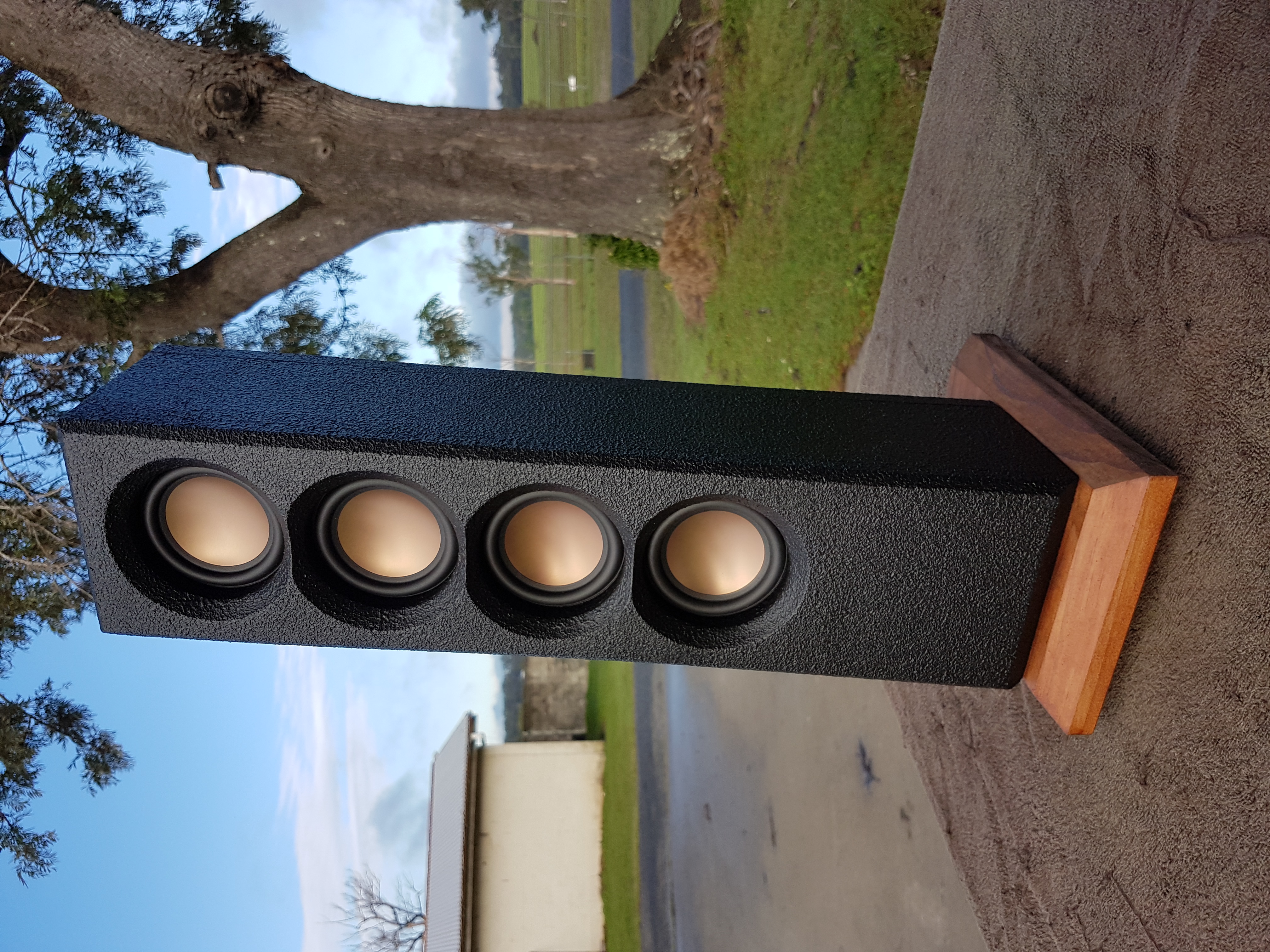

Similar looking drivers to the ones you linked, click on the image and it will straighten up.

These look very much like Hivi B3S, Keryn. I have a load of them, intending to build SLA's just didn't get the round tuit just yet :wink:

AntonZ wrote: Fri Feb 03, 2023 6:14 am These look very much like Hivi B3S
They do mate, almost identical!

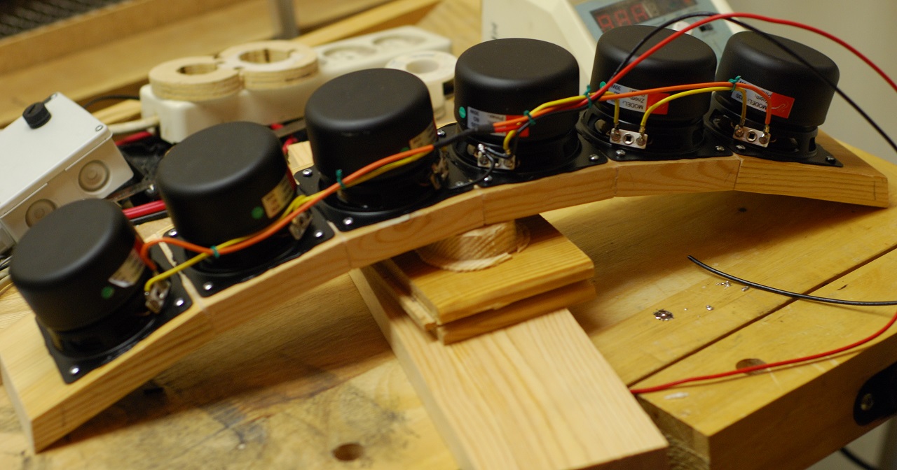

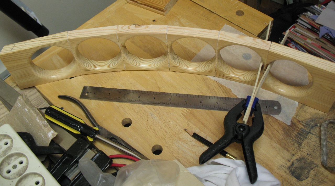

I had a quick look on my computer and found some build progress pics of the SLA center. I thought I also had pics of the completed cab but cannot seem to find them. I will dig it out and take some. Same for the frankencab. Stay posted but don't hold your breath :wink:

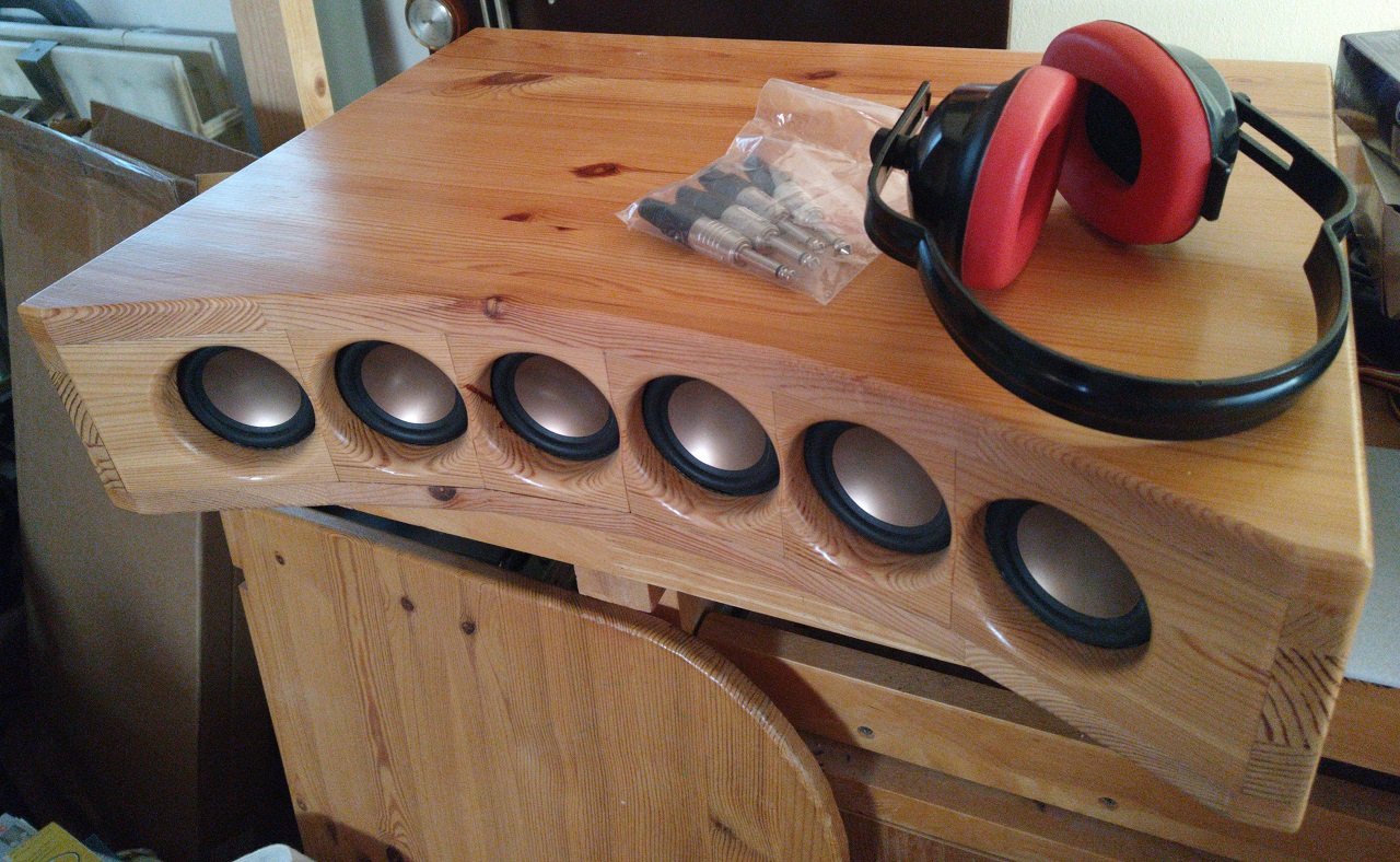

Here's the center cab. Hearing protection and a couple of Neutrik 1/4" jack plugs for size reference.
I did find some old pics from way back when I was building this.
This is the most beautiful cab I have made to date. Sound was a disappointment.

AntonZ wrote: Wed Feb 08, 2023 11:08 am Here's the center cab
Mate.. Superb! The effect quarter rounding has on showing the grain that way is cool, and thanks for sharing your baffle stick clamp idea. What let you down with the SQ?
