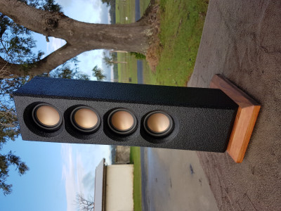

Similar looking drivers to the ones you linked, click on the image and it will straighten up.

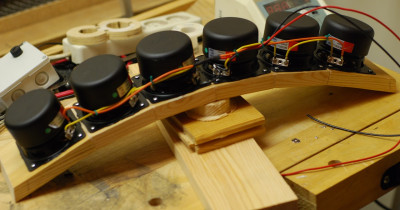

Another thing I tried with the little Hivi drivers was a curved center SLA. I think I applied way too much damping to that one as it sounded dull and muffled. It does look totally awesome. Still have it, I can post a pic if anyone wants to see what these would look like recessed in nice pine wood.

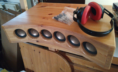

Here's the center cab. Hearing protection and a couple of Neutrik 1/4" jack plugs for size reference.

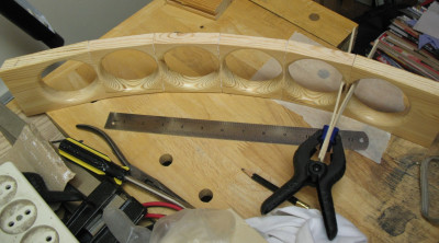

I did find some old pics from way back when I was building this.
This is the most beautiful cab I have made to date. Sound was a disappointment.

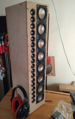

And here is the FrankenSLA.
It is the ugliest I ever made. By far. It sounds absolutely fantastic.

Not sure if you mean driver count or size? It was experimental. Mind you, the drivers are small, only 3" each. The array length is just about the same as a regular 6 units SLA with 4" drivers. The cab would be just about the same size as any 6 driver SLA, built with 4" drivers. Also, I had a whole bunch of these stupid cheap piezo tweeters at hand.
The thoughts were:
This thread makes me contemplate going back in again, dig out those pretty 3" drivers and pizzers and build two proper SLA's.
The thoughts were:
- 3" drivers go higher than 4" so you need less from your tweeters
- these are full range drivers, so would it work without any tweeters at all?
- piezo's can be used without filter, these are tiny piezo's so very high freq only, and the 3" roll off higher than 4": would it work without any filtering?
- if so, how many tweeters?

Mate.. Superb! The effect quarter rounding has on showing the grain that way is cool, and thanks for sharing your baffle stick clamp idea. What let you down with the SQ?

The thoughts were:So I had the 3" drivers wired separatedly from the piezo's. And the tweeters are wired in two half arrays, or one array of 2/3 length the other 1/3 length, don't remember exactly. So I could try main drivers full range only, half tweeter array, full tweeter array. Turns out it worked fine indeed. It sounds nice, crisp and totally smooth with the full length mini pizzer array.
