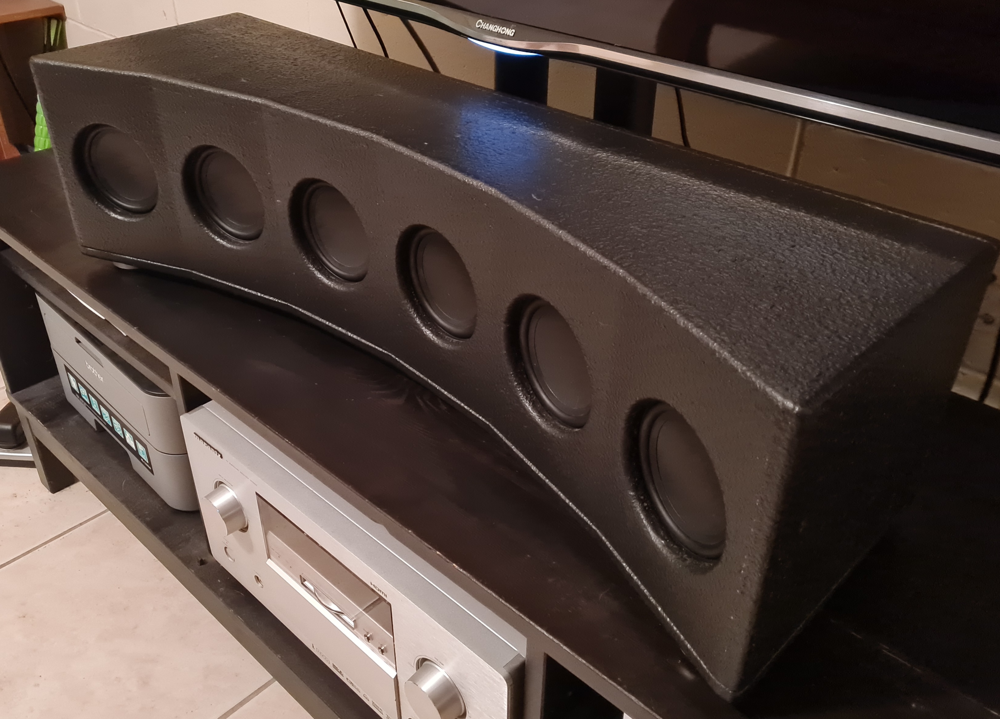

Good evening all,
I'm looking for suggestions on a way to build something to drop tweeters on top of the pictured Curvearray. I built it way back when without tweeters.. not sure why. I had a single silk dome sitting at the front/centre, that was cute, but wasn't really cutting it. I'm also free to use more than 6 tweeters, would you go nine? And finally should I even bother as they'll be quite a distance from the mids?

I'd duplicate the existing box made just high enough for six tweeters. Either that or start over.

What's the measurement from the top of the woofer cut out to the top of the cab? Is there not enough room to drill and put surface mount tweeters there?

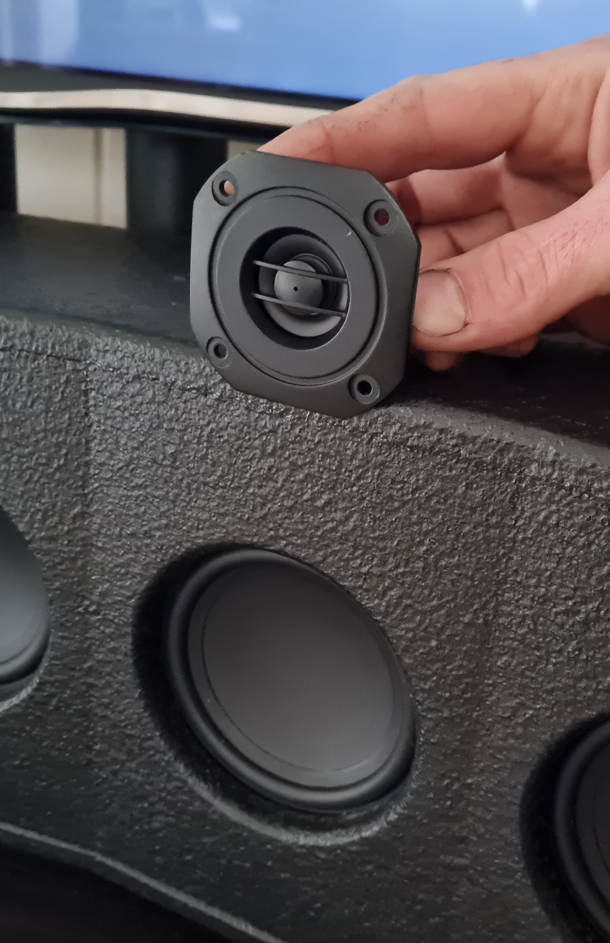

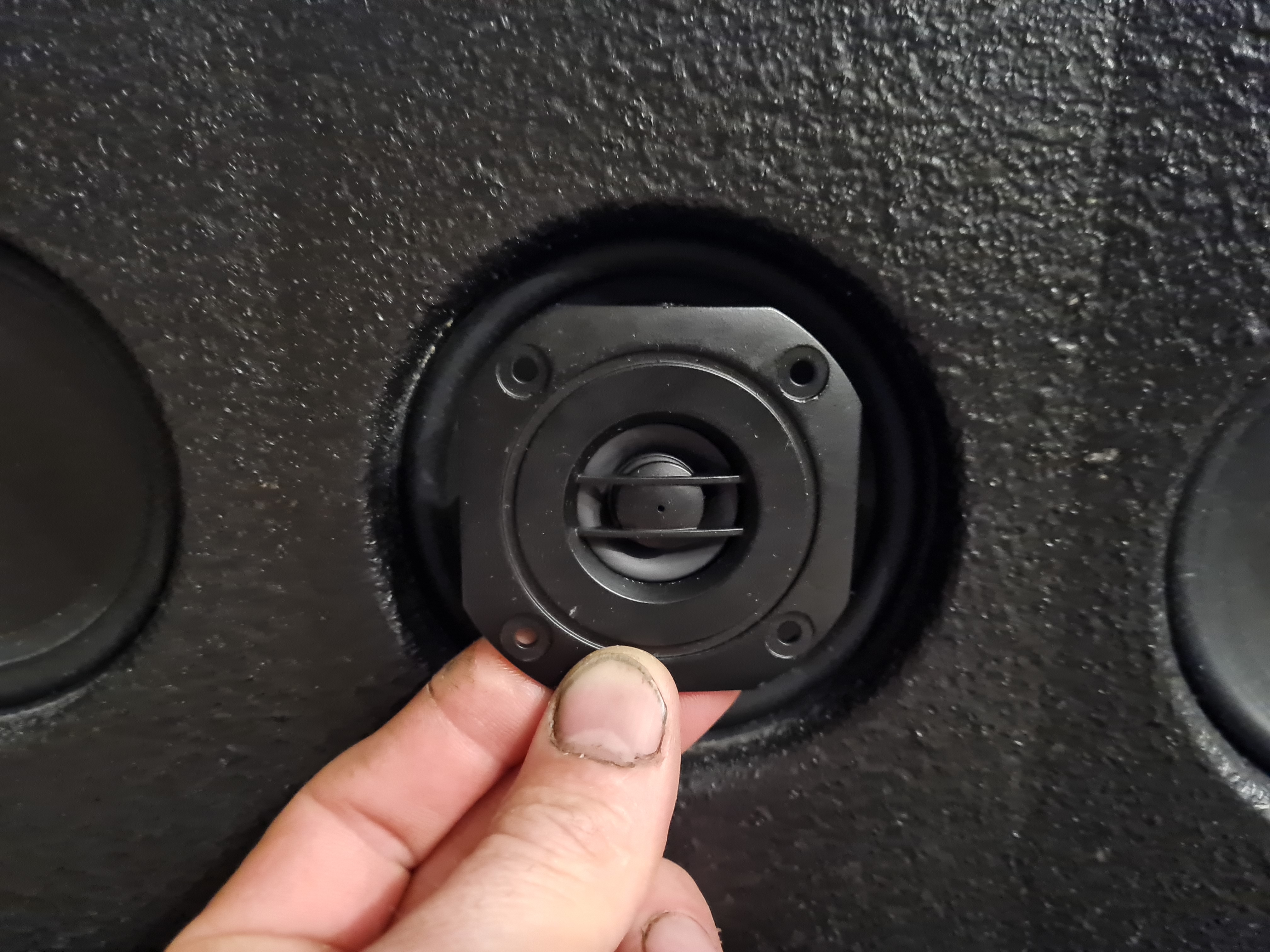

Seth, the driver cutouts are centred on the baffle so there's not enough room for a GT-302 above the mid, even shaving both component frames and the inner of the cab, I just sat over at the cab with a GT-302 to find that out, but... I noticed that there is enough room to fit 5 tweeters in between each mid on the join of each baffle. I can sort the gap at the tweeter frame with something.
So now my question is, would five tweeters work out with impedance/filters..
Actually there could be 2 tweeters on the centre baffle join, that makes 6. If I'm making a mess of this now, just tell me and I'll let myself out..

If the tweeters were to be built into a frame which sits on top of this cab, would they be too far away from the mids?

Less than ideal, but serviceable. You'd have to be within three feet or so to notice any problem.

- Mount the tweeters in front of the woofer on two strips of wood that bridge the woofer cutout.
- Mount the tweeters behind a cloth grill that fits to the face of the array, hiding any unsightly overlap.
- Get tweeters with smaller frame dimensions that would fit your existing available space.
- Router filler discs, glue them in the existing driver cutouts, fill any voids with Bondo, sand flush, relocate the cutouts lower, allowing the tweeters to be mounted above. Still way less work than building one from scratch.

Heck, if you were to go to all that trouble, why not just redo the baffle from scratch.
Cut out the existing baffle with a multitool, pop a new one in that has everything in the right place.
Way faster, easier to work, sand etc.
Provided there's enough room to add tweets or lower the drivers...

You could also "raise the roof" of the cabinet.
Mark off the inner sides sides of the side pieces onto the top (as if you had x-ray vision and were looking down and through the top, seeing the side boards.)
Drill four corner holes inboard of the sides, so that you don't damage them.
Connect the holes with a jigsaw, avoiding the baffle until you can see what you're doing.
Then glue another, new top piece on top, extending the height of the cabinet by the thickness of the original top (that you just cut most of off.)
You should pick up about 12.5 mm of real estate to work with. If 12mm isn't enough to do the job add furring strips of adequate thickness.

Yes, with a 9 driver cab! The more I look at it, cutting into a finished cab unless there was something quite wrong with it (like not enough braces in a T30Grant Bunter wrote: ↑Sat Sep 03, 2022 4:29 pm Heck, if you were to go to all that trouble, why not just redo the baffle from scratch.
Would I be losing anything from the woofers if they were mounted in front? And if they were mounted any further forward of the woofer, would that cause a problem with sound?
- Posts: 29105
Re: Curvearray questions
Putting them in front will cause some loss of upper midrange. Frequencies with a wavelength significantly greater than the diameter of the tweeters will go around them, but frequencies with a wavelength shorter than that won't.
