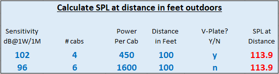

8 T48's would cover a football field handily. Are you familiar with the calculations used to roughly predict predict output over distance? I'm happy to share if you're not.
Yes, your amps will run them pretty well

That sounds perfect, exactly what I want to end up with.
I would love to have the equations, then I can build out some spreadsheets.

Well, there's the down and dirty method and there's the spreadsheet method. Neither is 100% accurate and repeatable in the field due to things that are unaccounted for, such as deployment arrangements, power compression, the effect of bodies in the space, landscape, etc. But, they'll give you a near realistic benchmark and expectation to work with. Here's both methods.
Product marketers will look at these graphs like this and use the highest number and claim that's it's sensitivity. More honest companies tend to average the response sensitivity over the usable frequency range and use that figure as average sensitivity. Personally, I choose the least sensitive figure in the frequency range I expect to reproduce faithfully and base my calculations on that figure. Whether you use 35 or 40Hz is up to you. Most of the time I use 40Hz, because I mostly deal with live music outdoors and 40Hz is the bottom frequency of the frequencies I want to faithfully reproduce and also happens to be the least sensitive point I intend to reproduce.
So, I look at the graph and see the sensitivity of the 36" T48 is about 102dB at 40Hz with 2.83v/1 watt input.
Here's the rough calculations;
Double your power, +3dB
Deploy with a V-Plate, +3dB
The first 100 Watts, +20dB
The first 1000 Watts, +30dB
Double your cab count, +6dB (this is considered +3dB for doubling power and +3dB for doubling the area of the radiating plane (mouth area of a horn loaded cab or speaker cone area of a direct radiating cab) and also assumes the cabs are placed next to each other so that they couple)
Double the distance from the cab, -6dB
Loss over 10 Meters (32.808 feet), -20dB
Loss over 31 Meters (102 Feet), -30dB
Loss over 100 Meters (328.08 feet), -40dB
102dB, plus 20db for the first 100 watts, 122. Plus 3 doubling power to 200, 125. Plus another 3 doubling power again to 400 watts, 128dB (I'm not going to worry about that last 50 watts in this rough calculation. It's only 0.5dB). Double the cab count to two cabs, plus 6, 134dB. Double the cab count again to four cabs, plus 6, 140dB. Add a V-plate, plus 3dB, 143dB at 1 Meter. 33 feet out, minus 20, 123dB. 100 feet out, minus another 10, 113dB. 330 feet out, minus another 10, 103dB.
It's worth noting that due to the way human hearing works, 110dB at 40Hz will only sound as loud as about 90dB at 1kHz. But, it will have impact. Research Equal-loudness contours.
For a spreadsheet, paste this into cell F1
=A1+(LOG(B1*B1)*10)+(LOG(C1)*10)-(LOG((D1/3.2808)*(D1/3.2808))*10)+(IF(ISODD(B1),0,IF(E1="Y",3,IF(E1="N",0))))
Where cell-
A1 is the base sensitivity
B1 is the number of cabs
C1 is power per cab
D1 is distance in feet
E1 is if there is a V-Plate being used, enter Y or N. The formula also automatically disables this option if an odd number of cabs is entered, even if box E1 has a "Y" in it.
Here's how I have mine set up for easy A-B comparisons. In this case comparing four V-Plated 36" T48's on 450 watts each (1800w total) to six JBL SRX728's (Double 18" ported cabs. Twelve 18's altogether) at 1600 watts per cab (9600w total).
Pop quiz-
- How much power is needed at 40Hz in a 36" wide cab to match the output of the 24" wide cab at 450 watts?
- How many V-Plated 24" T48's at 450w per cab does it take to match or exceed the output potential of four V-Plated 36" T48's with the same power per cab?
Where cell-
C1 is power per cab
Pop quiz-
