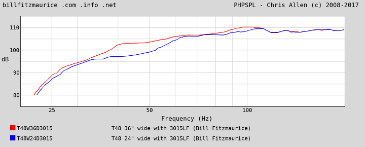

Well, there's the down and dirty method and there's the spreadsheet method. Neither is 100% accurate and repeatable in the field due to things that are unaccounted for, such as deployment arrangements, power compression, the effect of bodies in the space, landscape, etc. But, they'll give you a near realistic benchmark and expectation to work with. Here's both methods.
Product marketers will look at these graphs like this and use the highest number and claim that's it's sensitivity. More honest companies tend to average the response sensitivity over the usable frequency range and use that figure as average sensitivity. Personally, I choose the least sensitive figure in the frequency range I expect to reproduce faithfully and base my calculations on that figure. Whether you use 35 or 40Hz is up to you. Most of the time I use 40Hz, because I mostly deal with live music outdoors and 40Hz is the bottom frequency of the frequencies I want to faithfully reproduce and also happens to be the least sensitive point I intend to reproduce.
So, I look at the graph and see the sensitivity of the 36" T48 is about 102dB at 40Hz with 2.83v/1 watt input.
Here's the rough calculations;
Double your power, +3dB
Deploy with a V-Plate, +3dB
The first 100 Watts, +20dB
The first 1000 Watts, +30dB
Double your cab count, +6dB (this is considered +3dB for doubling power and +3dB for doubling the area of the radiating plane (mouth area of a horn loaded cab or speaker cone area of a direct radiating cab) and also assumes the cabs are placed next to each other so that they couple)
Double the distance from the cab, -6dB
Loss over 10 Meters (32.808 feet), -20dB
Loss over 31 Meters (102 Feet), -30dB
Loss over 100 Meters (328.08 feet), -40dB
102dB, plus 20db for the first 100 watts, 122. Plus 3 doubling power to 200, 125. Plus another 3 doubling power again to 400 watts, 128dB (I'm not going to worry about that last 50 watts in this rough calculation. It's only 0.5dB). Double the cab count to two cabs, plus 6, 134dB. Double the cab count again to four cabs, plus 6, 140dB. Add a V-plate, plus 3dB, 143dB at 1 Meter. 33 feet out, minus 20, 123dB. 100 feet out, minus another 10, 113dB. 330 feet out, minus another 10, 103dB.
It's worth noting that due to the way human hearing works, 110dB at 40Hz will only sound as loud as about 90dB at 1kHz. But, it will have impact. Research Equal-loudness contours.
