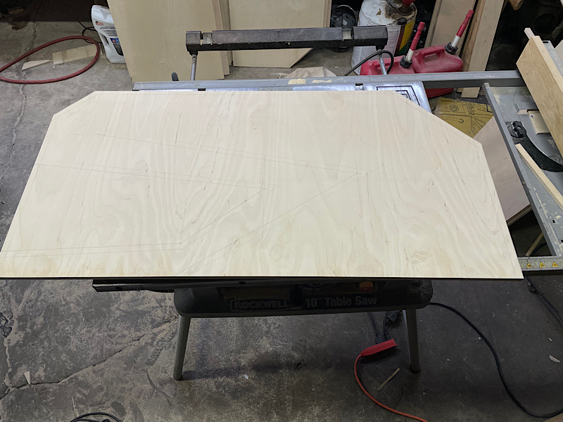

After drawing the lines on layout diagram one and two, do the half inch lines go on the inside or outside of the points drawn?
Posts: 28981
Re: Dunavin’s T39 build
#2 Post by Bill Fitzmaurice »
To the outside. To double check it take measurements on the side in the Sketchup model.

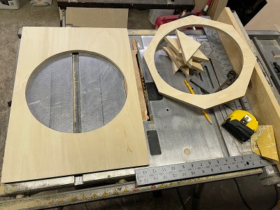

Cut the sides, all internal panels to width, and baffles.

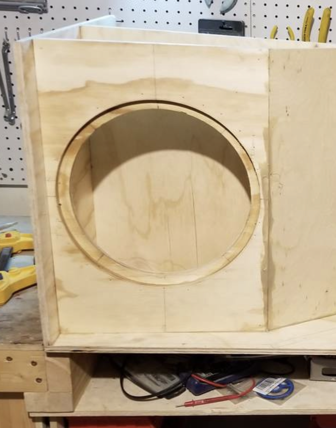

I think I made a mistake
Looking in this thread the driver is sitting down in panel 2. I made panel 2 and the backing plate the same dia.
Do I need to take a router so the 3012 sits down on the backing plate?
Bill, maybe you could tell me what the implications are if this does not sit down a half inch? Will the brace on the door interfere with the driver? Or does it mess up the displacement at all?

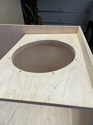

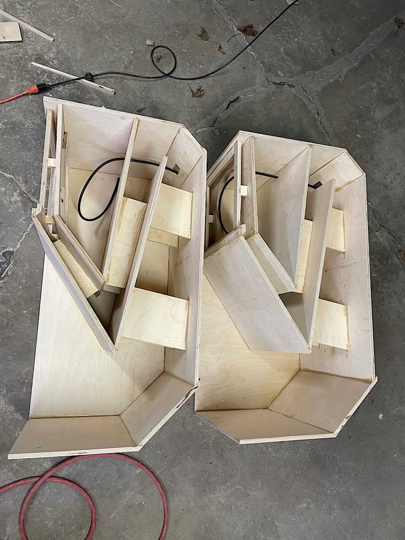

J_Dunavin
Posts: 1279
Location: Appleton WI
#8 Post by J_Dunavin »
What we’ve got currently…
Is this wrong?
Posts: 7622
#9 Post by Tom Smit »
Sorry, but, yes, it is wrong. A fix would be to do the router trick that you were thinking of. Perhaps, you could put a support plate under the backing plate and pin a couple of layers on it to raise the level and thus give the router something to rest on.
All the best to you, in regards to the recovery.
Posts: 28981
Yes, the driver should be inset into Panel 2. The main effect will be to reduce how wide the brace on the access cover can be made. I wouldn't say it's a critical error, but fixing it would be best, which would require a deft hand with a router.

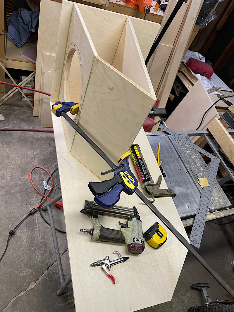

Some further progress tonight….
J_Dunavin
Posts: 1279
#12 Post by J_Dunavin »

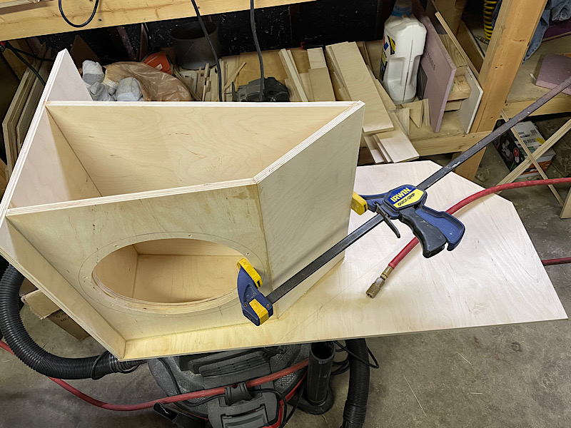

I still need the mouth brace but got the rest put together
A shot before I closed up the side.
Posts: 8597
#13 Post by Bruce Weldy »
Yeah, it's almost a shame to have to close 'em up.....nobody can see all the work that went on inside. I feel the same way about duratex......I love that pretty sanded wood, but ya gotta' cover it up.
