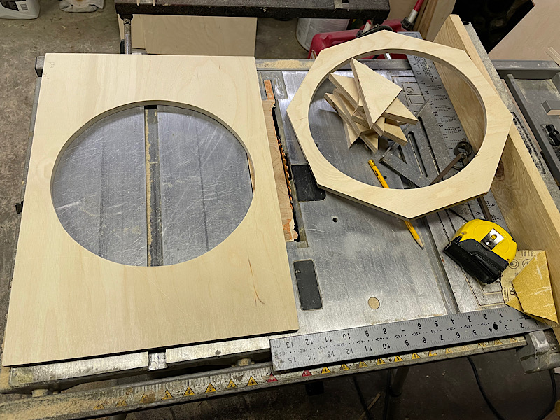

I think I made a mistake
Looking in this thread the driver is sitting down in panel 2. I made panel 2 and the backing plate the same dia.
Do I need to take a router so the 3012 sits down on the backing plate?
Bill, maybe you could tell me what the implications are if this does not sit down a half inch? Will the brace on the door interfere with the driver? Or does it mess up the displacement at all?

Re: Dunavin’s T39 build
What we’ve got currently…
Is this wrong?
Is this wrong?
Sorry, but, yes, it is wrong. A fix would be to do the router trick that you were thinking of. Perhaps, you could put a support plate under the backing plate and pin a couple of layers on it to raise the level and thus give the router something to rest on.

Yes, the driver should be inset into Panel 2. The main effect will be to reduce how wide the brace on the access cover can be made. I wouldn't say it's a critical error, but fixing it would be best, which would require a deft hand with a router.
Thank you Bill for the quick response.
I’m going to give it a go, of which most I can do with the router on the face, except for the top 1/3 of the arc.
Tom you have a good idea there. I’ll have to cut and clamp a board the same height as panel 1. I did check, my handheld router will just have enough depth.
This is going to have to be surgical precision.
