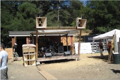

Ah! Found it!
Crappy quality photo file, but you can get the point. 6 AT's to the left of the stage.
From this thread, A sixpack of AutoTuba 10s did well for live sound
Re: How well can auto tubas perform without cabin gain?
The man intends to build 2 and load them with the MCM 8" drivers. The "AT Stack Of Doom" had 6x AT 10". Yeah, the stack pounded freakin' hard, but I think that does not scale down well from 6x 10" to 1x or 2x 8". Is it enough for "very light sound reinforcement applications (party speakers or acoustic bands)"? I think we cannot tell for sure, it depends on so many factors. One would be totally content, an other would be totally disappointed. I would think there is only one way to find out how it works for Mat. Making sawdust is involved.
