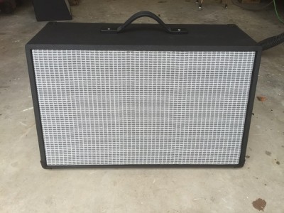

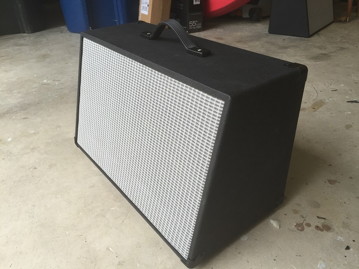

For what it's worth, I used the 3/8 roundover on my XF210 with no corners at all. Corners are a little tough to get looking right with the angled front.
- Posts: 8678
Re: Rounded Edges
Oh, I did use corners on the bottom, just not on the top.
