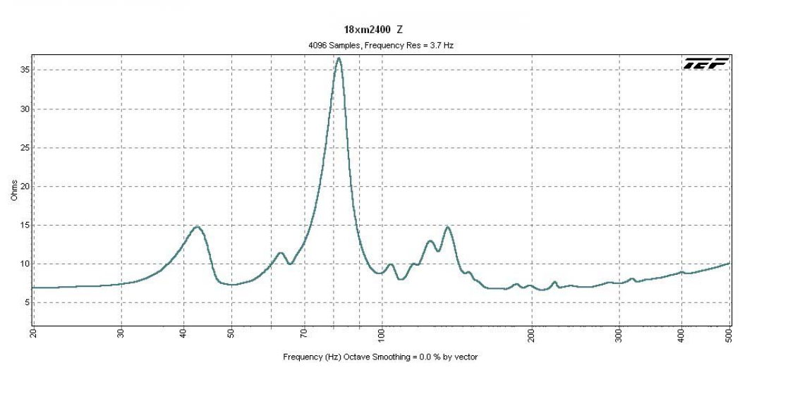

I when you have a bass reflex speaker, the lowest point between the 2 impendence peaks, is the tuning frequency of the cabinet, and also the point of minimum excursion.
On a bass horn, how would we determine the points of minimum / maximum excursion, or tuning ?
I attached a random impendence curve from a bass horn, maybe we could use this as a example to teach me? is the low peak, the low limit? and then there are 2 sort of resonance peaks above that ?

Not an expert (but I did stay in a Holiday Inn Express once... a long time ago) - Excursion is directly affected by power and frequency. The lower the impedance, the more power will be delivered. The lower the frequency, the more the cone will travel.....so, I'd say the point of the most excursion is going to be the lowest impedance near the lowest frequency.
In that graph, I'd say that the most excursion is going to occur at 50hz and from 30 down.... That's the layman's explanation. I'm sure those more knowledgeable will tell me the capacitor is on the wrong side of the inductor.

You use a horn modeling software like HornResp to see excursion. The impedance peaks correspond with excursion peaks, but unlike a direct radiator there are many more of them.

So, ill have to learn to play with that molder, but for sake of argument, would this horn have more excursion at 42hz, then it does at 80ish hz?
and what about comparing 35hz to 42hz? 35hz is a impendence low point sort of, so would it have less excursion then the peak at 42?
I'm guessing the answer is to model it lol

I can't say, that impedance curve is out of the ordinary and suggests that it's not a pure horn. This is a T60 impedance chart:
