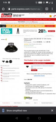

A few people have mentioned upgrading the sub from my old dvc ( can't remember the model # ) to this , which I now see is the recommendation on the bfm home page as well
https://www.parts-express.com/dayton-au ... m--295-469

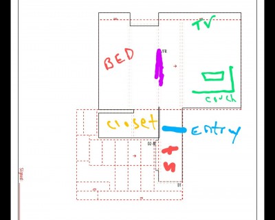

If a new driver or amp will increase performance, I'm all for it. Like I said. I was looking at putting one, possibly 2 vtf3 mk5's in the basement. The basement bedroom/gameroom is only 2200 cubic feet , in large part due to the ceiling height that's around 6'8"
Room layout is linked.

The amp seems OK, other than not having DSP. A driver with significantly longer xmax than what you have could go louder, but if you have the DVC385-88 it has as much xmax as you can use. As for the subs you mentioned, none come remotely close to the maximum SPL or very low THD of the THT.
Re: Updating driver and amp from my 10 year old THT

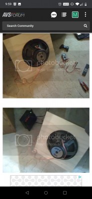

I believe that sub you linked might be it... The model # sounds familiar, but it's been 10 years lol. Now if that sub and amp ever go, what do you recommend I replace them with. Linked below is a shot of my sub before it went in...Bill Fitzmaurice wrote: ↑Mon Jan 11, 2021 10:48 am The amp seems OK, other than not having DSP. A driver with significantly longer xmax than what you have could go louder, but if you have the DVC385-88 it has as much xmax as you can use. As for the subs you mentioned, none come remotely close to the maximum SPL or very low THD of the THT.
