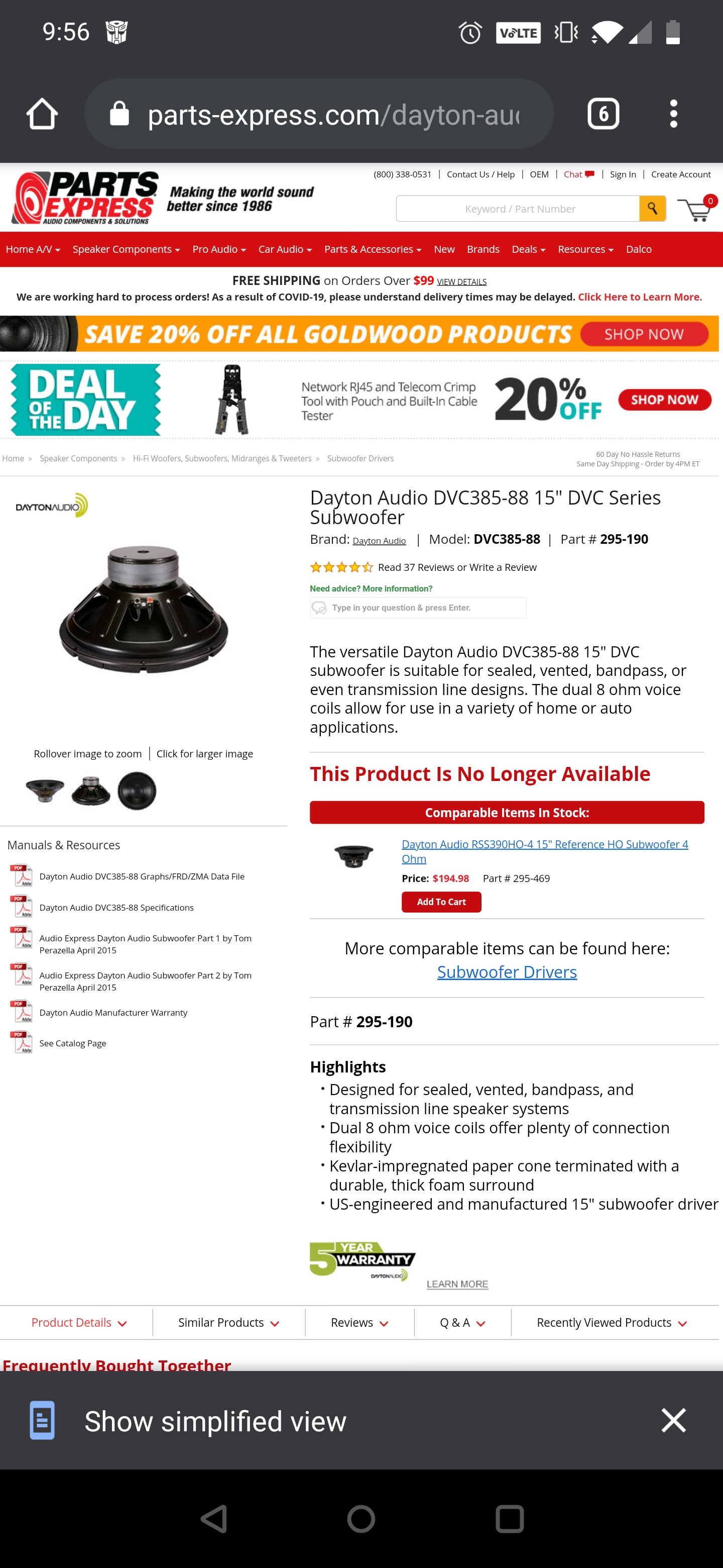

A few people have mentioned upgrading the sub from my old dvc ( can't remember the model # ) to this , which I now see is the recommendation on the bfm home page as well
https://www.parts-express.com/dayton-au ... m--295-469
This is the amp I used
https://www.parts-express.com/dayton-au ... r--300-804
But a few said maybe get something a lil beefier with a dsp to benefit the new ( higher capability ) sub..
So just wondering thoughts on everything , if it's worth the upgrade, or just leave the sub that's in there until she goes, or maybe just change the amp?

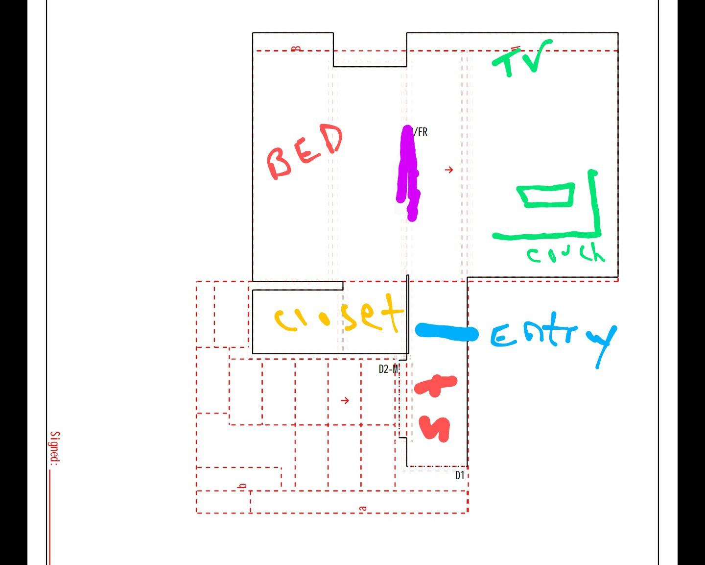

If a new driver or amp will increase performance, I'm all for it. Like I said. I was looking at putting one, possibly 2 vtf3 mk5's in the basement. The basement bedroom/gameroom is only 2200 cubic feet , in large part due to the ceiling height that's around 6'8"
Room layout is linked.

The amp seems OK, other than not having DSP. A driver with significantly longer xmax than what you have could go louder, but if you have the DVC385-88 it has as much xmax as you can use. As for the subs you mentioned, none come remotely close to the maximum SPL or very low THD of the THT.

Bill Fitzmaurice wrote: Mon Jan 11, 2021 10:48 am The amp seems OK, other than not having DSP. A driver with significantly longer xmax than what you have could go louder, but if you have the DVC385-88 it has as much xmax as you can use. As for the subs you mentioned, none come remotely close to the maximum SPL or very low THD of the THT.
I believe that sub you linked might be it... The model # sounds familiar, but it's been 10 years lol. Now if that sub and amp ever go, what do you recommend I replace them with. Linked below is a shot of my sub before it went in...
