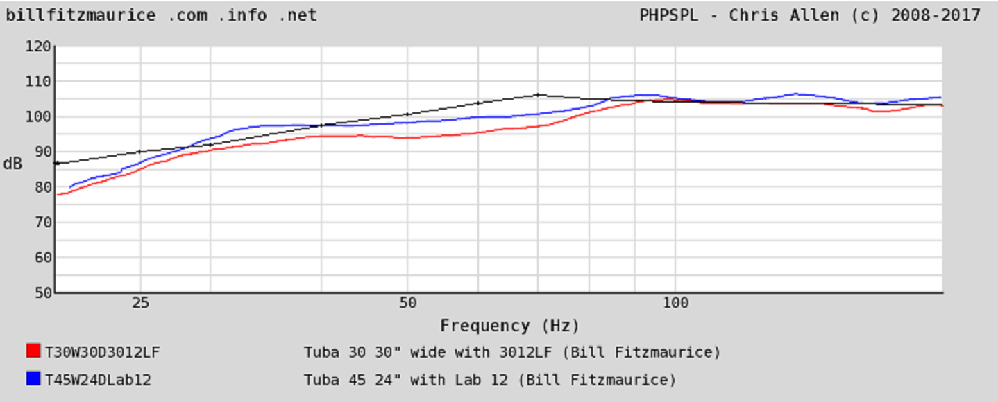

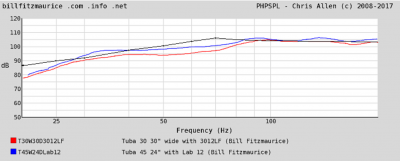

I drew in a rough plot of it over a 30" T30 and 24" T45. Keep in mind the T45 plot is a 6 ohm driver.

The difference between 8 and 6 ohm at 2.83 volts is .3 watts, 1 vs. 1.3. So, that power difference would account for about 1dB of the increased sensitivity of the T45 in that graph. The narrower T45 still shows a marginal premium in sensitivity over the wider T30. By my account, having unfolded the horns in Sketchup, the T45 has about 13" more horn length than the T30. Although, yes... the end fire design isn't naturally conducive to a v-plating configuration. As I understand it, v-plating adds sensitivity to the bottom end of the curve. But, I really don't know enough to say for sure or not. Bill will have to speak to that.

This gives a better indication of how a 2x12 T30/T45 compares to a PD186. The lower trace is the PD186. These are calculated response traces, which have deeper peaks and valleys than what you get in real life, but the comparison is valid.
