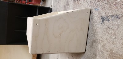

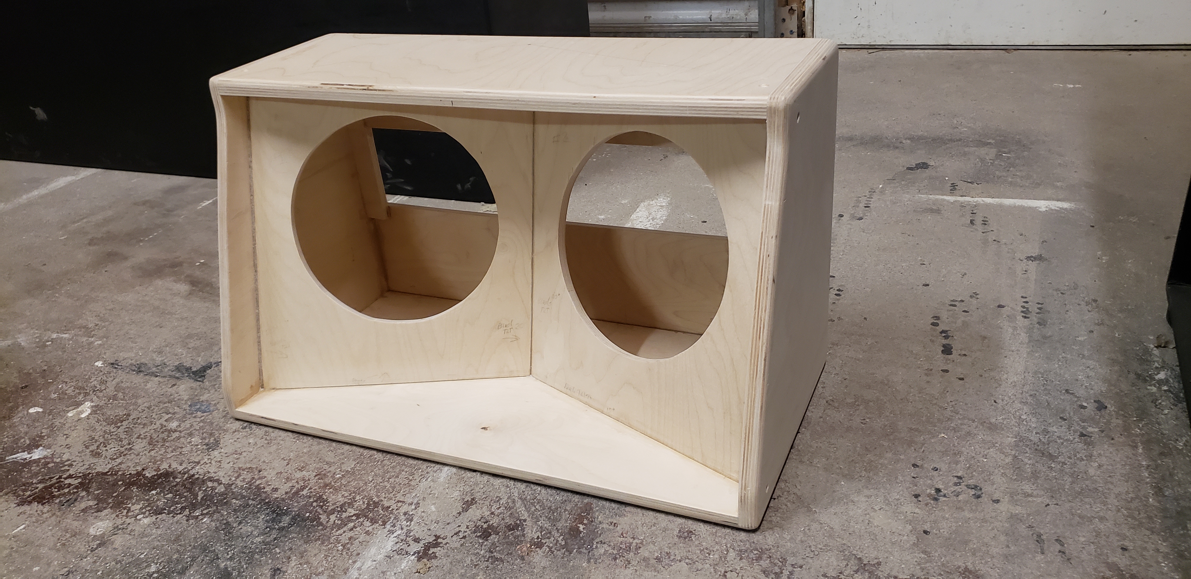

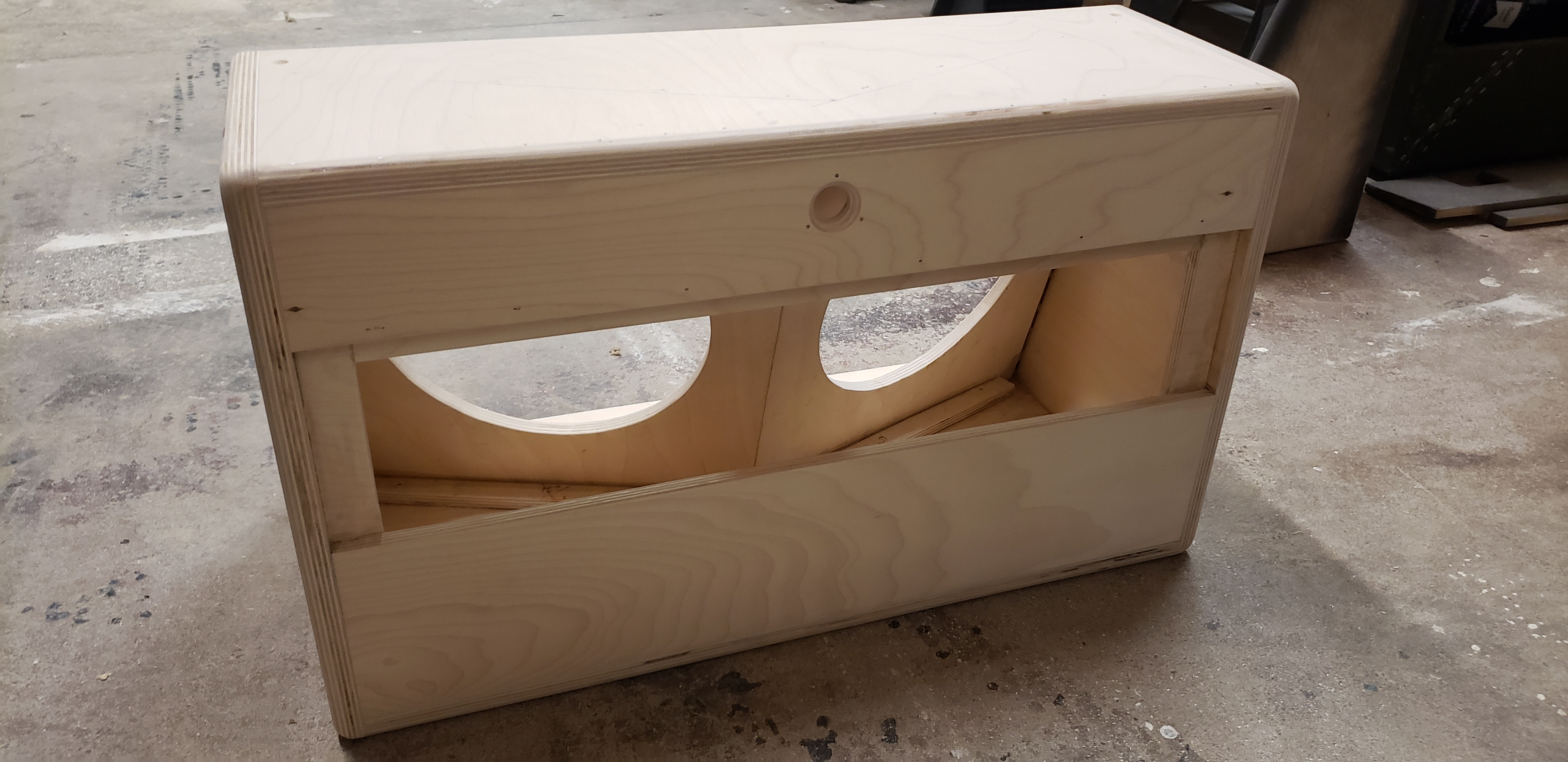

Here's an XF210 slightly modified to fit the fancy metal corners the client sent to me.
The corners assume they will be put on a square cabinet so the angled front face becomes a problem and the front corners wrap around to hook the inside of the frame.
The only thing I changed here is the outer frame of the xf is built using 3/4" and the front angle is adjusted to end at a 90° for the last inch or so at the top and bottom. (Look at the side profile)

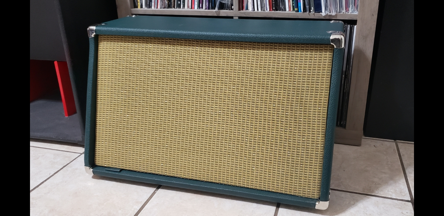

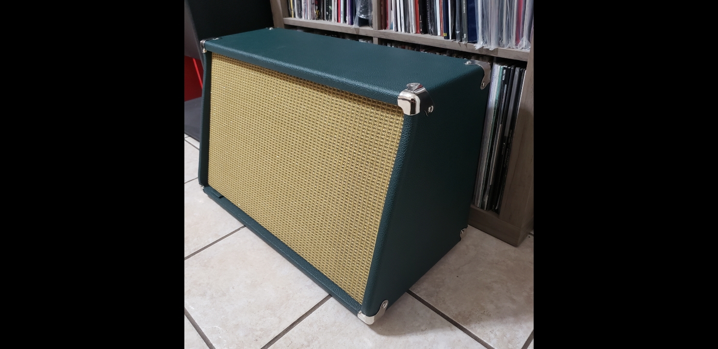

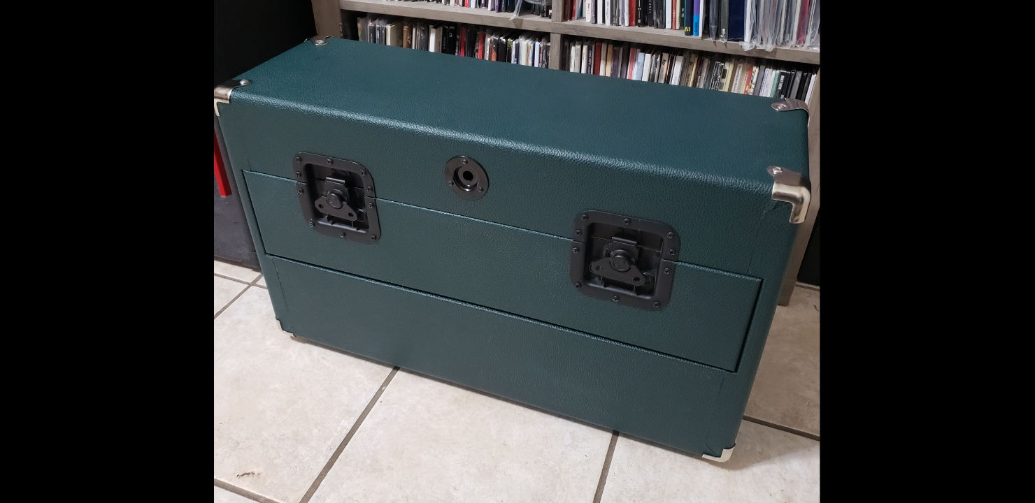

Nice! That is a good adaptation for the cab corners. Well done. :clap:
You did a real fine job on that cab!
