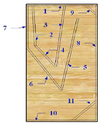

Fyrewyre wrote: Wed Nov 18, 2020 6:32 pm Hey everyone. I've just finished buttoning up my dual titan48 and I'm having anxiety about the joint seals along the horn path. Is there any way to mend this hypothetical problem should it arise?
Hey... Welcome to the forum! Congratulations on closing in on the completion of your project.
I can relate to the anxiety, had a bit of that when I finished up my T39... and ended up having a leak. The fix was worse in my mind than it was in reality.
Any leaks that are in a place that would really matter are accessible. Really, the only place you don't have access to is panel 5, and I don't think a small leak there would be detrimental enough to notice. All the other joints can be easily accessed through the driver chamber, horn mouth, or on the outside of the cabinet. If you really had to get to panel 5, you could just cut an access hole in panel 8 then fill/patch/blend the access hole back in and you'd never know there was a hole there.
Take a deep breath. All will be fine. If you find a leak, just fill it with some PL.

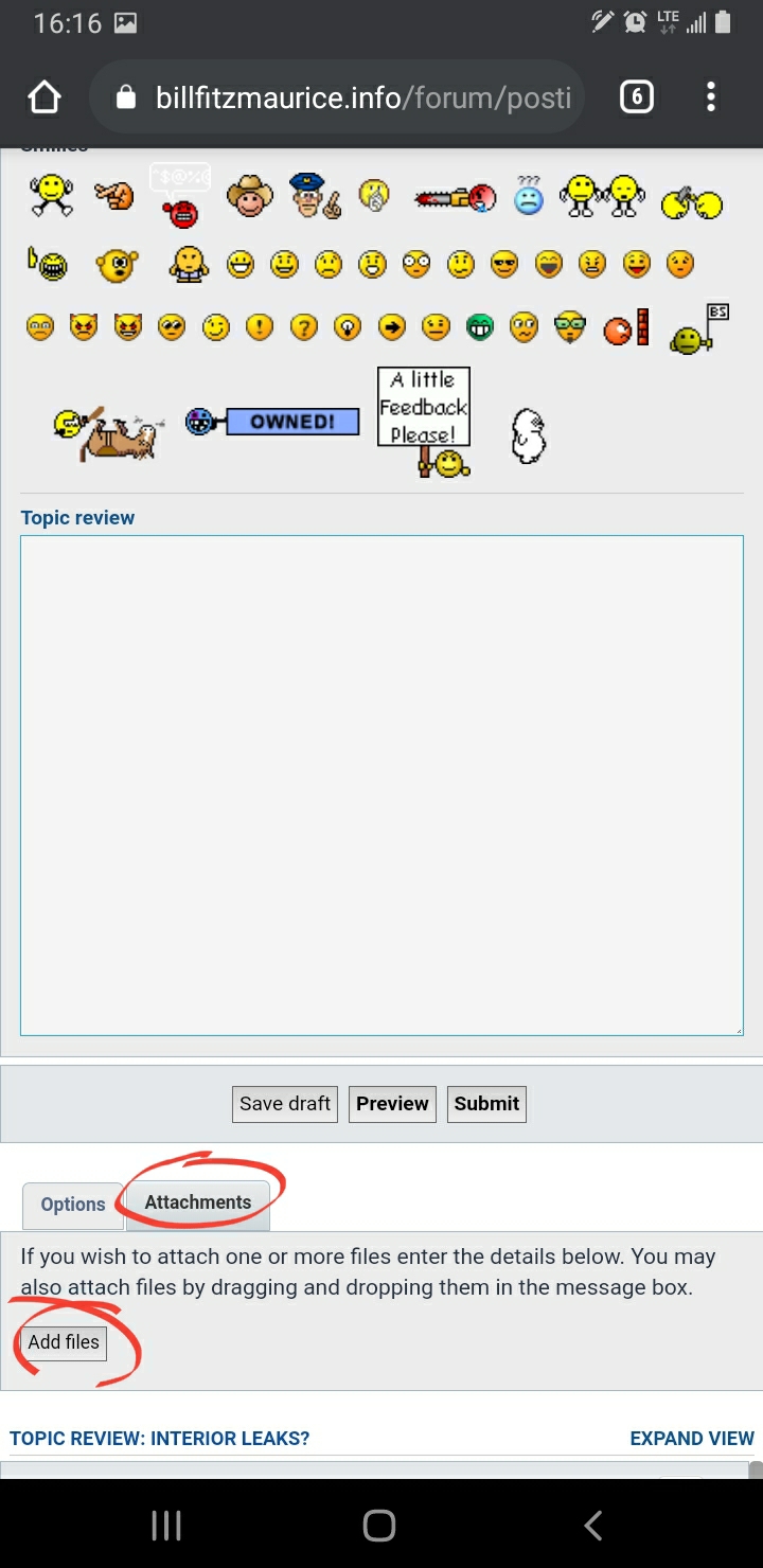

On your phone, you have to use the "Full editor and Preview"
Then scroll down and hit "Attachments" then you can "Add Files"
