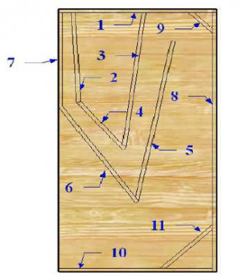

Any leaks that are in a place that would really matter are accessible. Really, the only place you don't have access to is panel 5, and I don't think a small leak there would be detrimental enough to notice. All the other joints can be easily accessed through the driver chamber, horn mouth, or on the outside of the cabinet. If you really had to get to panel 5, you could just cut an access hole in panel 8 then fill/patch/blend the access hole back in and you'd never know there was a hole there.

Take a deep breath. All will be fine. If you find a leak, just fill it with some PL.

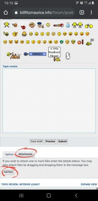

On your phone, you have to use the "Full editor and Preview"
Then scroll down and hit "Attachments" then you can "Add Files"
