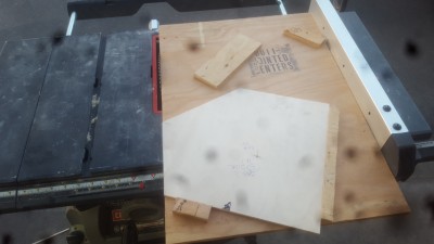

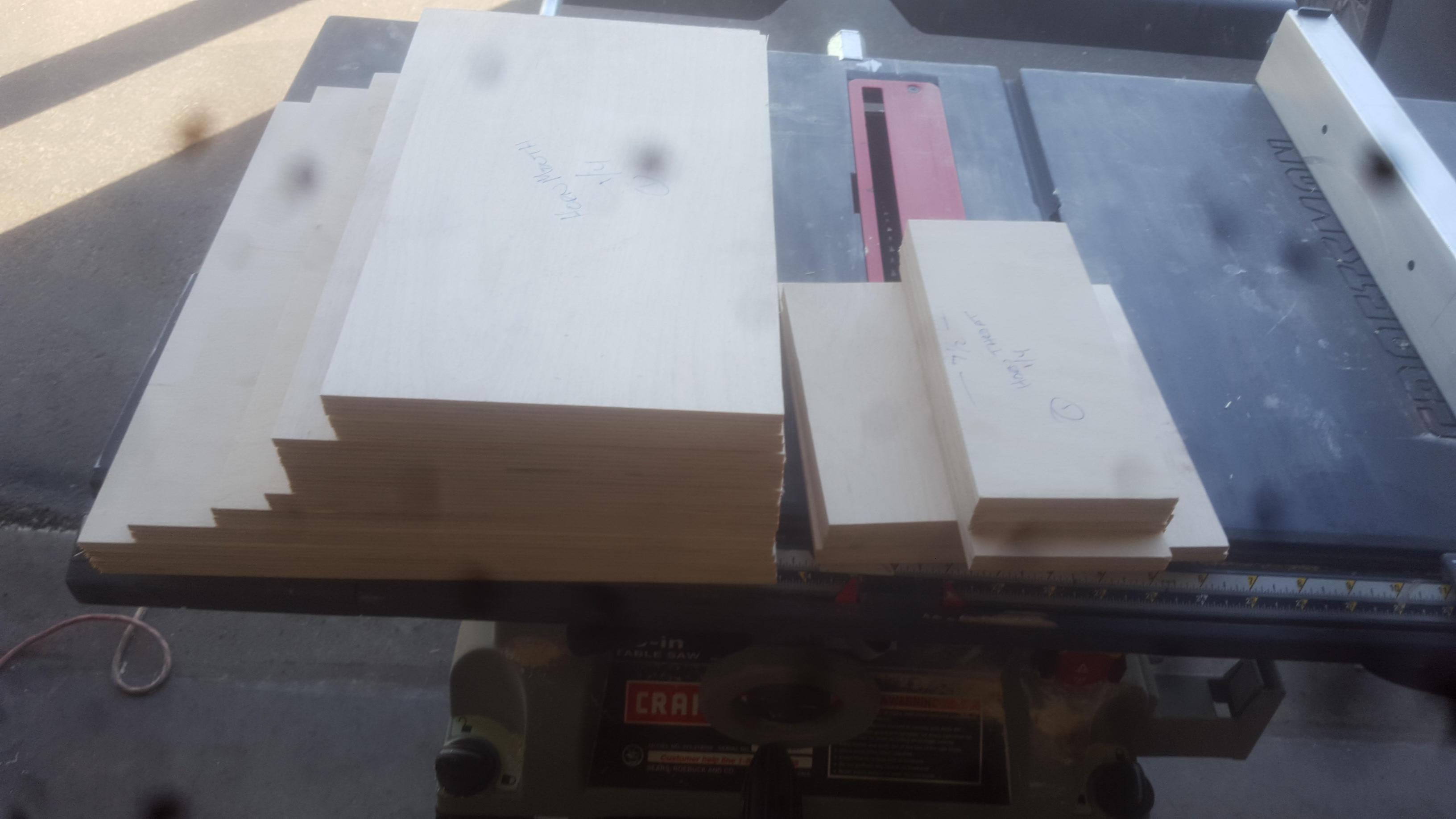

I got all the pieces precut to their rough cut dimensions. -
Got the sides cut out. -

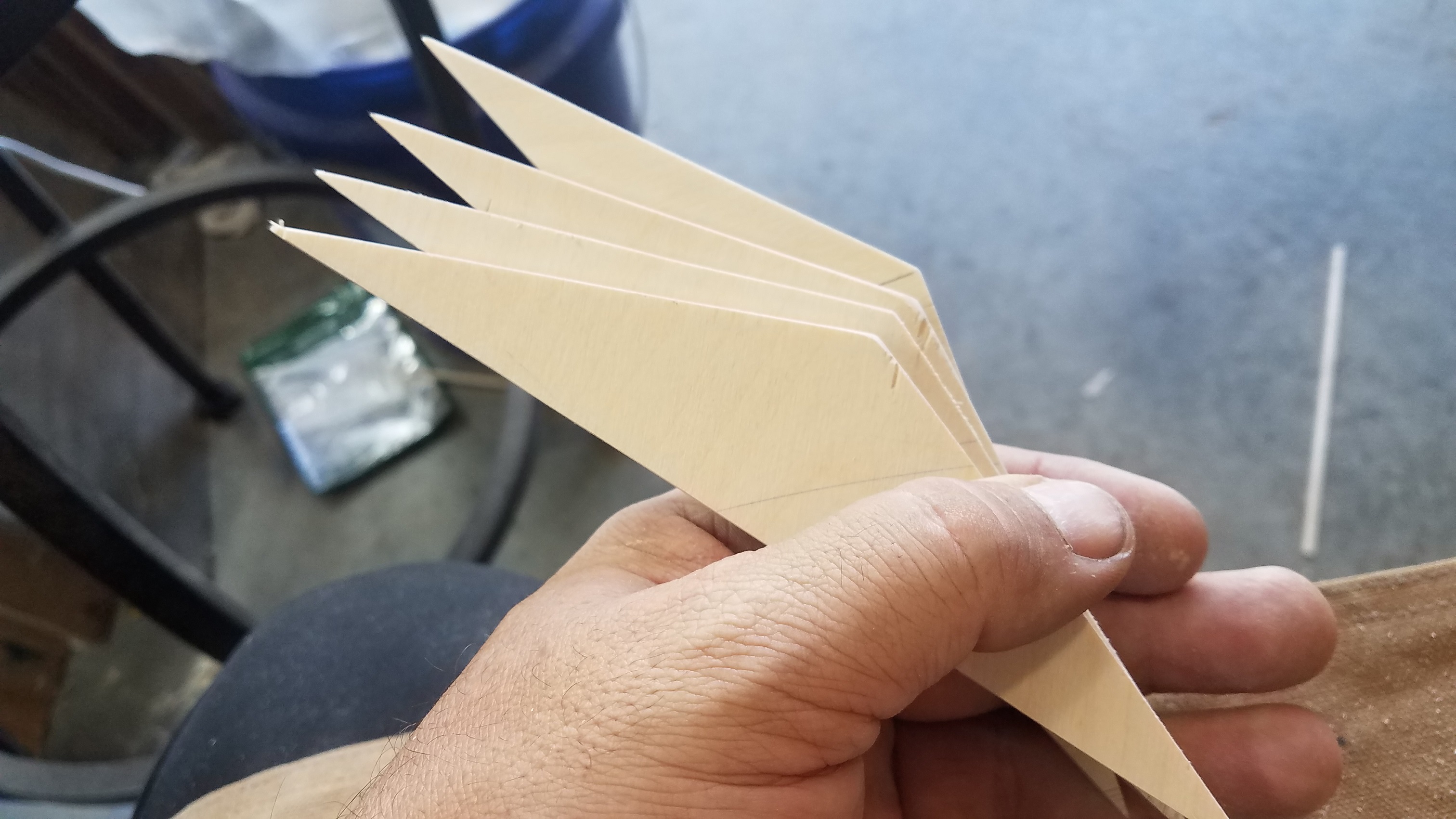

I also got the top and bottom cut to final size with their angled cuts (not shown). For the outside pieces, I just have the top back and bottom back left. Then I'll start on the horn pieces.

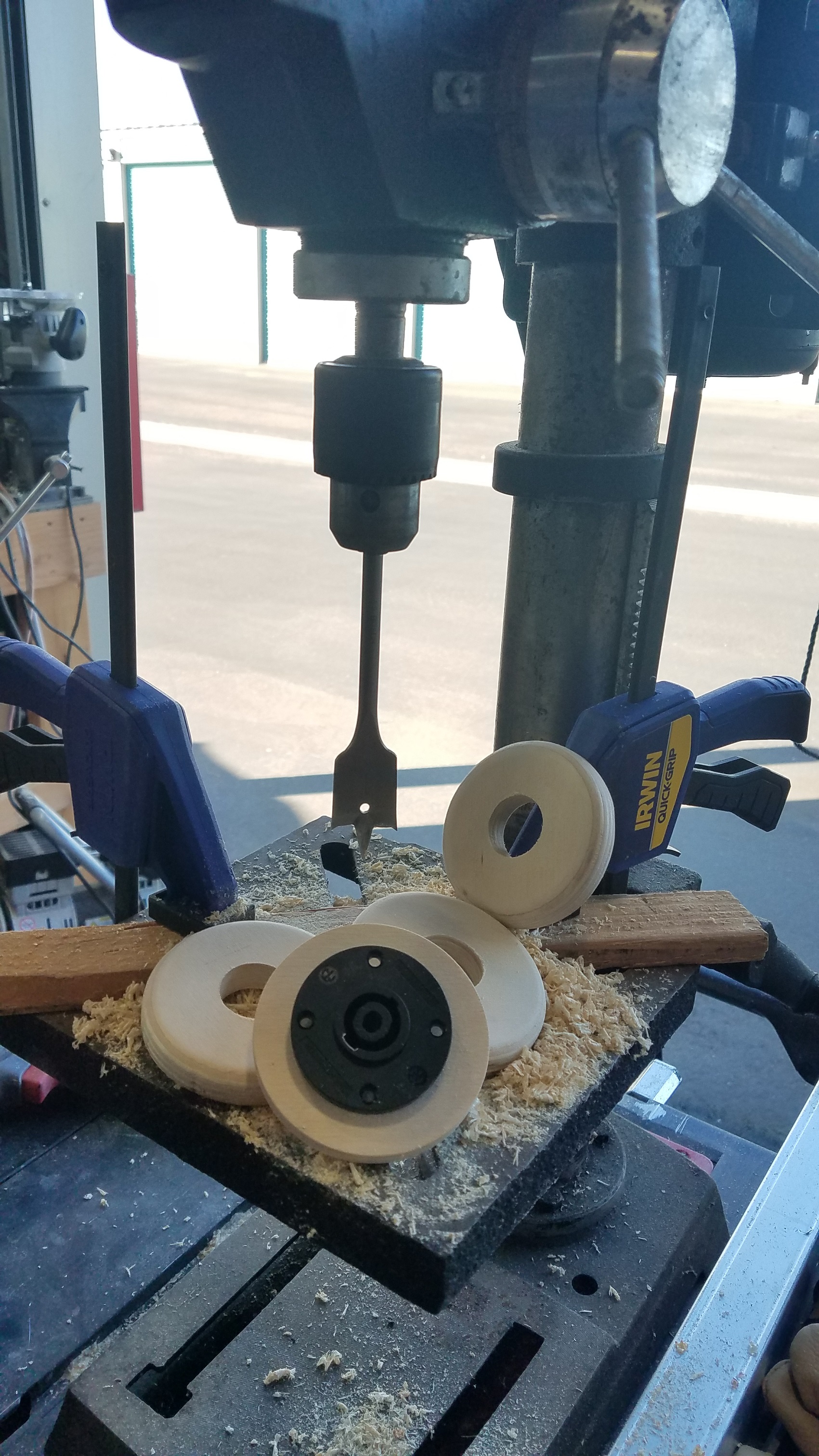

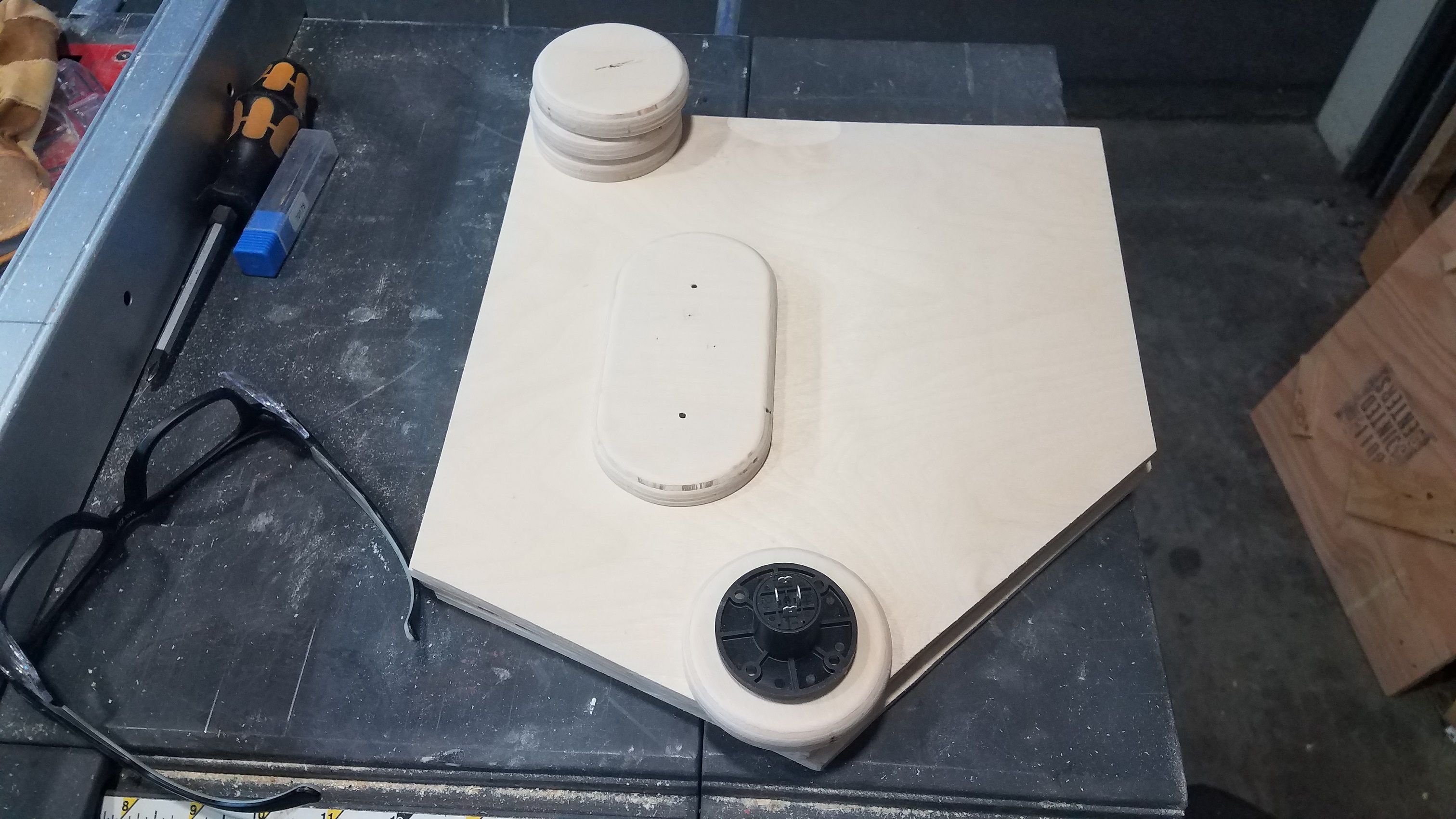

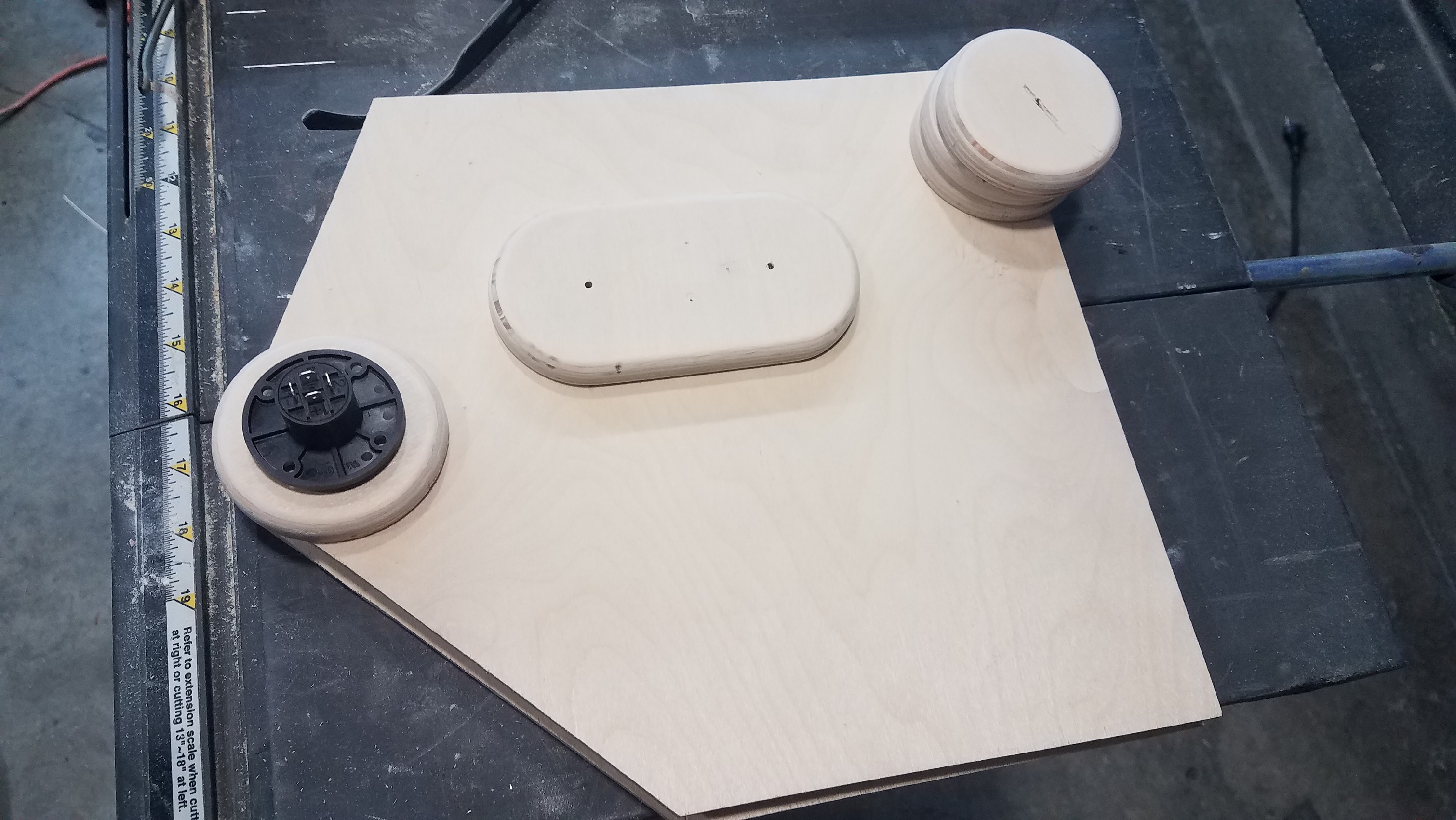

I decided I'd like to have the SpeakOn connectors screw in to a backing plate from the outside. The idea of gluing them in from the inside sounds like a great solution from a standpoint of simplicity and weight savings. But, I'd hate to have one get dropped or abused in some way that would dislodge the connector and push it in the cab. Wouldn't be the end of the world. But that's what my choice making thought process was.
So, I crafted four 3" x ½" backing discs. Router circle jig, rounded one side, and sanded smooth. I'll drill them out tomorrow.
I think I'm going to let the SpeakOn backing donuts overhang the edges, near the point between the upper and lower back as shown in the pics. Then flush cut them to add a little additional glue-able surface area to that spot for additional strength, just because... why not?

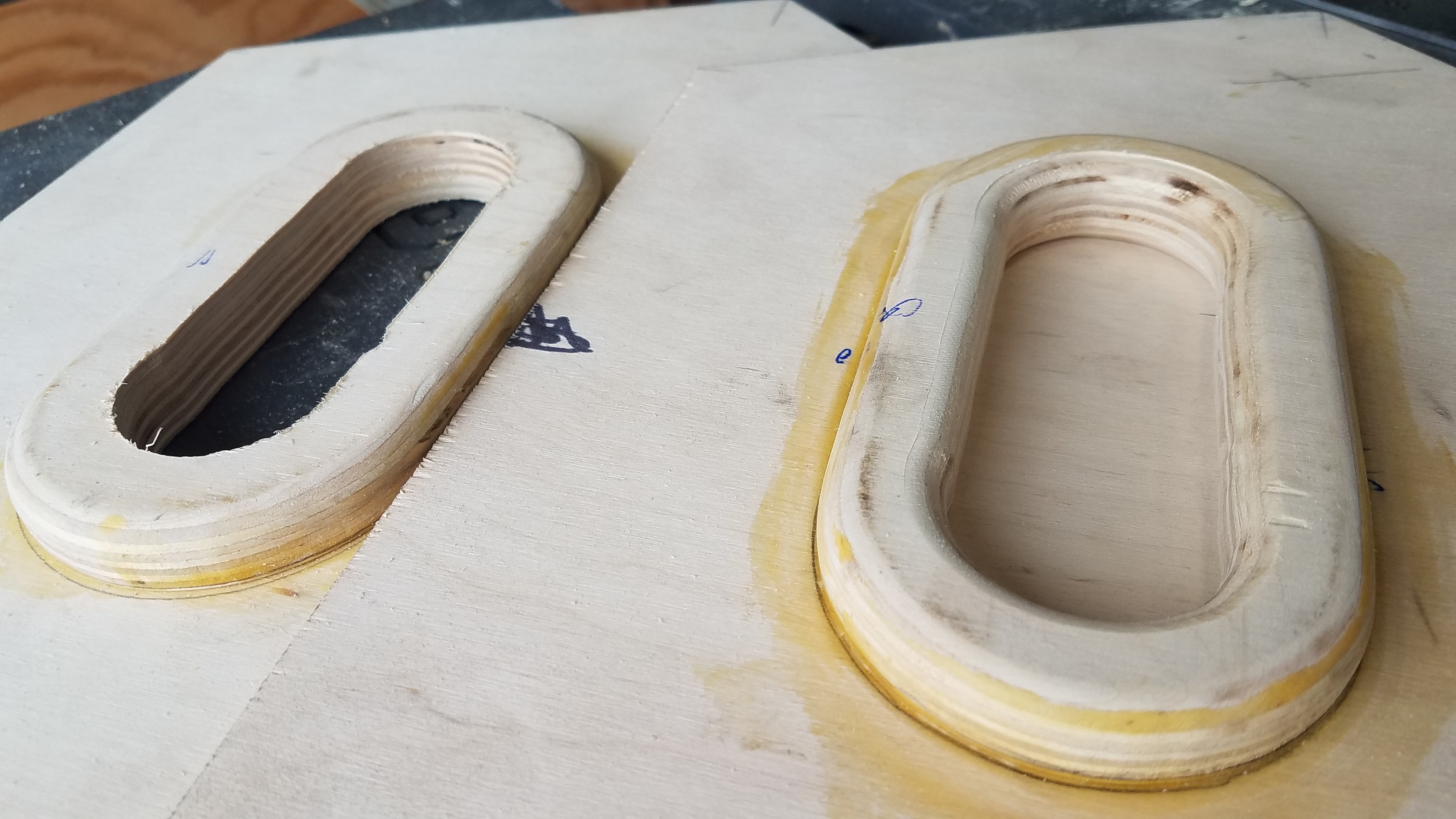

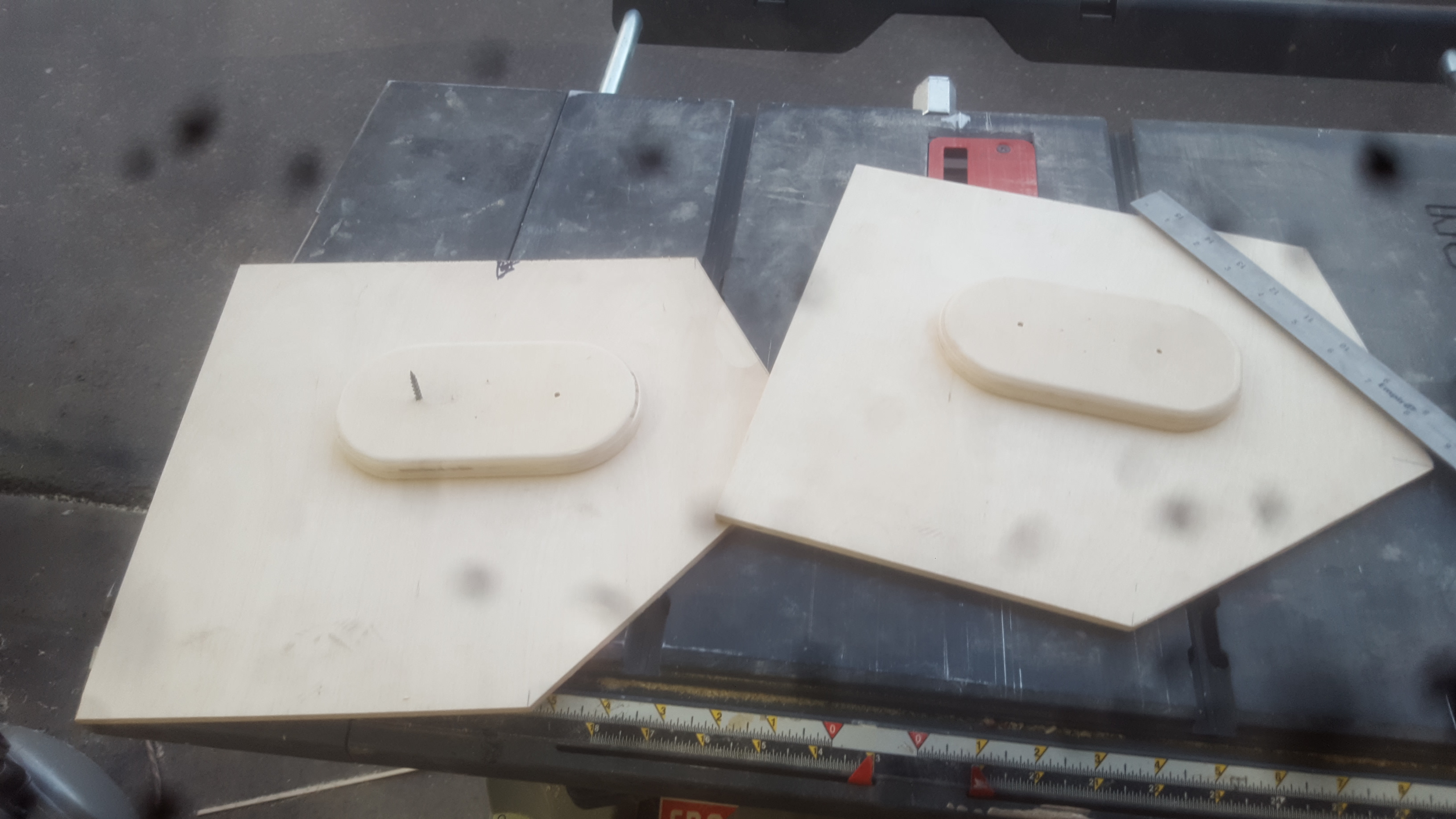

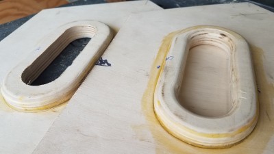

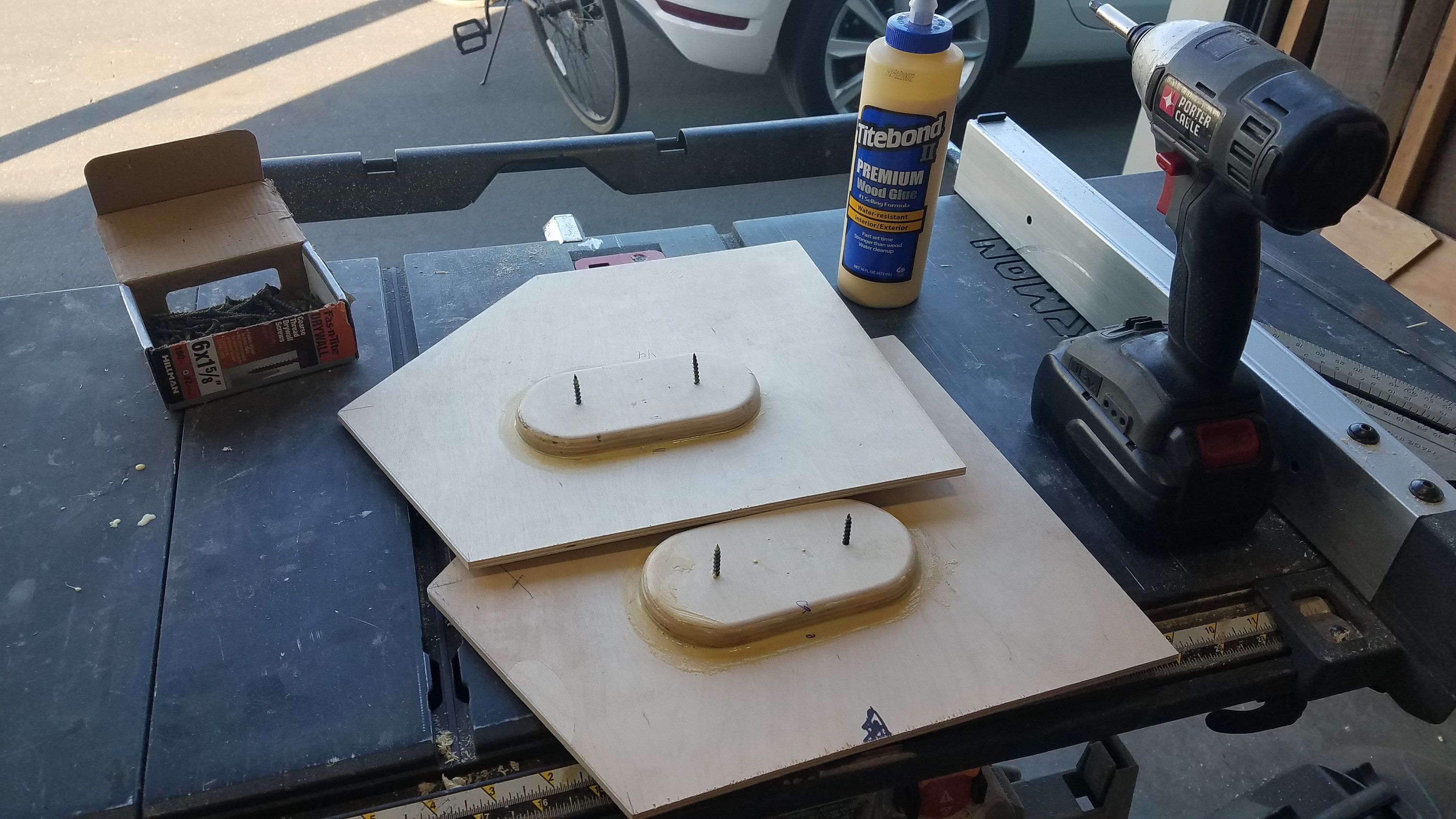

I went ahead and glued the port/hand hole backers on the sides. I'll drill them out tomorrow. I ended up relocating them 5/8" higher instead of 3/4", so the hole I already drilled at the height specified in the plans will be consumed in the drilling process. Where there would have been a little evidence of the previously drilled hole on the perimeter of the port with the 3/4" adjustment.

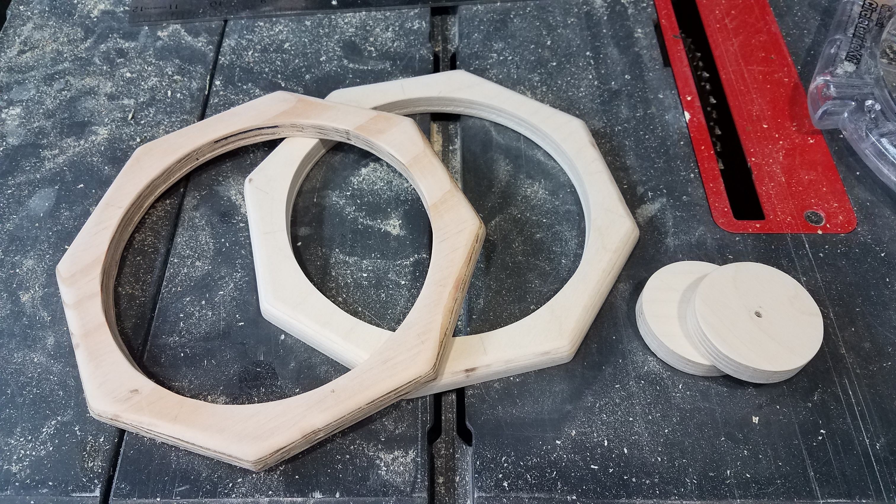

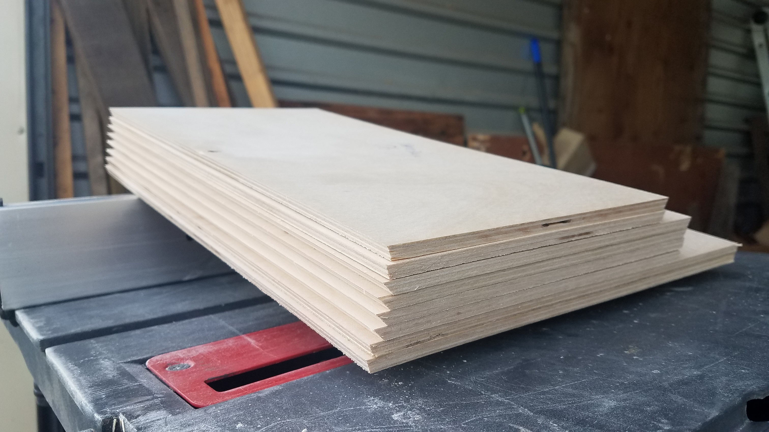

Made the bottom braces. I'm getting fairly good and creating accurate parts. Each one of these was pretty darn close to the same as the others. Not 100%, but close enough to impress myself a little.

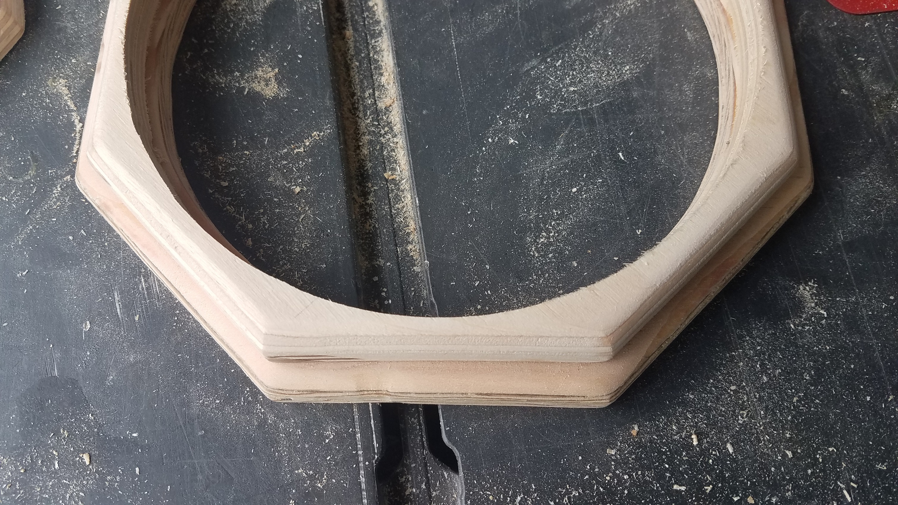

And right about here is where I found a mistake...The woofer spacers. I made 2 beautiful spacers. Symmetrical, sanded with nice soft rounded over edges... looked great and felt fantastic in the hand. Once the driver hole was cut, it was very obvious something was not quite right and I realized that I cut the part ½" too little in both dimensions, top to bottom and left to right. Looked through the plans to see if there was anything that might have given me the idea that the part was the size I made, but didn't see anything. I just plain made a mistake. Oh well. So, I got busy making two more with the correct dimensions. However, I didn't have enough ½" BB scrap to make both. So, one's out of BB and the other is 5 ply 15/32" Douglas Fir. It's really amazing how good parts look after a round-over and a little sanding. Got the phase plugs done too.
I was going to forego any mesh between the spacer and the baffle, but saw that plastic mesh for rain gutters was only $2 for a 6" x 20' role. So, I went ahead and ordered some of that today. I think it'll work okay for the purpose.

So, yesterday I was talking about wanting to glue the Speakon backer overhanging the edge of the side then flush cut it to match the contour. I was getting ready to glue them on, when it dawned on me (I'd been reading the plans last night) that the top, back, and bottom panels are mounted in-between the sides, not on the outside of the sides. If I mounted the SpeakOn backer now, it would interfere with assembly later. Dodged that bullet. Would have been able to work around it, but glad I won't have to. So, I put the backers aside for now. I did drill out the centers of them though.

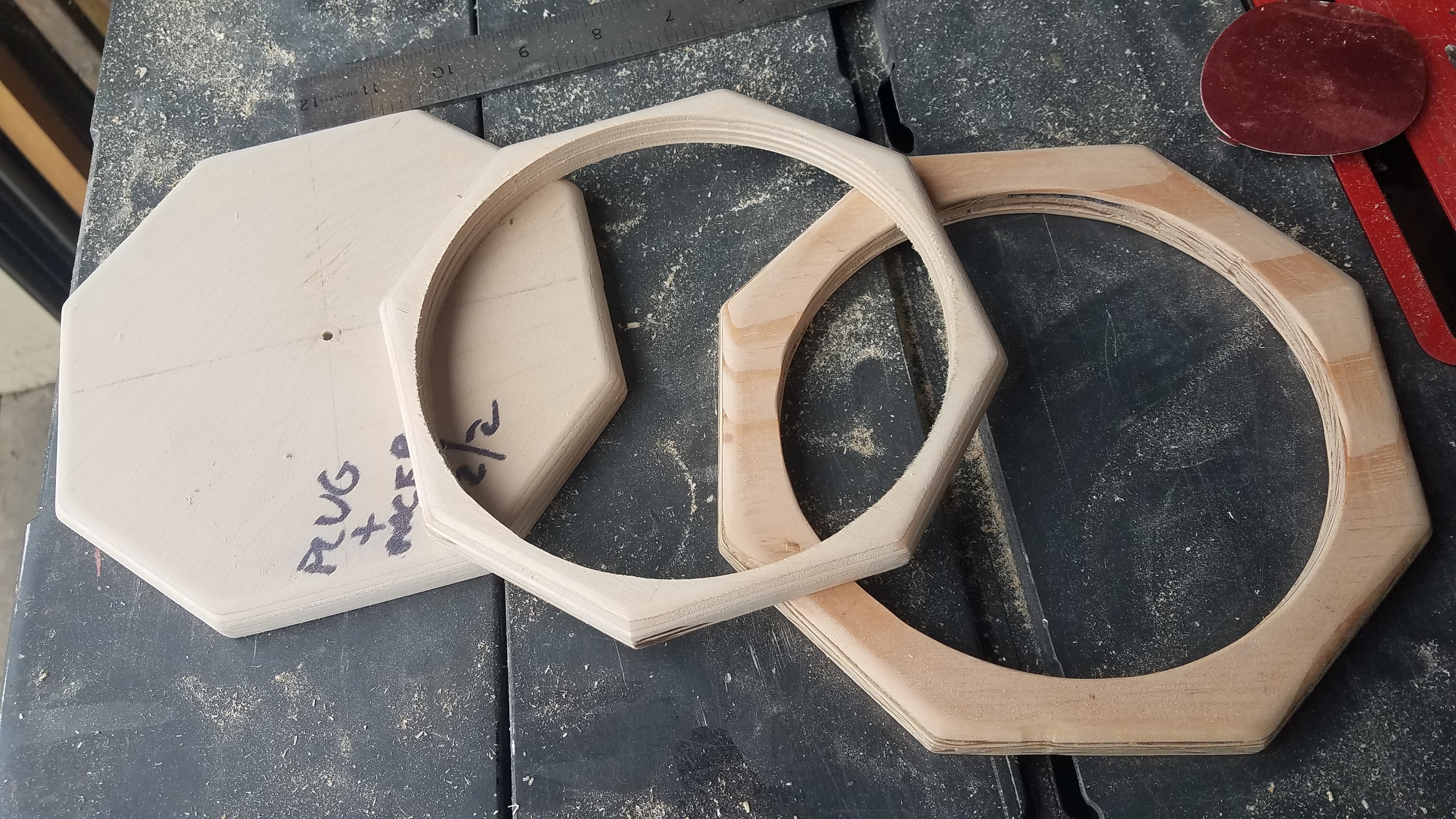

I should have stated in the beginning of this thread that this will be a "how I did it" documentation of my build. In no way should this be considered a "how-to" kinda thing. If anything, it's probably a better "how-not-to" thread.
Here's the mistakes from yesterday (on the left and center) in contrast to the part with the correct dimensions (on the right)
Bottom good, top bad

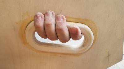

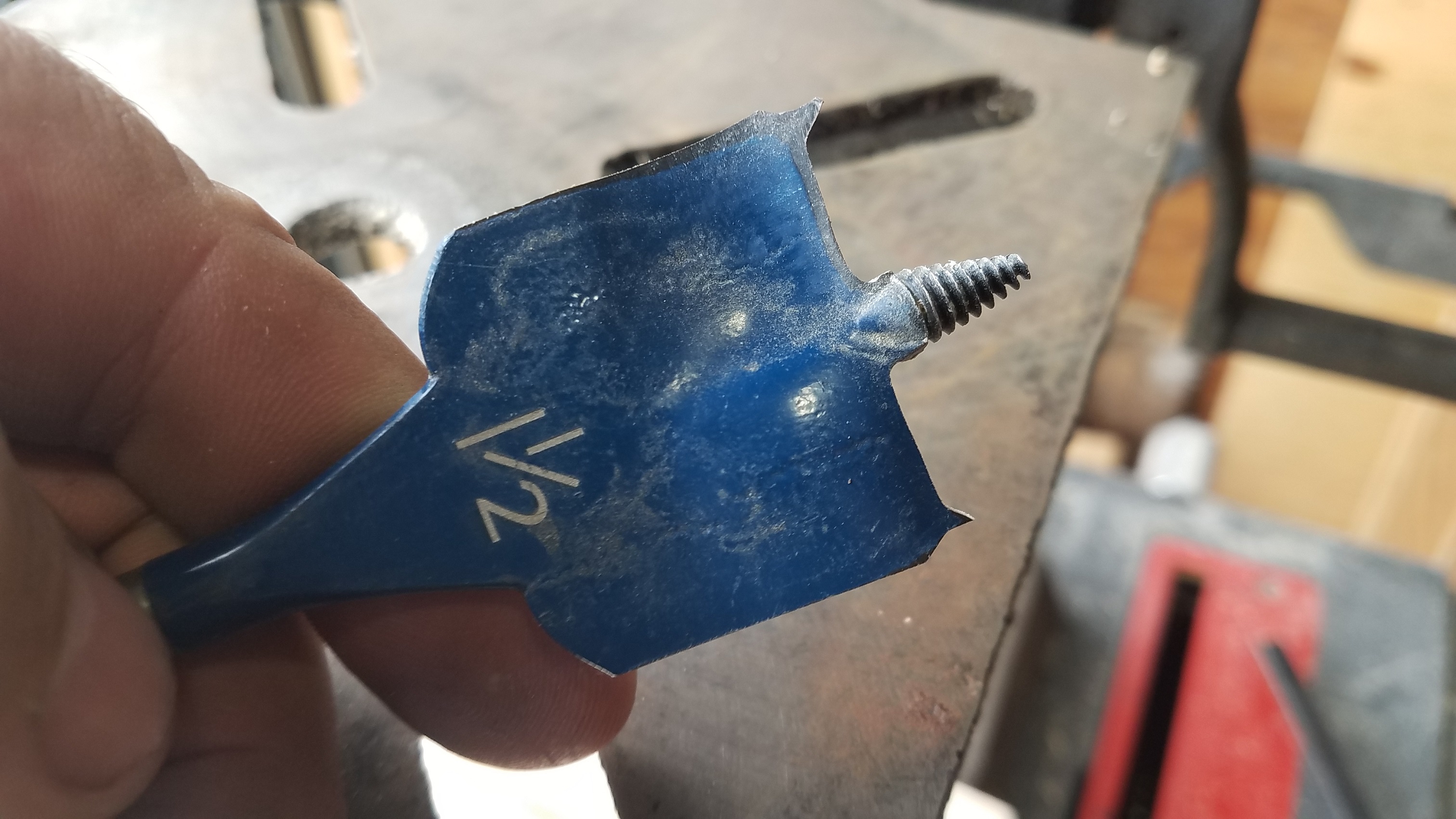

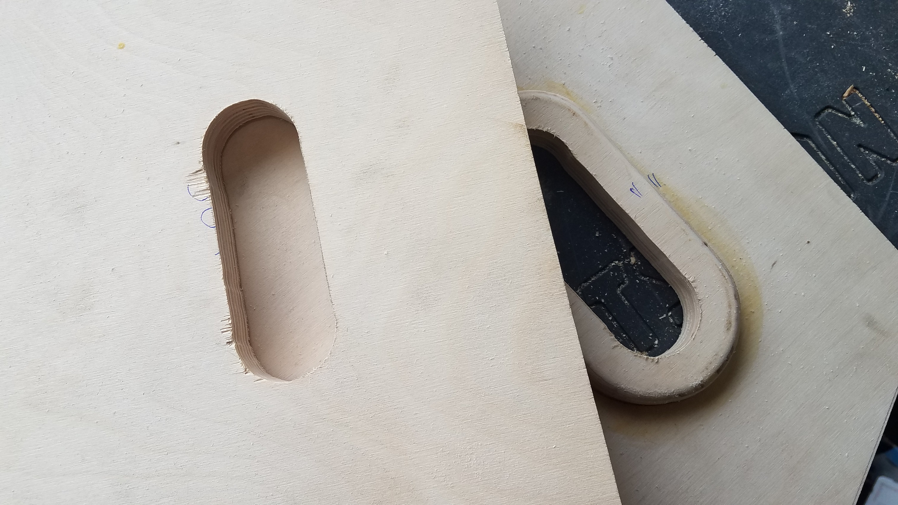

I wasted at least a good hour of time, thought, and resources today. I thought I'd be real slick and make a simple sled for the jigsaw. If the thought ever crosses your mind, let it pass. Big fail. The blade doesn't stay straight/perpendicular and pretty much goes wherever it wants. I gave up on it and decided to make the hand hole cuts freehand. Took about 2 minutes and was a completely acceptable result. It wasn't until I was sanding the port/hand hole that it dawned on me, I could have clamped a straight edge on and just used a flush cut bit in the router for perfect results. Oh well. Next time. Ya know, having the tools is one thing. Knowing how and when to use the tools to achieve the result you're after is a completely different thing. Apparently, I'm not there yet. But, I learned something, so I'll consider it a win anyway.
Side note: These screw tip paddle bits are probably great for something. But they're an absolute PITA for this kind of work. They grab and feed the bit way too fast. Even in a drill press with the work clamped down, it grabs and stalls the chuck. I had to drill the pilot holes out larger to finally get it to feed slow enough and work properly. When I bought it, I thought "eh, I'll go ahead and splurge and pay the extra $1 for the "better" bit". Another lesson learned. I'm really glad I didn't buy the whole set of these.

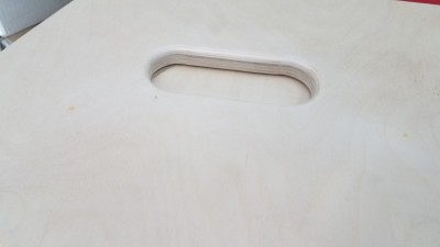

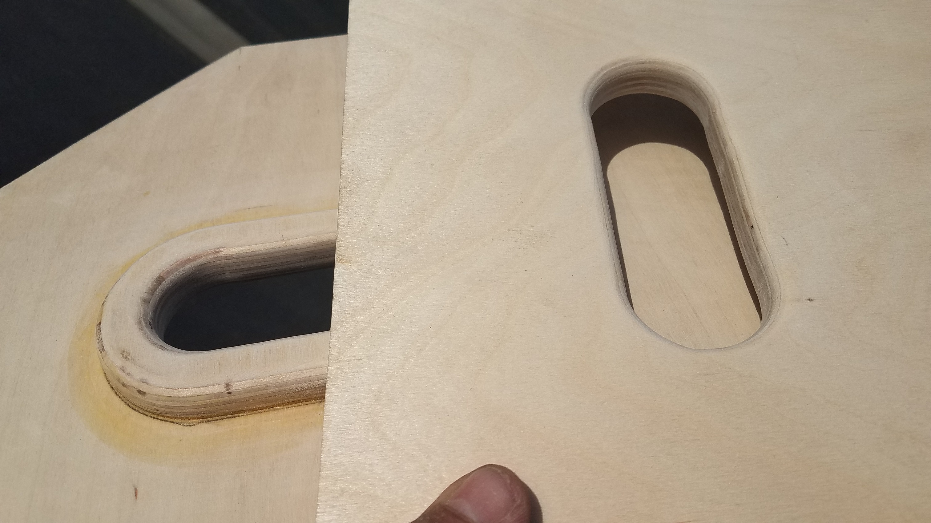

Holes drilled and centers cut out. Not perfect, but good enough. A little round-over and sanding will clean 'em right up..
The one on the right is rounded over
Both rounded over and sanded.
Ahhhh... Feels so good in the hand. Glad I took the time to do this part this way. Just feels like quality.
So beautiful.

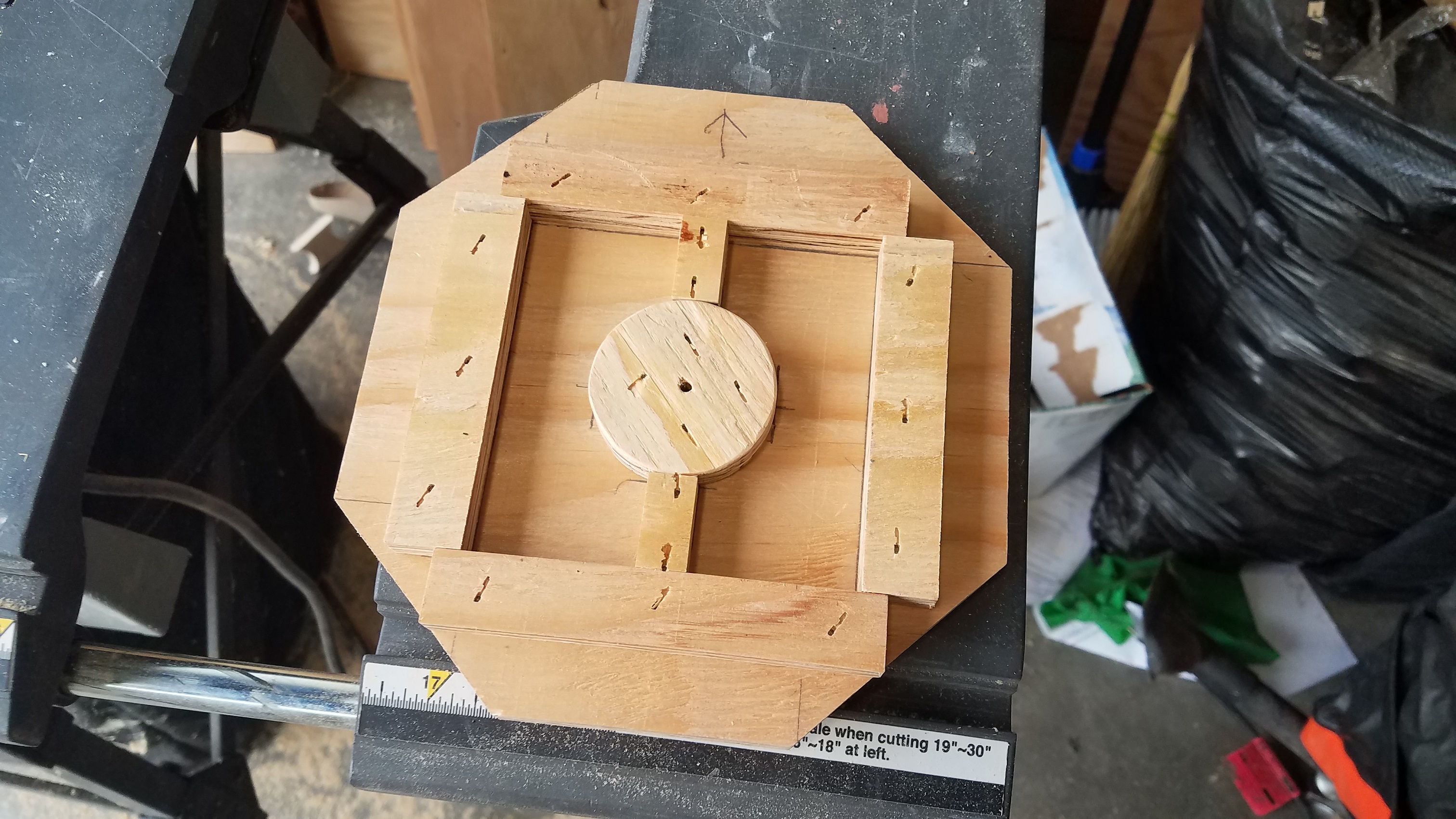

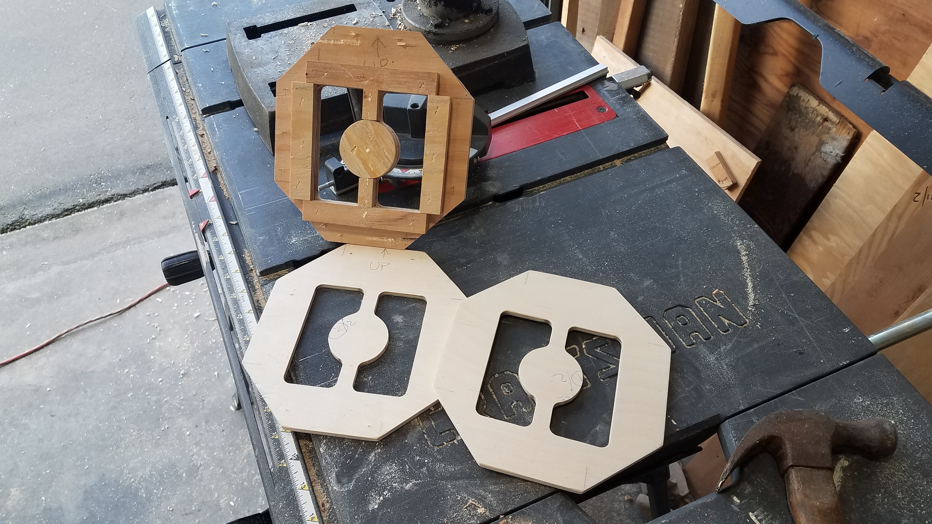

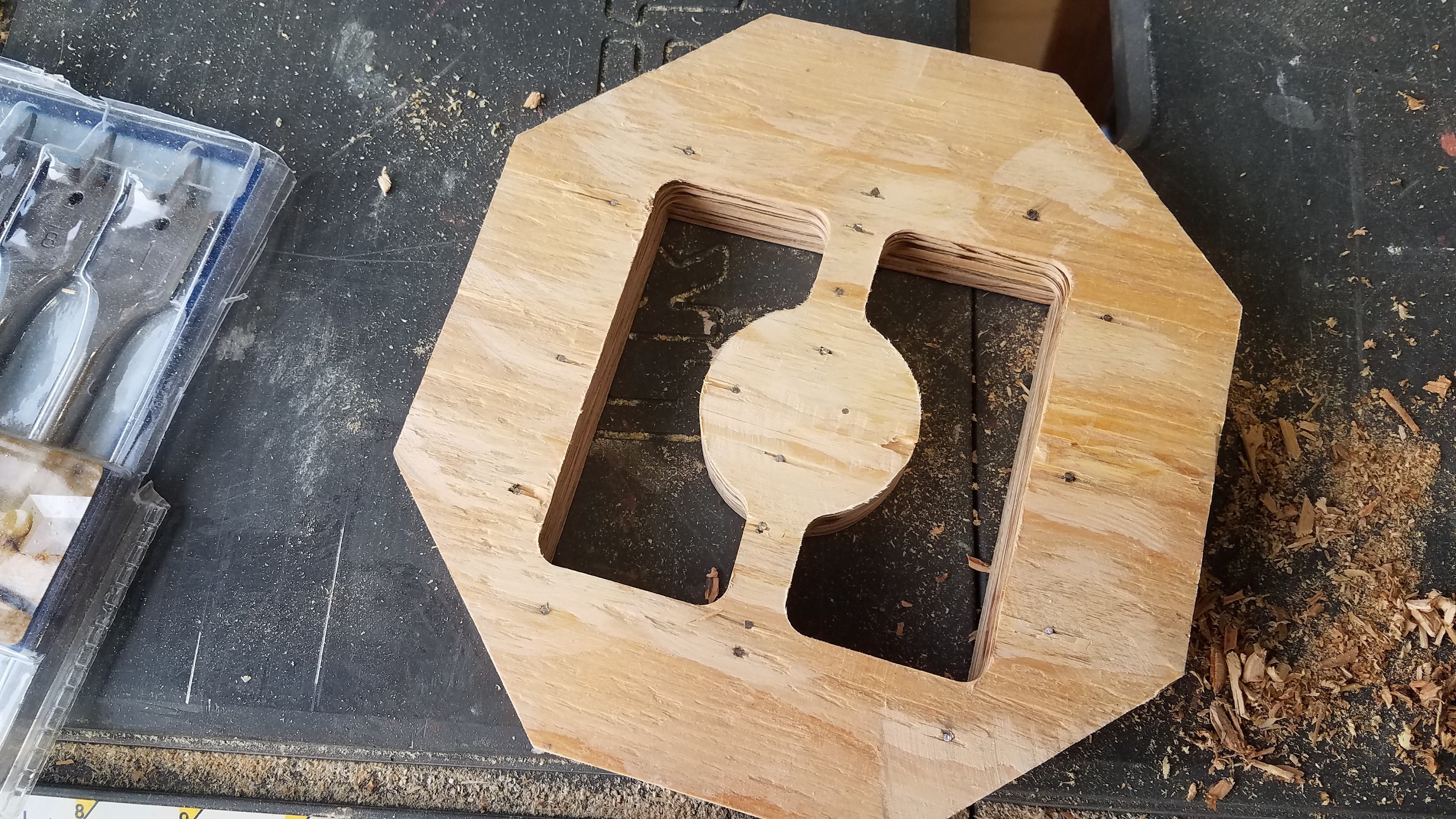

Doing the baffles with a template and flush-cut bit in the router was a huge WIN. Man-O-man, did these babies come out nice!

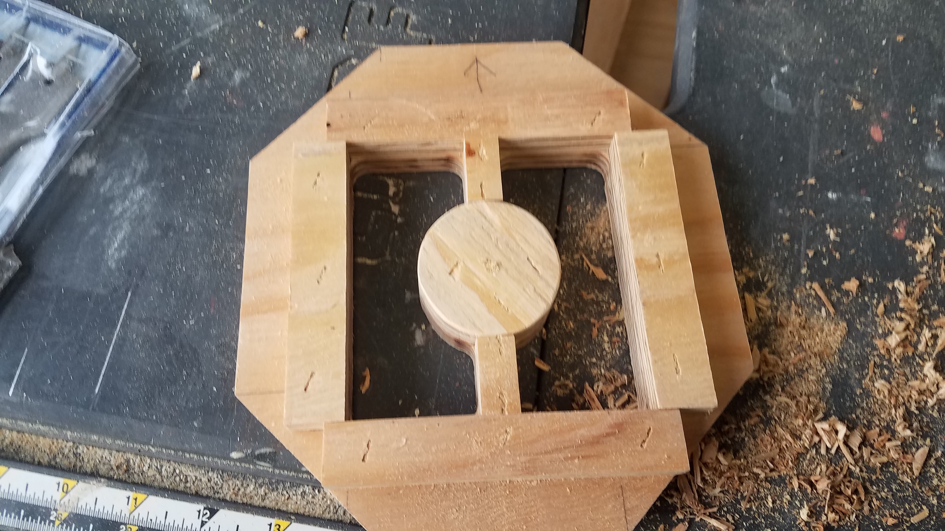

First I cut a scrap piece of ½" ply to the outer dimensions of the part, then cut ¾" wide strips to size and tacked them in place with 18g brads. The brads were a little long, so I used a grinder to knock them down flush where they stuck out through the back side.
Then I drilled a 5/8" hole in each area to be cut out for the flush-cut bit to stick through and went ahead and ran it around a couple times.
Here's the back side that got routed out. You can see the brads that got knocked down flush with the grinder.
Then I just lined up the blank part flush around the outer edges of the template, used the pin nailer to secure the two together, drill a couple holes, run the router around, and voila!!!
Look at these little gems! Sanded smooth, these things came out so professional! Nearly CNC quality. So happy with how well this method works. A big thanks to whoever it was that posted about doing it this way!
I'm going to label this template and keep it somewhere safe for the next pair I build. What a great tool.

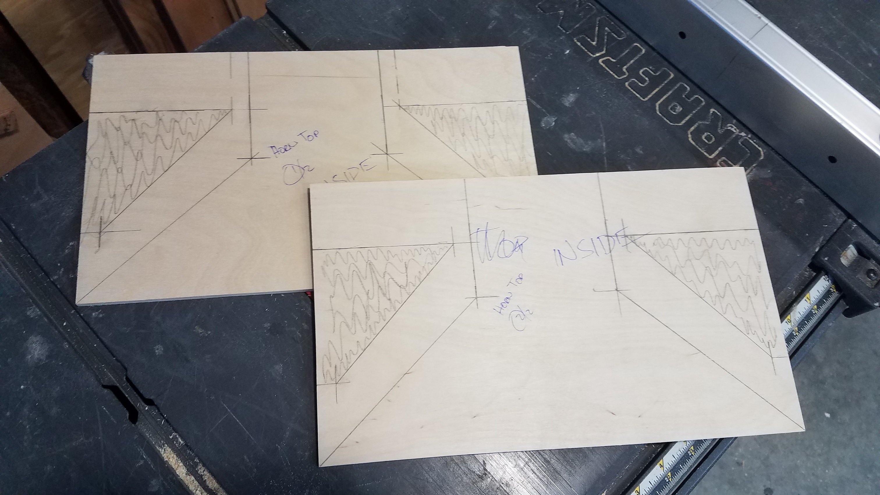

I got the horn tops and bottoms cut to size and the details sketched on the tops. Still need to sketch out the bottoms. I'm considering making some modifications to the dimensions of these in order to minimize some of the bulk that overhangs beyond the outside of the horn sides. I'm also thinking about cutting them out similar to the way I did the baffles, with a template and router. Still so impressed with the results of that method. Anyway, here's the horn tops sketched out (slightly different than the plans say)
