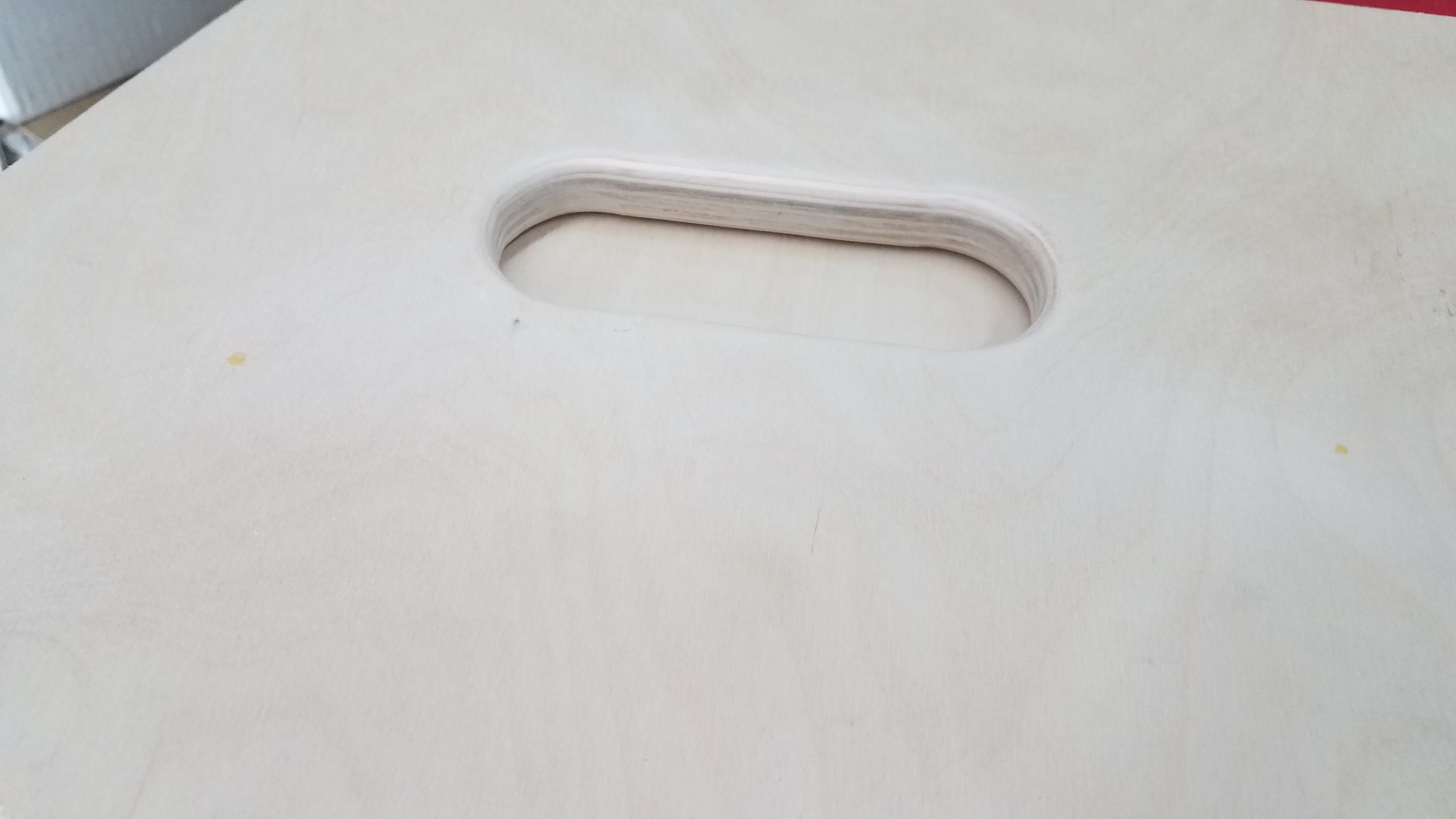

Here's what I'm going to do for the hand/port holes instead of half round stock. I added an inch around the handhole/port dimensions and cut it out of ½" BB, routed the outside lip on one face, and drilled the 2 center holes to locate it to the side. I only drilled one locating hole in the side and will use the hole in the backing to guide the 2nd locating hole so they're all lined up and perfect. Then I'll use a paddle bit and drill them together once they're glued together.
I held off on gluing them together. I want to check the SketchUp to make sure the modification won't interfere with anything else in the cab.

I cut a couple scraps of ½" ply into one ½" strip and one ¾" strip, rounded over the edges, and sanded them smooth to get a feel for what it may feel like when reaching in the port/hand hole. I know it probably seems like I'm putting too much thought and attention into this detail. And, I probably am. But, when I built my T39 I did one handle with a commercial solution and one handle at the other end per the plans, oval cut-out with quarter round behind. I liked the version in the plans waaaay better than the store bought solution. It just feels good in the hand. Like a solid, reliable piece that's built to last. I was very impressed at how well it came out. I'd like these to give that same feeling of quality and robustness.
Anyway, I decided to make the width of the port/hand hole backer ¾" all the way around the hole and modified the ones I made yesterday to the new dimensions. Which, I think will feel good in the hand being ¾" in 2 dimensions (the ¼" side backed with the ½" (x¾) comfort grip thingy). That sounds confusing, but I'm sure it will make sense when you see it in a couple days.
Also, I think I'm going to center the hand hole between the upper and lower rear horn supports, which will locate it ¾" above where the plans have it. This will make it less likely to have my hand touch the supports when handling them, which isn't a huge deal. Just my my mind tinkering with stuff and enjoying "making it my own" with little tweaks here and there.

I went ahead and glued the port/hand hole backers on the sides. I'll drill them out tomorrow. I ended up relocating them 5/8" higher instead of 3/4", so the hole I already drilled at the height specified in the plans will be consumed in the drilling process. Where there would have been a little evidence of the previously drilled hole on the perimeter of the port with the 3/4" adjustment.

I should have stated in the beginning of this thread that this will be a "how I did it" documentation of my build. In no way should this be considered a "how-to" kinda thing. If anything, it's probably a better "how-not-to" thread. :noob:
Here's the mistakes from yesterday (on the left and center) in contrast to the part with the correct dimensions (on the right)
Bottom good, top bad :chainsaw:
I wasted at least a good hour of time, thought, and resources today. I thought I'd be real slick and make a simple sled for the jigsaw. If the thought ever crosses your mind, let it pass. Big fail. The blade doesn't stay straight/perpendicular and pretty much goes wherever it wants. I gave up on it and decided to make the hand hole cuts freehand. Took about 2 minutes and was a completely acceptable result. It wasn't until I was sanding the port/hand hole that it dawned on me, I could have clamped a straight edge on and just used a flush cut bit in the router for perfect results. Oh well. Next time. Ya know, having the tools is one thing. Knowing how and when to use the tools to achieve the result you're after is a completely different thing. Apparently, I'm not there yet. But, I learned something, so I'll consider it a win anyway.
Side note: These screw tip paddle bits are probably great for something. But they're an absolute PITA for this kind of work. They grab and feed the bit way too fast. Even in a drill press with the work clamped down, it grabs and stalls the chuck. I had to drill the pilot holes out larger to finally get it to feed slow enough and work properly. When I bought it, I thought "eh, I'll go ahead and splurge and pay the extra $1 for the "better" bit". Another lesson learned. I'm really glad I didn't buy the whole set of these.
Holes drilled and centers cut out. Not perfect, but good enough. A little round-over and sanding will clean 'em right up..
The one on the right is rounded over
Both rounded over and sanded.
Ahhhh... Feels so good in the hand. Glad I took the time to do this part this way. Just feels like quality.

Thanks Tom. So far, I really like how well they came out. Doesn't feel overly big and bulky or too little (and however too little would occur). It's just the right size and feels like a manufactured part. Glad I gave it the attention and thought that I did. And doubly glad I took a look at the SketchUp. In the plans it mentions that the location of the port/hand hold is precise to avoid hitting internal parts. Best I can tell, it will fit fine, even with the slight position modification I chose to make. Hopefully I'm not eating my words in a week when it comes time to slide the horn into the outer shell :conf:
