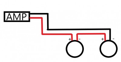

There's a couple ways to achieve your goal. This is probably the most reliable and non confusing way to do it.
Leave your subs wired the way they are and create a pigtail that externally wires them in series. With this arrangement you wont have to remember which sub is which. Just plug the pigtail into them, in any order, and they'll work as intended. If you wanted to do it internally, you'll have to keep track of which sub is wired which way and always hook them up in order... the series wired sub first and the normal wired sub second. And the series wired sub will not work unless the normal wired sub is also attached. So, if you do a gig that only requires a single, you have to make sure you bring the one that's not wired for series.

I take it the other channel of the amp is in use?
I would do a breakout box, rather than a pigtail. Seth's example is much prettier, see my version attached. The side with one plug is connected to the speakon from the amp. The side with two speakons has a standard speaker cable to each cab, using cabs wired in the standard fashion.

Ooh, I like that option too!
Re: rewiring from parallel to series
I should have explained it more I guess.
On the side with one speakon, +1 goes to +1 on the left of the 2 speakons side.
1- from that speakon goes to 1+ on the speakon on the right.
And 1- from that second speakon goes back to 1- of the single side speakon…

The Pigtail works but the box version will be much prettier to look at(even tho I used the box version as a wiring diagram
