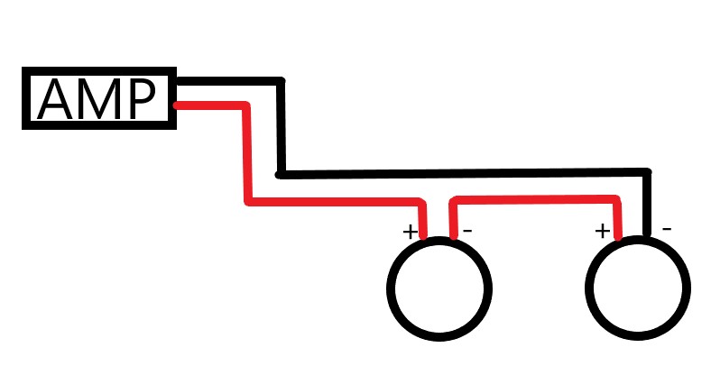

There's a couple ways to achieve your goal. This is probably the most reliable and non confusing way to do it.
Leave your subs wired the way they are and create a pigtail that externally wires them in series. With this arrangement you wont have to remember which sub is which. Just plug the pigtail into them, in any order, and they'll work as intended. If you wanted to do it internally, you'll have to keep track of which sub is wired which way and always hook them up in order... the series wired sub first and the normal wired sub second. And the series wired sub will not work unless the normal wired sub is also attached. So, if you do a gig that only requires a single, you have to make sure you bring the one that's not wired for series.

Excellent. Thanks for the replies.
I'll make a pigtail first to get up and running but I love the idea of the breakout box as it will be much more robust.

The Pigtail works but the box version will be much prettier to look at(even tho I used the box version as a wiring diagram :D )
