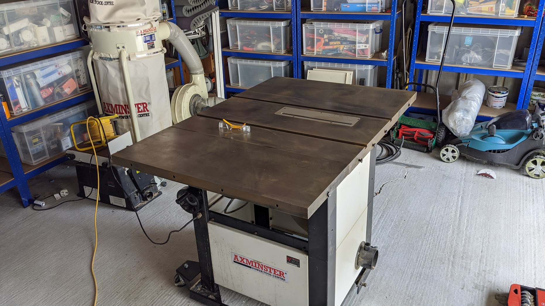

The first job was the table saw, not used in nearly 3 years and covered in rust, I sanded, cleaned and waxed it to something respectable.
Very pleased with myself, I did some maintenance to remove the saw dust and give it a good lubrication. The motor was being stubborn to start with but finally kicked into life.

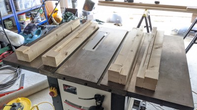

This new garage currently has no working surfaces, so a workbench was a top priority, having ordered some locking wheels, I measured the bench to be the height of my saw and made some legs.
Glued and screwed, the height looks good.

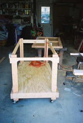

#3 Post by Bruce Weldy »

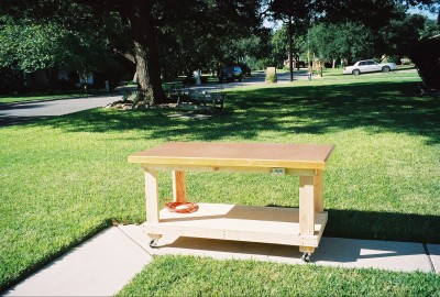

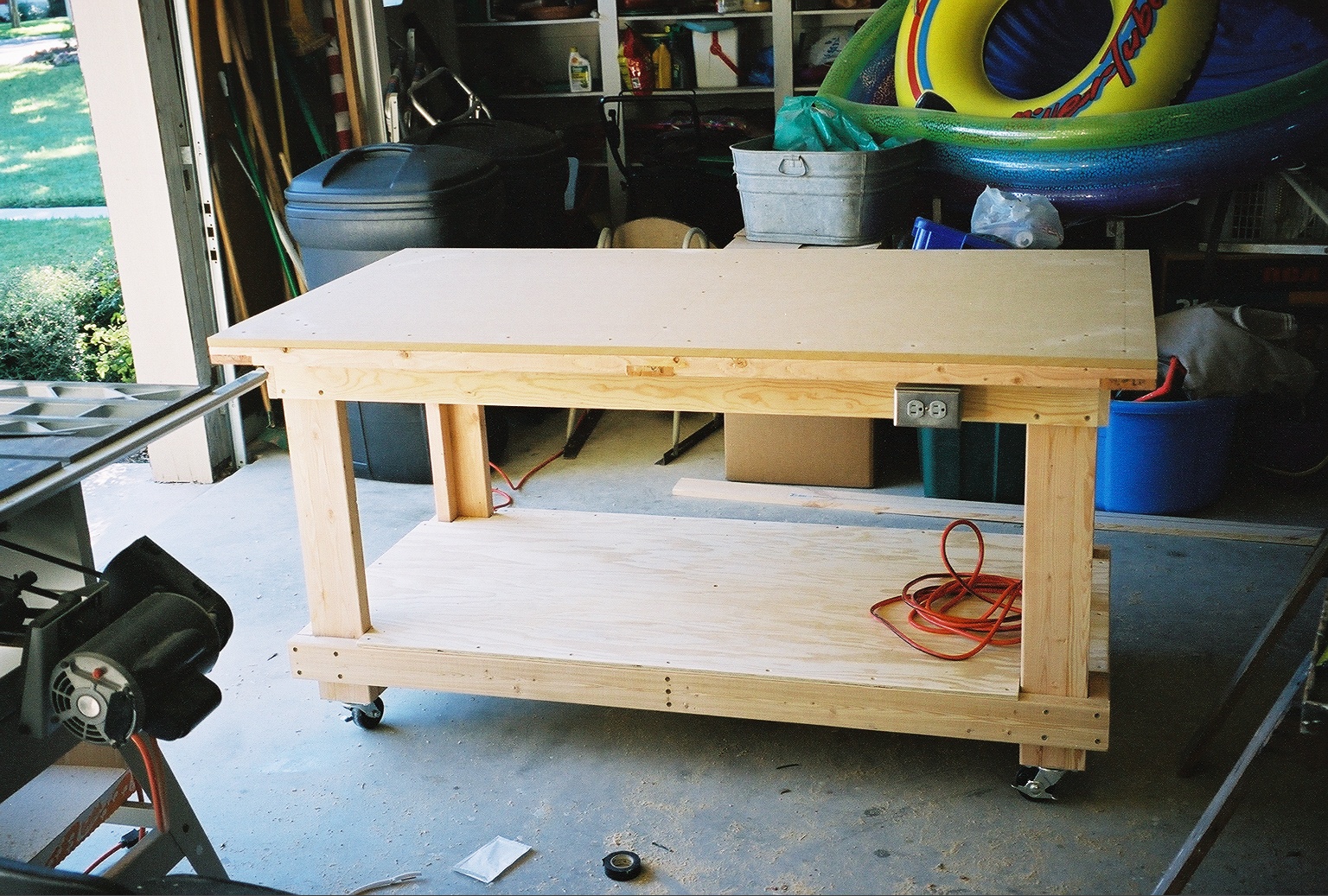

The legs on mine are built like that. Best project I ever did. I spend more time sitting at the bench soldering, building cabs, making cables, or just reading the paper......
I put power outlets on opposing corners - I highly recommend that.....

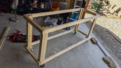

#5 Post by Chris_Allen »
Ok, time for a picture onslaught.

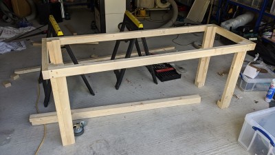

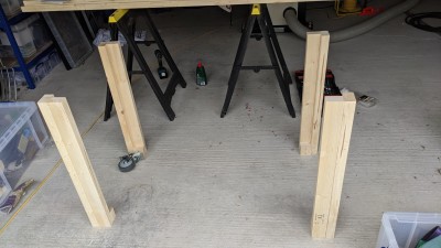

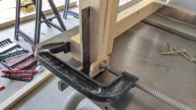

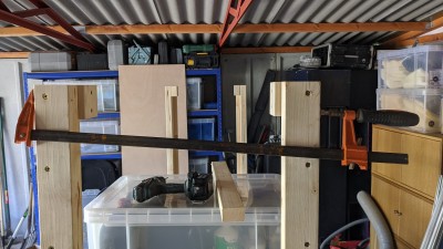

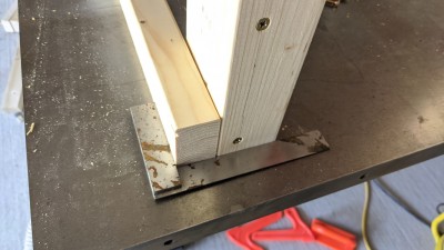

Got the legs on and it's looking ok:
Everything is nice and square:

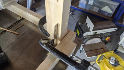

Except for the twisted crossbeam:
Which i decided to align the leg square the the beam and twist it back:
That was good enough to make the basic table:

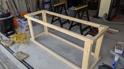

Add the bottoms:

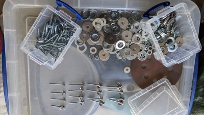

Fortunately, I had enough washers to attach the wheels:

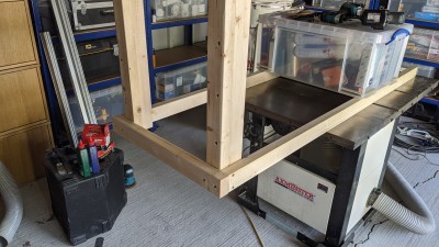

And we have a basic workbench sans top:

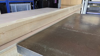

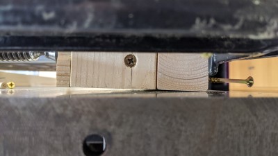

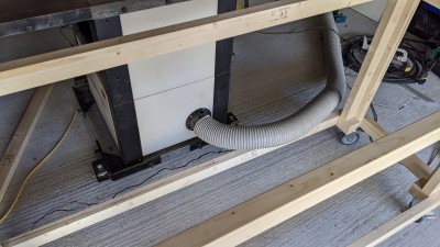

Then I realised it couldn't go all the way up to the table saw because of the extractor....

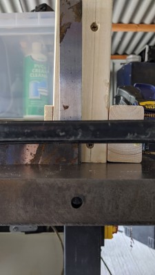

I also found I was out by 3mm:
This was due to an incorrect dimension on the details of the wheels (which I did verify before, but without a square edge) and the table saw is on an aftermarket trolley which isn't flat.
So, I'll probably raise and level the saw to match.
Chris.
