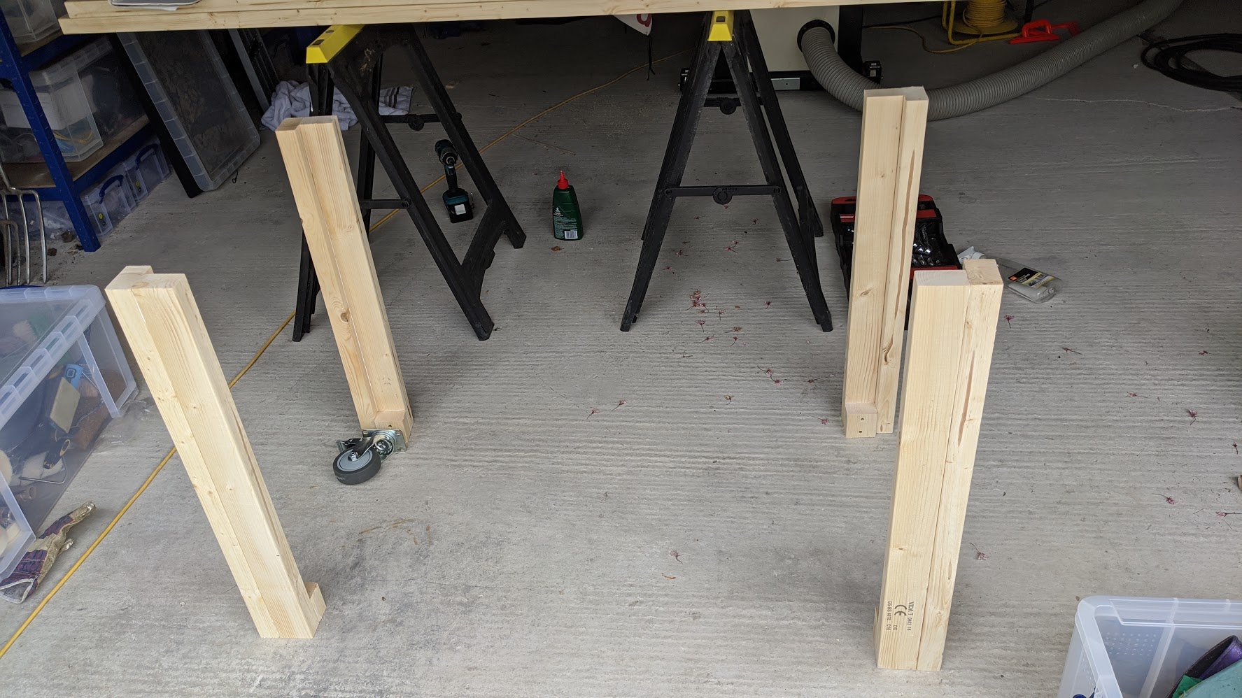

This new garage currently has no working surfaces, so a workbench was a top priority, having ordered some locking wheels, I measured the bench to be the height of my saw and made some legs.
Glued and screwed, the height looks good.

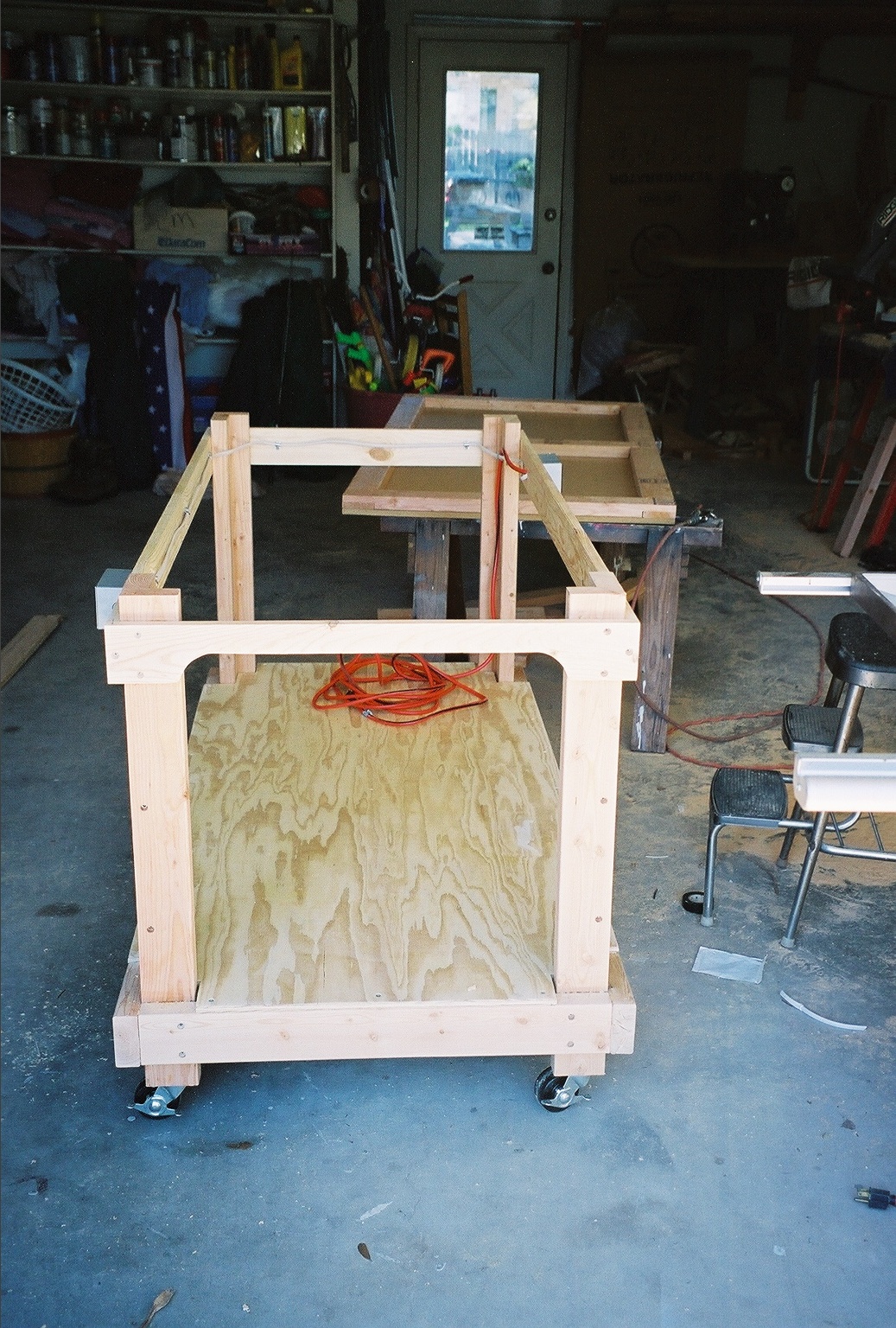

The legs on mine are built like that. Best project I ever did. I spend more time sitting at the bench soldering, building cabs, making cables, or just reading the paper......
I put power outlets on opposing corners - I highly recommend that.....

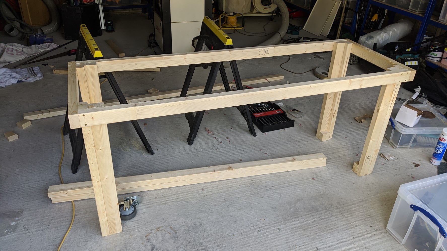

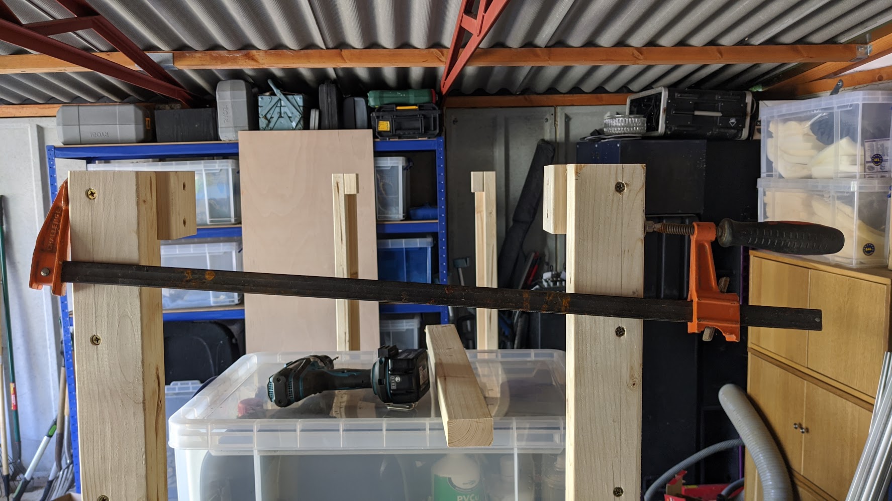

Got the legs on and it's looking ok:
Everything is nice and square:

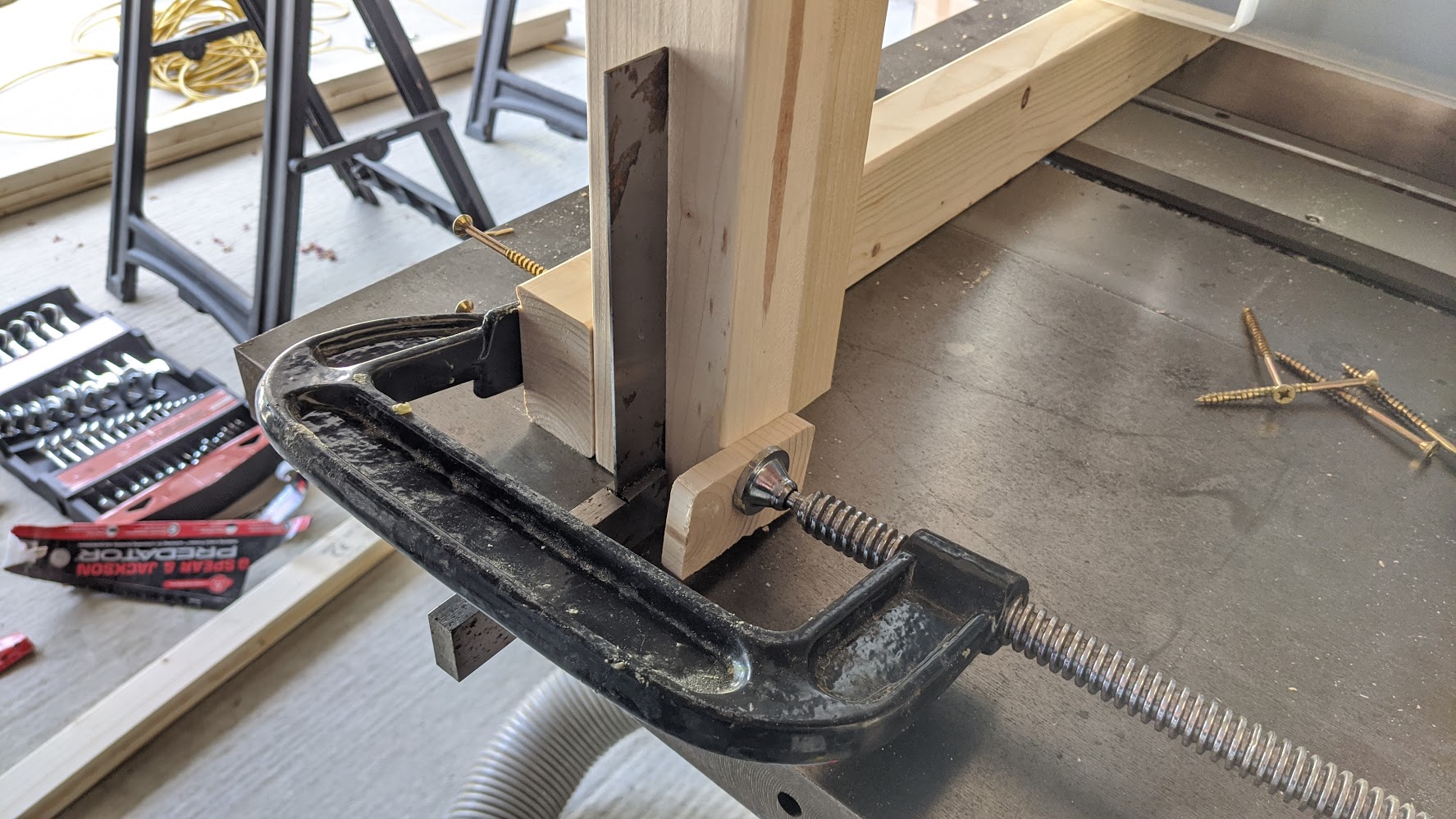

Except for the twisted crossbeam:
Which i decided to align the leg square the the beam and twist it back:

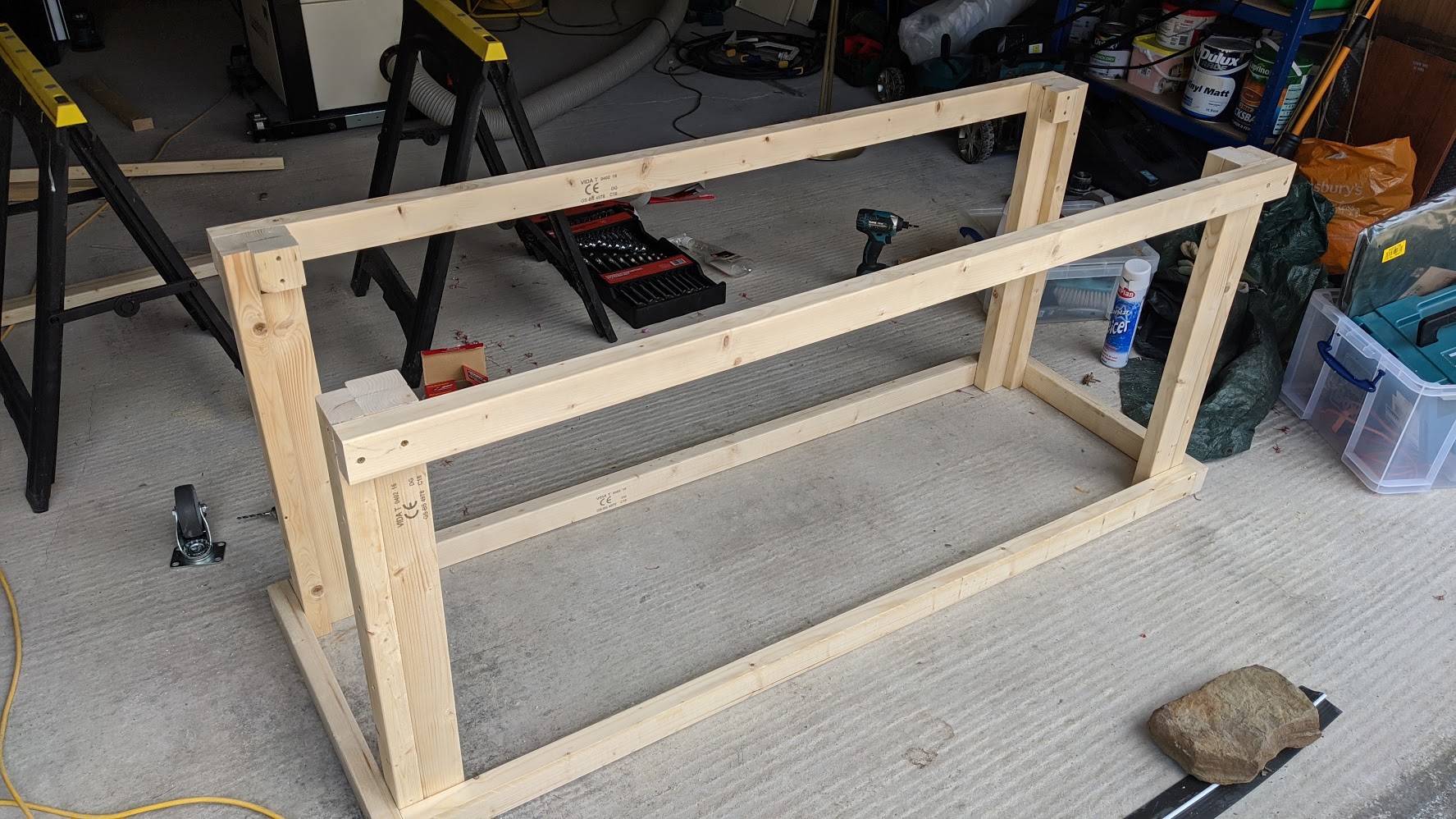

That was good enough to make the basic table:
Add the bottoms:

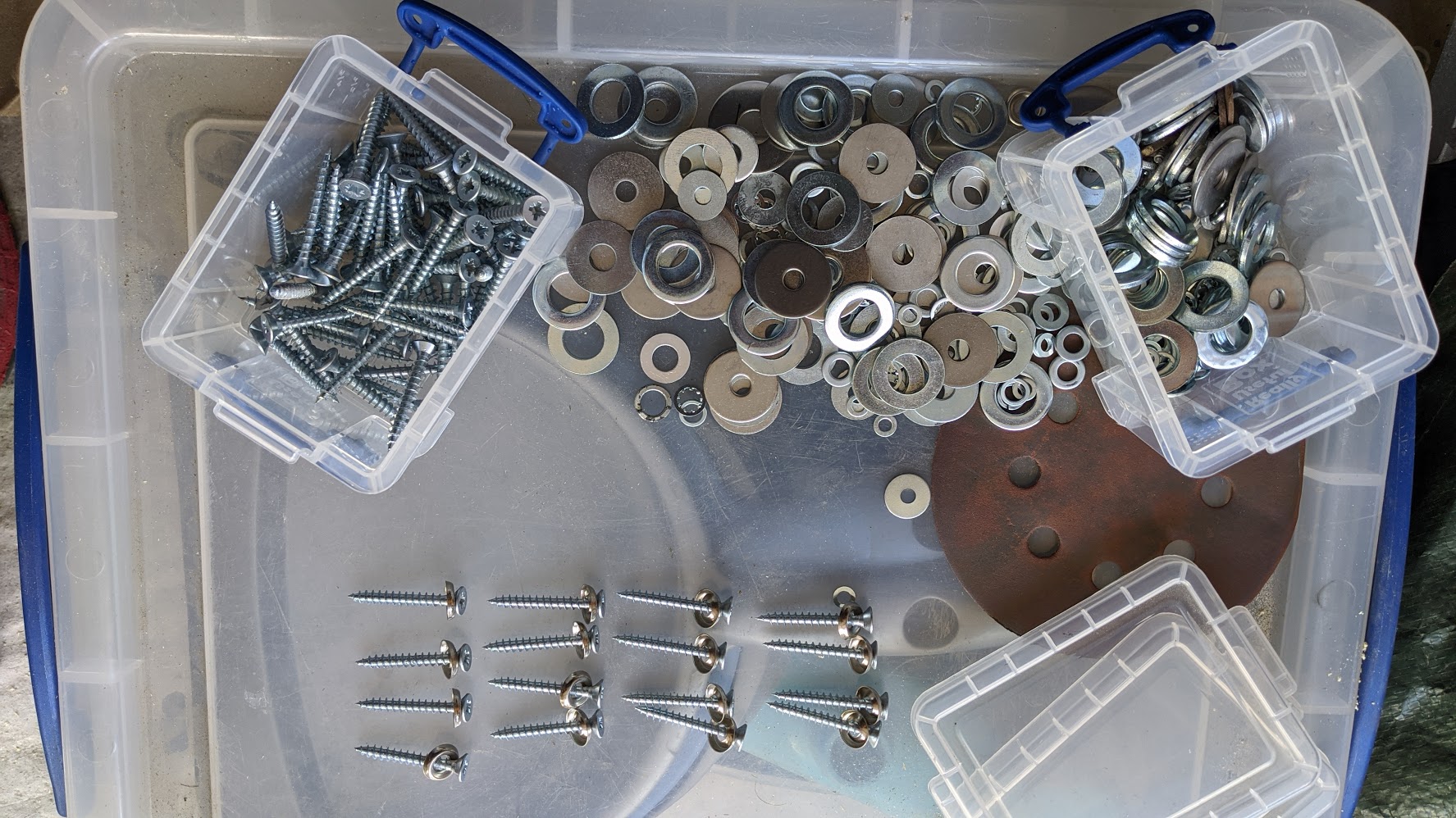

Fortunately, I had enough washers to attach the wheels:

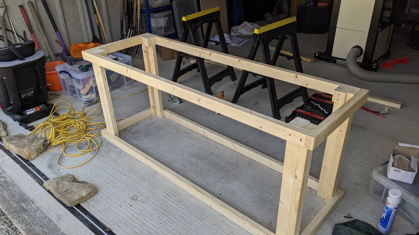

And we have a basic workbench sans top:

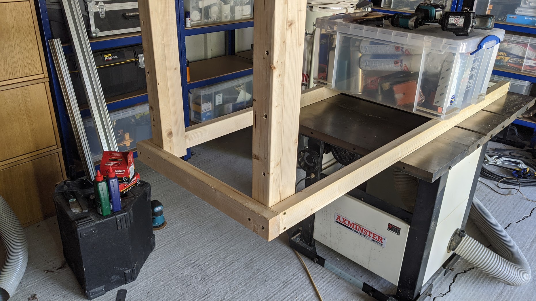

Then I realised it couldn't go all the way up to the table saw because of the extractor....

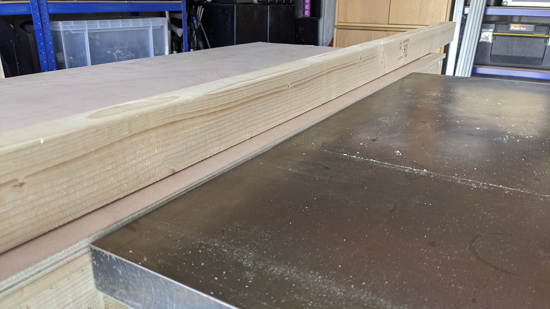

I also found I was out by 3mm:
This was due to an incorrect dimension on the details of the wheels (which I did verify before, but without a square edge) and the table saw is on an aftermarket trolley which isn't flat.
So, I'll probably raise and level the saw to match.
Add the bottoms:
