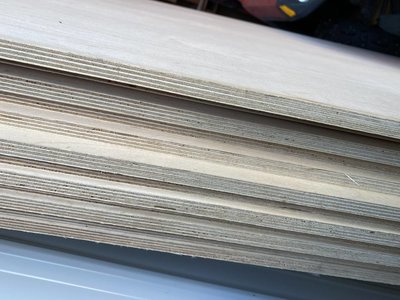

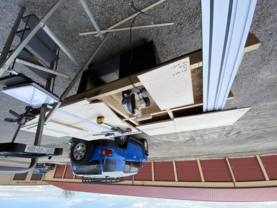

Anyways... here are some pics from the first cuts today.
I have 12 sheets ready to go... only need 10 for main panels.

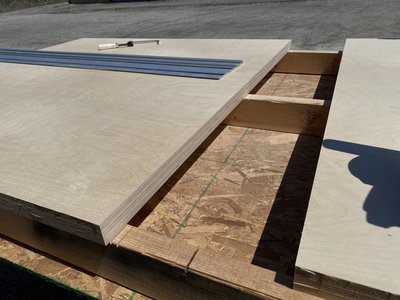

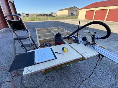

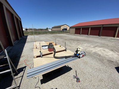

Panel cutting thingamajig .. I will have it on horses tomorrow. Was a little tough working on the ground.
Rip cuts made with sled
More tomorrow!!

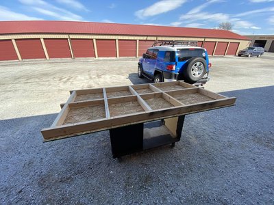

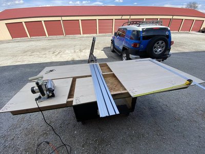

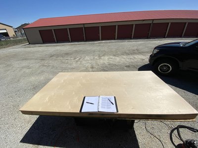

I was able to use my rack/CDJ console to support the cutting table. I was going to tear this box apart and build a new one... glad I didn't do it yet!
I actually built that about 11 years ago when I had the NS7. The large cavity below actually held my QSC KSubs in it! It was a pretty cool setup. Way to heavy though if I had to lift it or go over gravel. After a few times trying to do that I took them out. It was like that for a few years.
Worked out nicely.
Was a little high though.. I had to use a ladder to hop up there on the cross cuts.

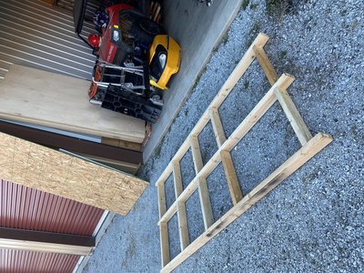

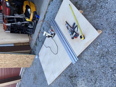

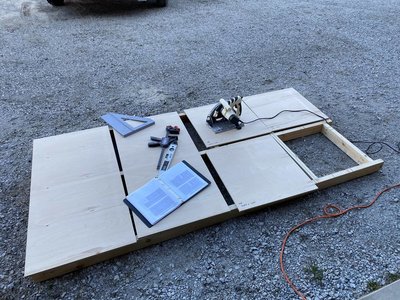

Got quite a bit done today. I actually cut 2-3 sheets at a time. Had me thinking I should have done 4 x 18" it was so easy to cut multiple sheets. Just looked at the cutlist layouts and figured what went together and it was a piece of cake.
3 sheets stacked to be sliced all at once with the war manual at the ready.

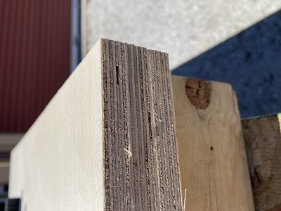

Wish I had remembered the wax for the sled. It would have slid a lot smoother. I have it in the truck for tomorrow. Oh.. I remembered to bring the little shop vac for dust collection duty. It was killing me yesterday with all the wind blowing it in my face.
And I needed some masking tape to keep the splintering down on the cross cuts.
I just kept clamps on the stacks of cut pieces so they would not move at all.
That was it for today! I have now cut 9 of 10 sheets.. one more to go!
I am going to use dowels and pocket screws to assemble these. I know it will take a while to drill all the holes but I remember when I built the T39's and the SLA Pro's it was kind of a pain to keep panels aligned once you put the PL on and clamp it down. They always tended to slide out of place. Very frustrating. I am going to use dowels to align then use the pocket hole screws to let it set up and cure. After it cures I will remove the pocket screws and fill the holes with PL.
I am also going to dado the panels for the braces on the inside panels. Those where a pain too I recall.
In my head.. this sounds like the way to go. I have not seen anyone else do it this way on here. We will see tomorrow!
