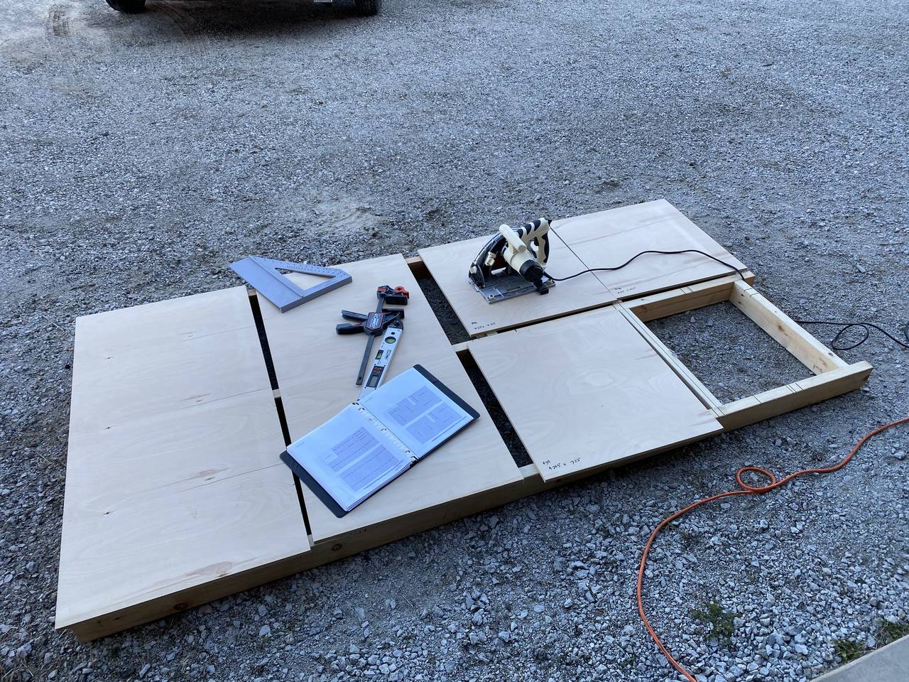

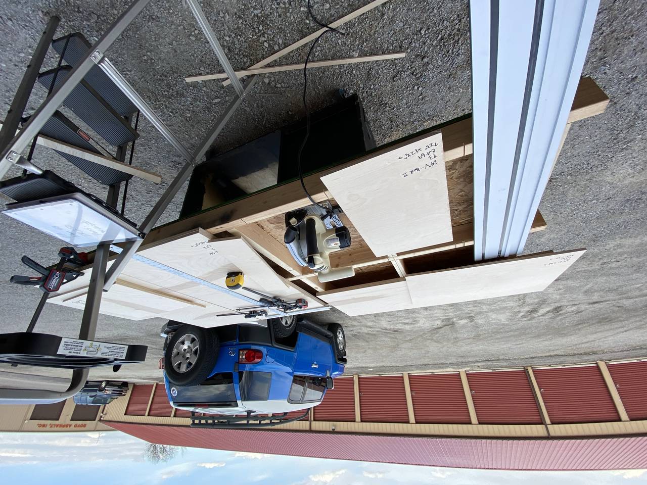

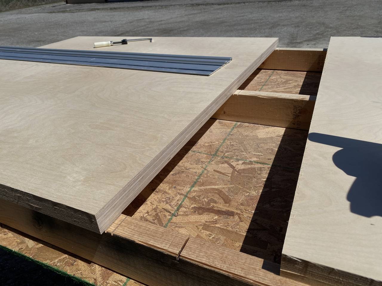

Anyways... here are some pics from the first cuts today.
I have 12 sheets ready to go... only need 10 for main panels.

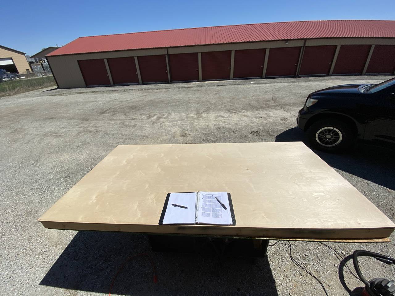

Panel cutting thingamajig .. I will have it on horses tomorrow. Was a little tough working on the ground.
Rip cuts made with sled
More tomorrow!!

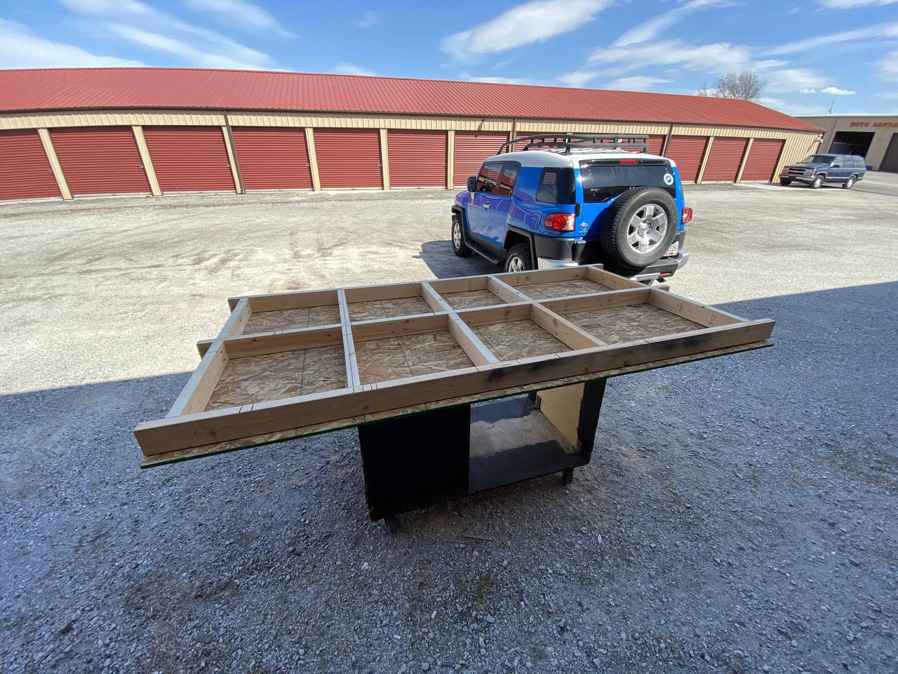

I was able to use my rack/CDJ console to support the cutting table. I was going to tear this box apart and build a new one... glad I didn't do it yet!
I actually built that about 11 years ago when I had the NS7. The large cavity below actually held my QSC KSubs in it! It was a pretty cool setup. Way to heavy though if I had to lift it or go over gravel. After a few times trying to do that I took them out. It was like that for a few years.
Worked out nicely.
Was a little high though.. I had to use a ladder to hop up there on the cross cuts. :chainsaw:

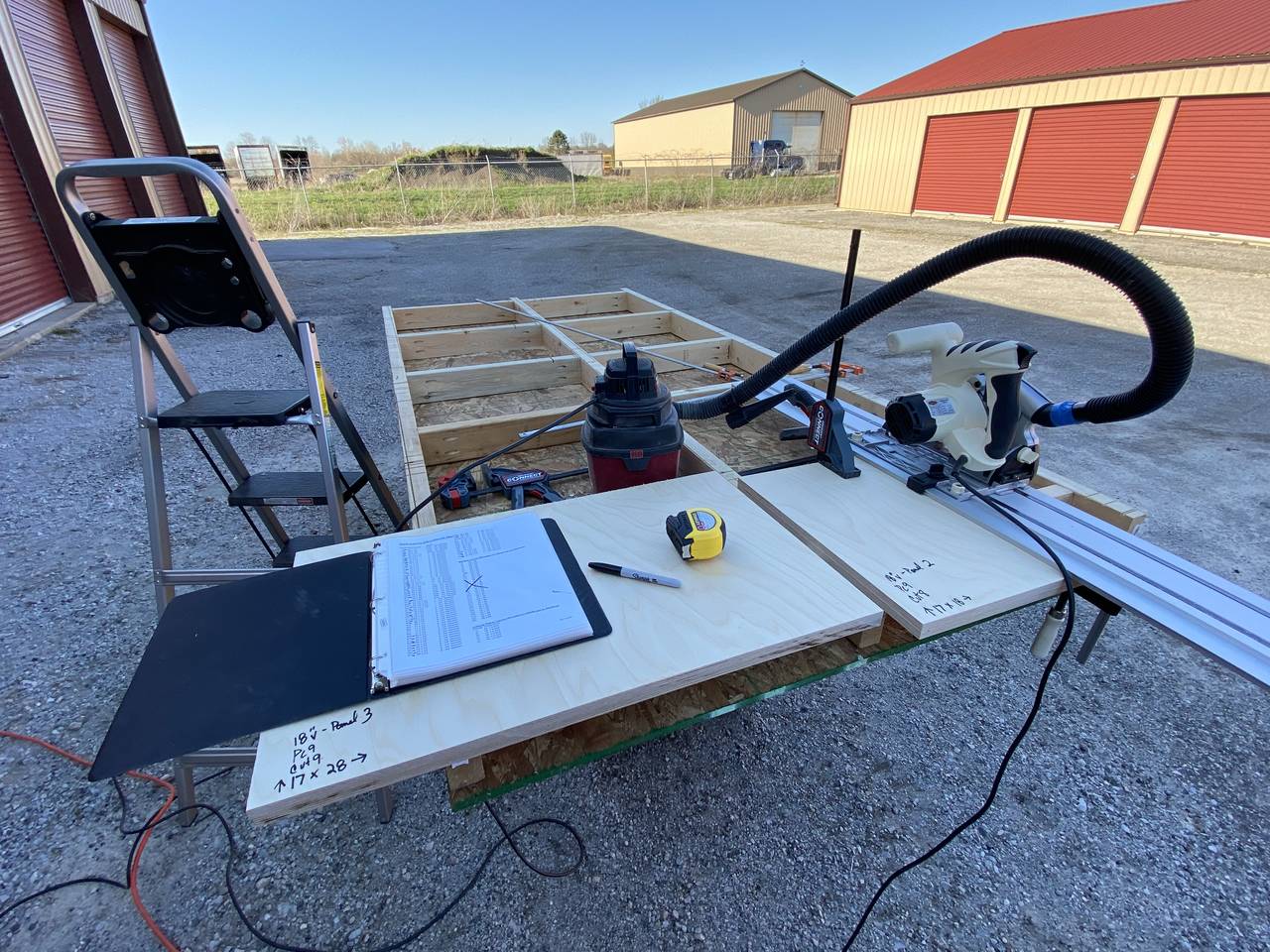

Build Session #3 - Today .. Time .. about 4 hours

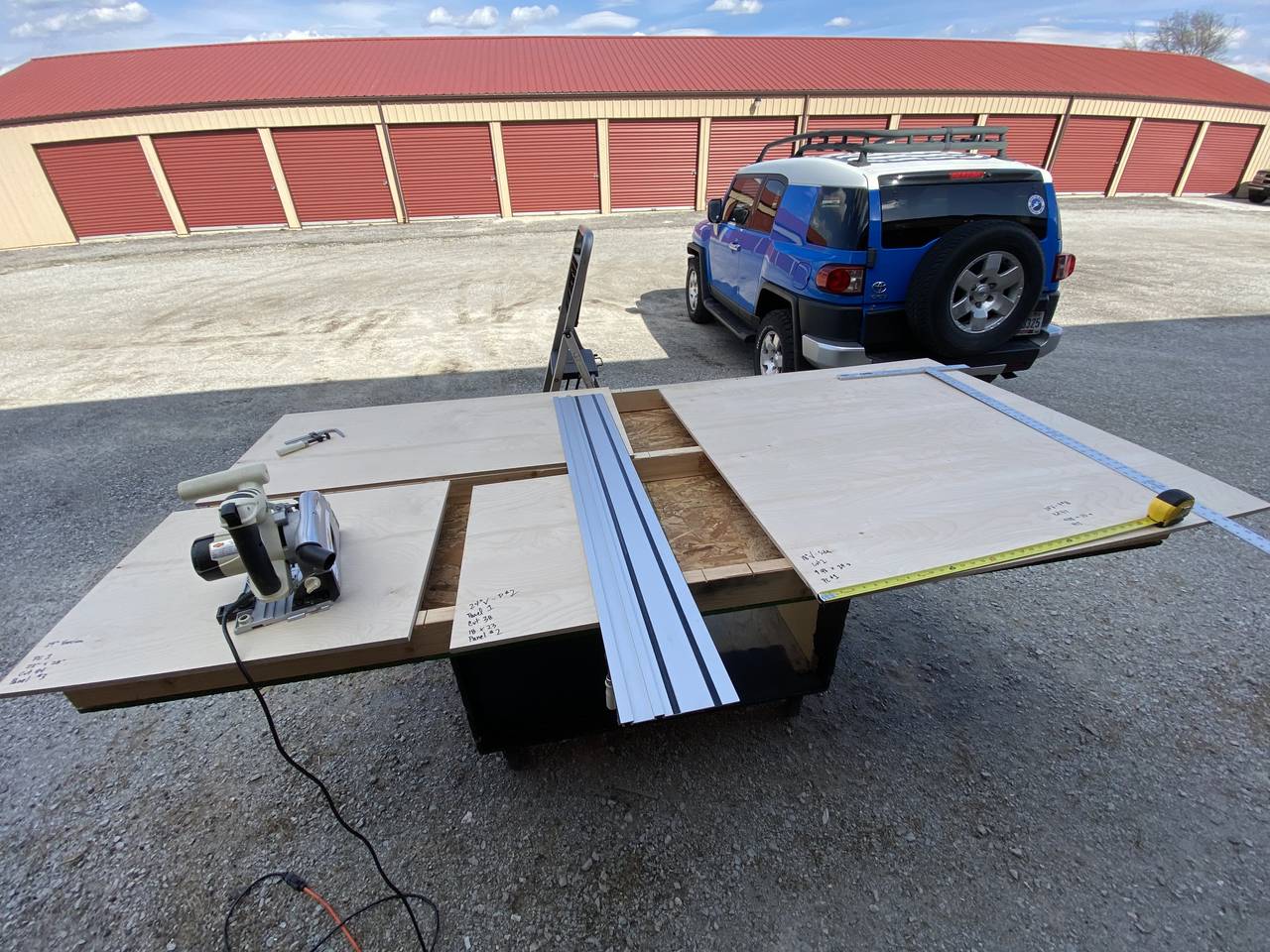

Got quite a bit done today. I actually cut 2-3 sheets at a time. Had me thinking I should have done 4 x 18" it was so easy to cut multiple sheets. Just looked at the cutlist layouts and figured what went together and it was a piece of cake.
3 sheets stacked to be sliced all at once with the war manual at the ready.

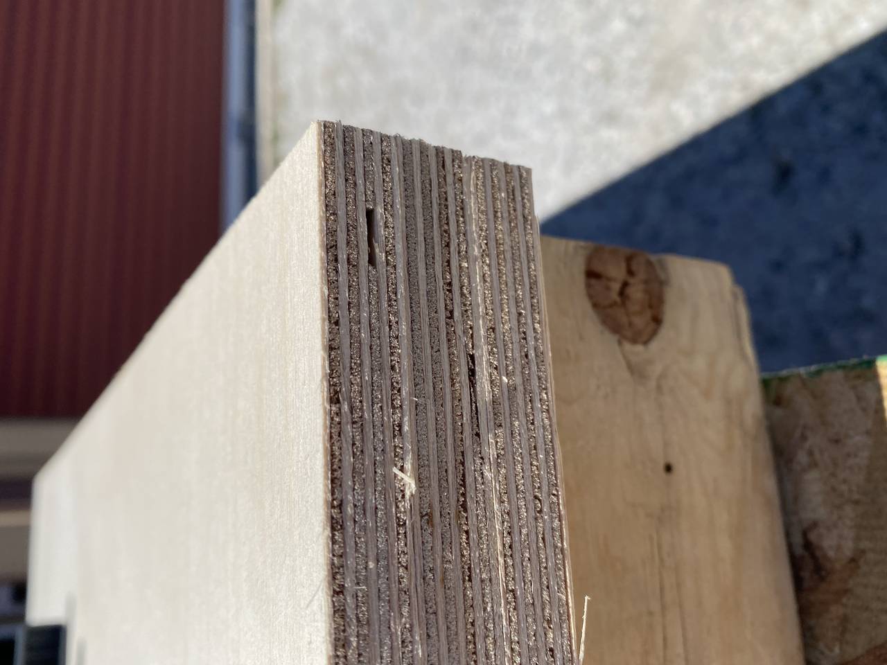

Wish I had remembered the wax for the sled. It would have slid a lot smoother. I have it in the truck for tomorrow. Oh.. I remembered to bring the little shop vac for dust collection duty. It was killing me yesterday with all the wind blowing it in my face.
And I needed some masking tape to keep the splintering down on the cross cuts.
I just kept clamps on the stacks of cut pieces so they would not move at all.
That was it for today! I have now cut 9 of 10 sheets.. one more to go!
I am going to use dowels and pocket screws to assemble these. I know it will take a while to drill all the holes but I remember when I built the T39's and the SLA Pro's it was kind of a pain to keep panels aligned once you put the PL on and clamp it down. They always tended to slide out of place. Very frustrating. I am going to use dowels to align then use the pocket hole screws to let it set up and cure. After it cures I will remove the pocket screws and fill the holes with PL.
I am also going to dado the panels for the braces on the inside panels. Those where a pain too I recall.
In my head.. this sounds like the way to go. I have not seen anyone else do it this way on here. We will see tomorrow!

Dowels, pocket screws, and dados have been done before, but they're purely aesthetic with Bill's designs. We don't do that mainly because it requires extra tools and time. I like to trace a 1/2" offset line from the edge of a panel then drive some screws in just so it pokes through the wood as a panel alignment helper, then glue the edge and drive the screws home. Requires less clamps and the panel stays aligned till the glue is dry. Then remove screws and carry on. Think of it as a removable dowel. A trick I'm sure I stole from someone here. I think I've had the same box of 1" screws for a few years now.
Looking good. Keep it up.

jimbo7 wrote: Tue Apr 21, 2020 11:14 pm I like to trace a 1/2" offset line from the edge of a panel then drive some screws in just so it pokes through the wood as a panel alignment helper, then glue the edge and drive the screws home.
That is a good idea. I will try it both ways and see whats easier/faster then go from there!

I found that using brads was much faster than screws. Align one end and shoot, align the other end and shoot, give the panel a few whacks with a rubber mallet to seat it, then fill in between the two initial brads with more every 4, 5, 6 inches (whatever feels right). But, the same caveat exists, not everyone has an air compressor and brad gun. I didn't for the first cab I built (AutoTuba) and every panel got screws, pre-drilled and counter sunk. A complete PITA compared to a Brad gun.
I like the idea of a screw tip poking through each end to help keep things from slipp'n and sliding around. Think I'll try that out on my next build. Shoot, there's already holes drilled 2" from the end of each panel. Almost a no brainer. Thanks Jimbo.
Dowels and pocket screws sounds ambitious. I would not mind at all... watching someone else do that in their project. I'm in complete support :thumbsup:

On big builds like T48s, screws are helpful. As stated, drill 'em, and let the tip come through just a little on each in of the panel for alignment. Pull those down tight and then nail it. If you don't have a nailer, then use screws every few inches. As long as everything is pre-drilled, it's pretty easy. Just hang one end off the table, screw it. Then flip it around and hit the other end.
As a woodworker, I appreciate dados and dowels (although I prefer biscuits), but it is really a huge waste of time on these boxes. Spend your time marking both sides of the side panels where the interior panels go. And not just a center line, you can do that on the outside, but you have to draw the edges of the panel so you can line it up when you are putting it together.
Like Jim, I still have the screws from my very first build....always pull 'em out and fill with bondo. They serve no purpose as the glue does the holding.....and that PL really holds.
