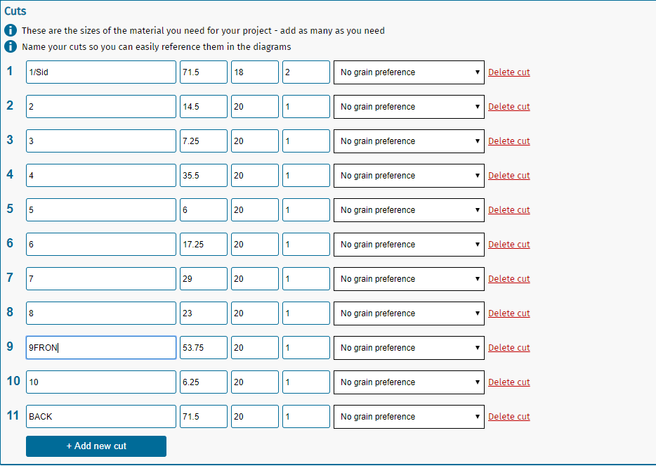

Still working on a cutlist- so i can visually make it a bit more idiot proof....yes im a idiot at times... Attached is my cut-list so-far which I think I have correct...

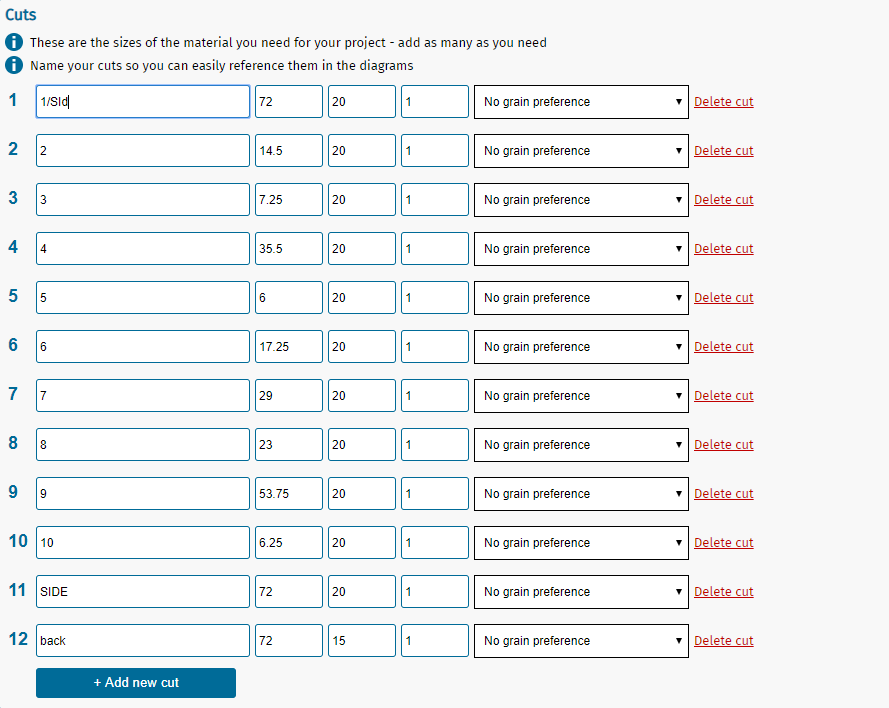

I know this might seem a bit pedantic, but are you building 1 dual loaded cab, or 2 single loaded cabs?

Grant- I'm building two single loaded thtlp

I believe I have it correct, I am "referring" to panels in different terms which may confuse. I plan to make the throat face forward. Its showing as ill need 2 and 1/4 sheets with a lot of scrap, so I think ill have enough for braces.
