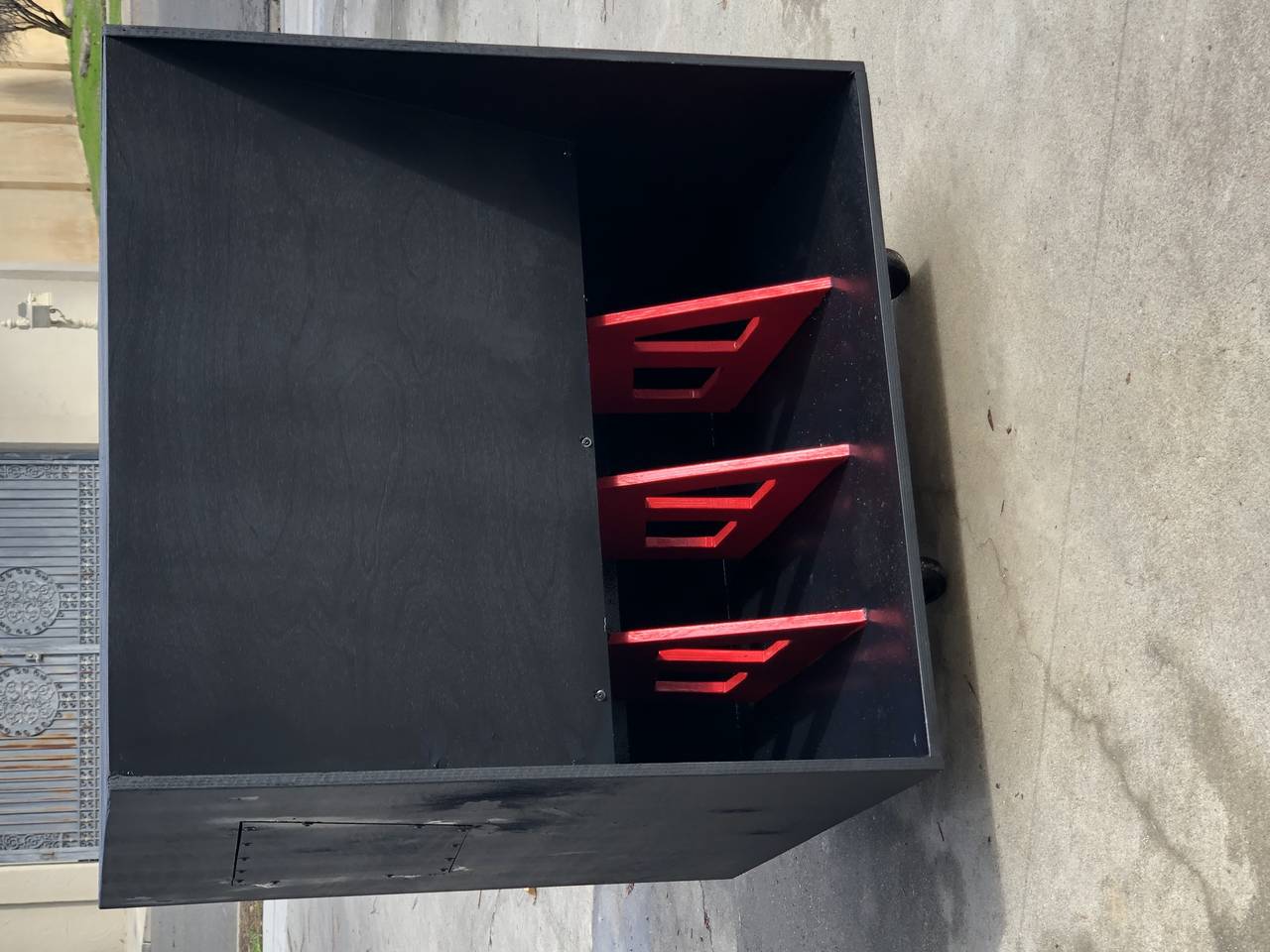

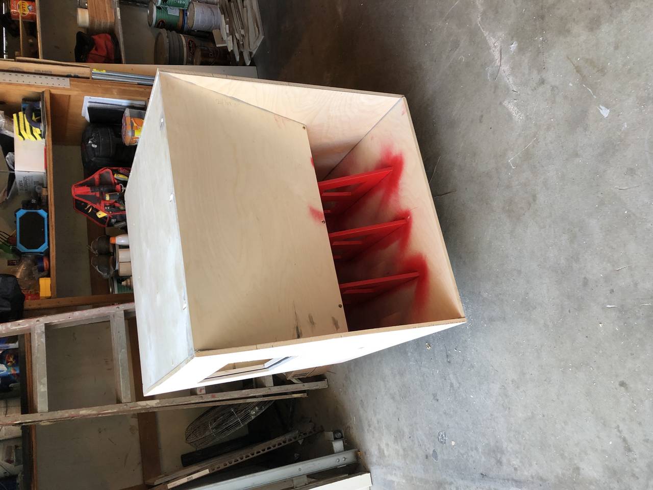

This thing bumps! Man I am overly impressed and about to start the next one tomorrow. Should go quicker now that I’m familiar with how to make them.
Its
4- 29” tuba 30 w/ dual kappalite 3012lf
2 - 18” tuba 30 w/ 3012lf
4 - OT12 w/ 3012HO and crossfiring tweeter array
2 more OT12 w/ 3012HO and tweeter arrays in progress

Nice huh! What did that beast weigh in at? Moar pics also.

Haven’t put it on a scale but it’s 30x30x29 and has the 2 kappalites which are about 7lbs each

For DJ use. House and Techno mainly.. it came in at 115lbs. Heavy but man does this thing hummmm. Just started the next one and should have a majority done by this weekend.
I’m hoping to have it done for next week. We have an outdoor gig and want to run 2 of these bad boys. All of my buddies can’t believe the bass these things put out. After showing them they’re all believers now. Next on the agenda is some OT12’s only cause I don’t know if I could make the DRs.
