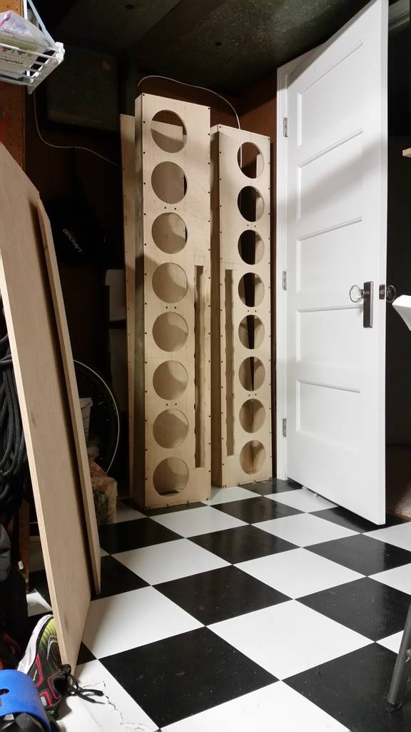

Ready for finishing. I was so nervous but also so excited at the same time, as I was building these. To echo others -- take. your. time. as you build these. Go slow and do it correctly.

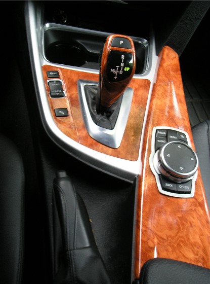

If you're going to wrap it wrap it. This is my car, the 'wood' is 3M Di-Noc in Gloss Bubinga.

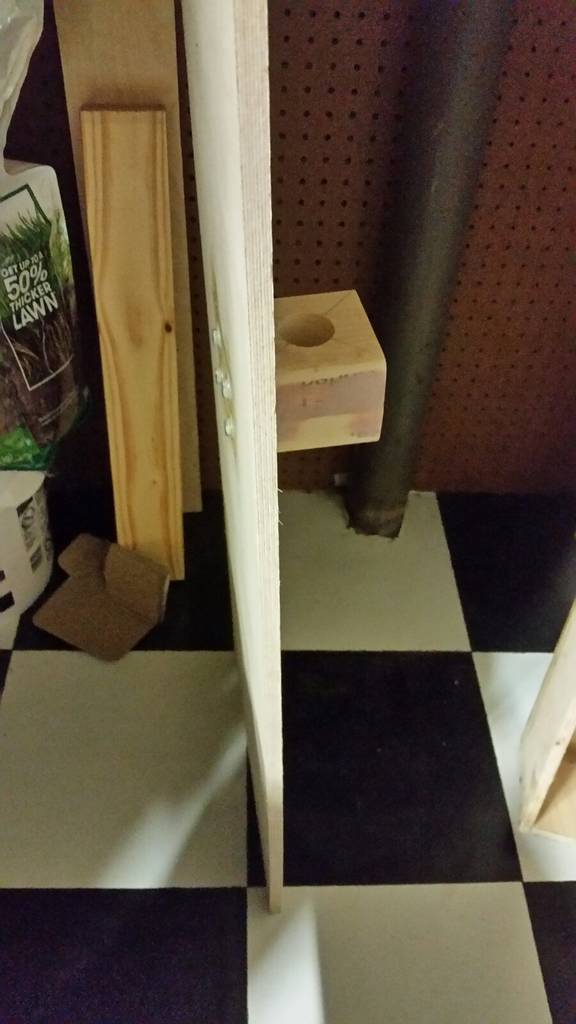

Last pic before finishing. I wanted to beef-up Bill's plan for pole mounting these by doing the following
I drilled all the way through one 2x4, Gorilla glued another un-cut 2x4 on top of it, and then Bondo'd the middles until it was one smooth, uniform piece. I attached it to the back with long bolts and washer, just to spread the load better.

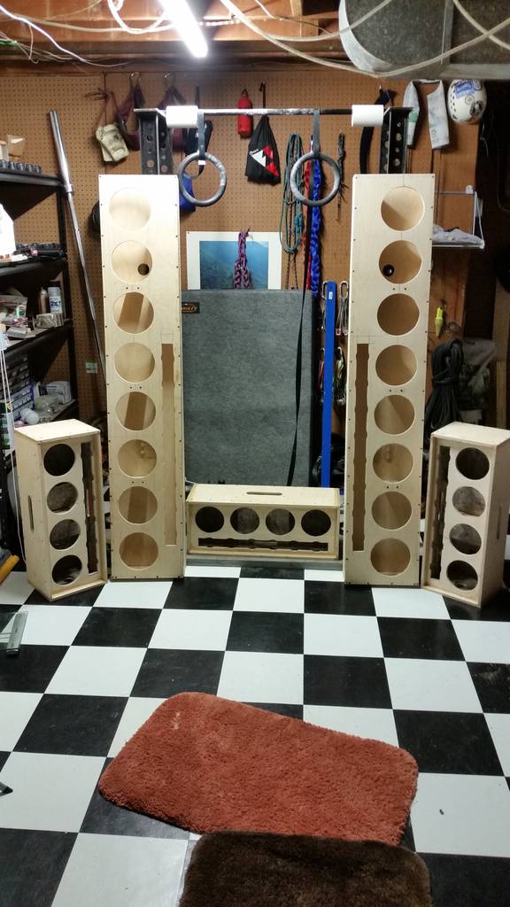

Yeah! The family's all here! They're going to finishing school later today.

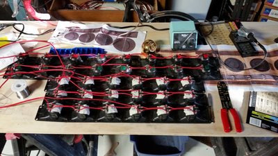

cut, strip, solder....repeat (2 sets for TLAH Pros, 3 sets for SLA Pros)

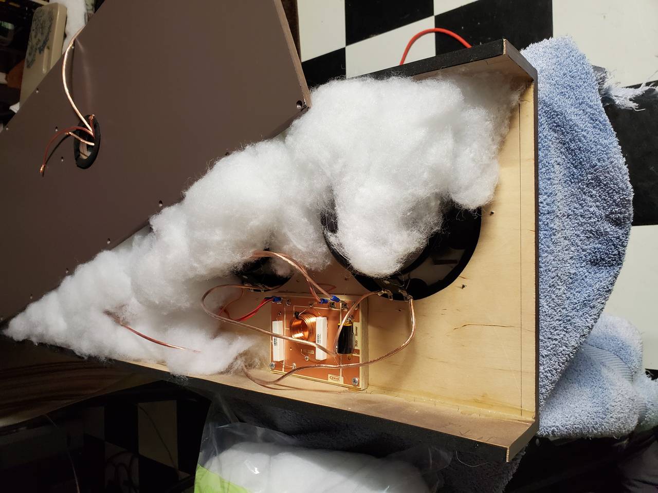

Question about stuffing for the TLAH Pros. How much is "enough"?
The plans look different, and if I don't put any stuffing between the mouth and the first brace (such that the top 2 woofers don't have any polyfill behind them) is that...ok? Also, has anybody built a box (wire mesh?) around their Xovers? I think that would be a good idea so you could stuff the whole thing and not worry about stuffing on the electronics.
me
me
- Posts: 29008
Re: 2x TLAH pro in progress...
The most critical place to stuff is near the terminus, the least critical is near the closed end. Put the crossover near the closed end so you don't have to put stuffing around it, and the cab is larger giving more room to place it. You need to use enough stuffing that it's compressed slightly.
