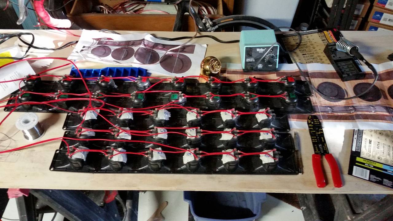

cut, strip, solder....repeat (2 sets for TLAH Pros, 3 sets for SLA Pros)
