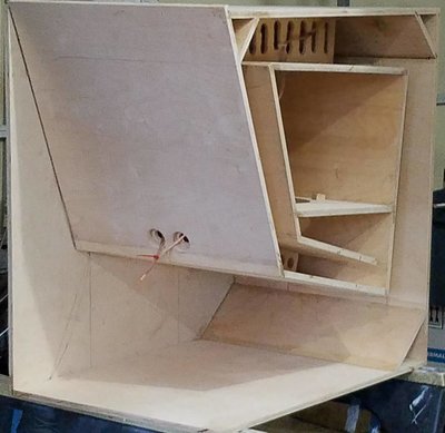

Some progress today on my two T30's. Panels 1 and 2 are attached, baffles have been cut out and backer blocks glued and screwed. I don't have the right screws to mount and test the drivers, so in the meantime i prepped Panels 4, 5 and 6. Unfortunately, I will need to pick up stock for Panels 7. I bought Menards scrap baltic birch and they are just a little too short to get the 21.25 inch panels - crud. On the bright side, the panels are really good. I had the guys bring down a pallet of 400 and went through them to find the good ones. Dead flat and no defects. Apparently they got some sheets with too many knot holes, so chopped out the "bad" sections into 20x20 pieces to sell instead. More to come, hopefully later this week.

Panels 7, 8, 9, 10 and 11 all in place. 1/10 braces curing right now. Pretty happy with my jacks, got better with the hand holds as I went along. Have two jacks in front, two in the corners on the back. Question: Thinking to run wire from each of the four jacks into the driver chamber, drive a couple hanger bolts into the wall, and then use ring terminals on the wire ends and bolt them all down on the hanger bolts. Including the wires from the drivers. Would make it easy to undo/redo in the future. Good idea? Or not?
Debating whether to make the 6/12 braces straight or curved. Kids say curved. Straight seems easier.

Panels 12 on. That's it for now, time to clean up my mess.

A little more progress. Got the second side access holes cut and cleaned up, wires run from the jack holes into the driver chamber, and stuck the second sides on. One came out spot on, the other is out of square by maybe a sixteenth... no complaints, nothing a little sanding can't take care of.
I have read the plans, and read the plans, and read the plans. And guess what, no real issues along the way so far. Imagine that!!
I took some pictures and will get them posted up here soon.
Next up:
Cutting and installing the big bottom braces and putting in the access door flanges. Maybe tomorrow.
Now that they are actual boxes, geez, they're big!

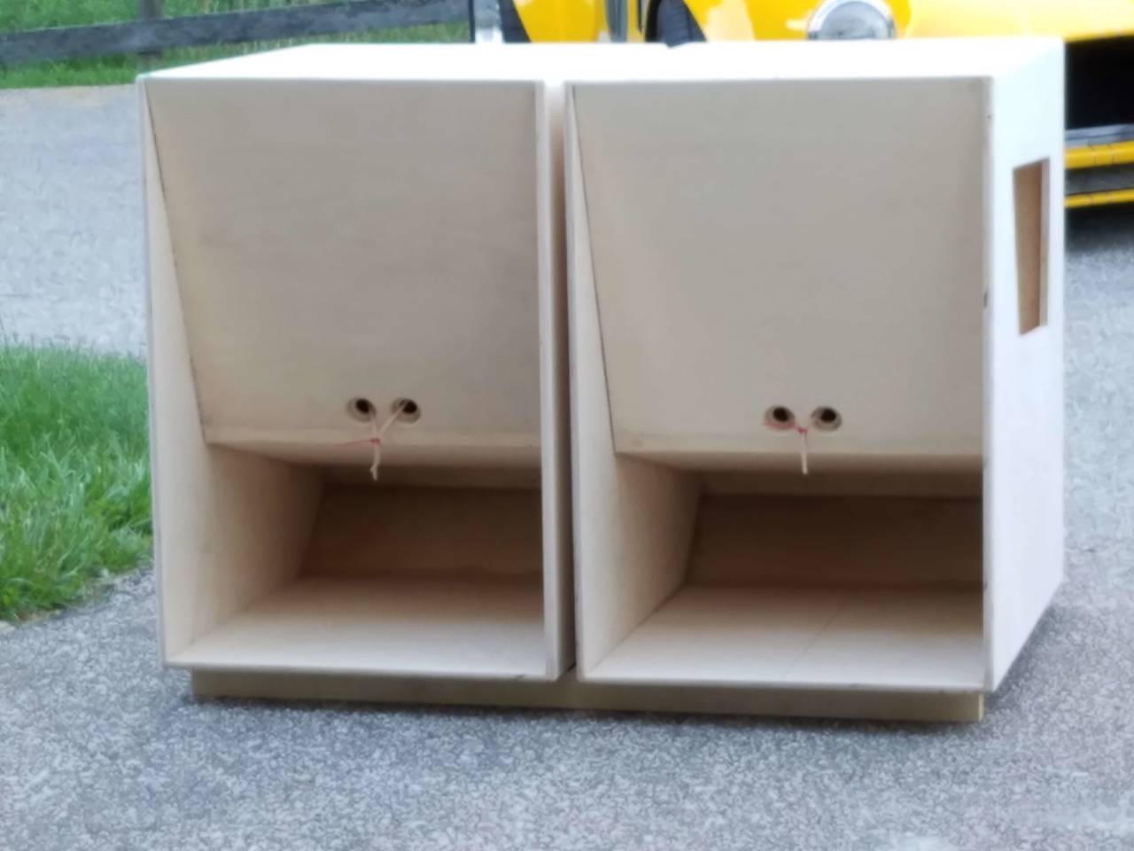

Okay, a couple photos. Although with tactix' CNC tuba pics being posted, I'm a bit embarrassed
... oh well. Rounded over edges last night and filled most of the brad holes. Geez, the bondo was setting up super fast. It seemed I have very little time before it set and I was using only a tiny bit of hardener. I'm going to try and get them finished up enough to be playable tonight, but there's still a lot to do so that might not happen. Moving them around to sand and such, I'm realizing I should have put handles on the front top and bottom too. That will be an easy add in the near future.

So stayed up Thursday night until almost 2am cuz I really wanted to try these out on Friday. Got them complete enough. I only wired up a single jack each since I'm still waiting on my backordered neutrik faston's. Not thrilled with my access covers. Actually, it's the flanges. I think they could be wider, since there's not much meat on a couple sides. Nonetheless, got them on. Rolled on a quick coat of flat black, followed by a first coat of duratex and called it a night. Still need to add the big braces, wheels, corners and a few more coats of paint.
On Friday I set them up side by side facing the outside concrete wall of our building, about a foot away. The walls are 30+ feet tall, so figured that would work well. Looking for some feedback on how I limited voltage. I wasn't planning to run them hard as this was truly the first time they've ever been powered up. I put a 60hz signal through the system and measured 35v from the amp. Then I went into the limiter section of my PA2, made sure overeasy was off, and then just adjusted the threshold until I saw the volts on my meter start to decrease. I know I can run up to 50v, but I wanted to be very conservative at this point until I have more time to play with settings. I sent the HP at 35hz with the LR48 filter. HP was around 100hz, I can't quick remember.
Anyway, after that, i ran the system for almost 7 hours, with a pair of JBL Control28"s providing 110Hz and up. The sound was really nice not tiring to the ear. We had a bean bag toss tournament about 50 foot away and low end felt really good there. No one had to shout, but you could feel the bass in your chest. Random playlist of requests.
Overall, I'm pretty happy. Will be glad to get all the final cleanup stuff done on the cabs and run them a little harder next time to see what they can really do.
