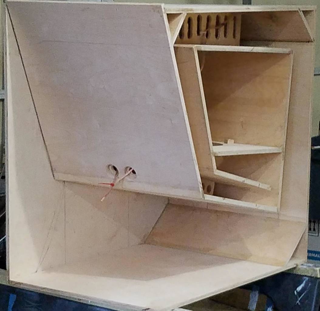

Okay, a couple photos. Although with tactix' CNC tuba pics being posted, I'm a bit embarrassed   ... oh well. Rounded over edges last night and filled most of the brad holes. Geez, the bondo was setting up super fast. It seemed I have very little time before it set and I was using only a tiny bit of hardener. I'm going to try and get them finished up enough to be playable tonight, but there's still a lot to do so that might not happen. Moving them around to sand and such, I'm realizing I should have put handles on the front top and bottom too. That will be an easy add in the near future.
 ... oh well. Rounded over edges last night and filled most of the brad holes. Geez, the bondo was setting up super fast. It seemed I have very little time before it set and I was using only a tiny bit of hardener. I'm going to try and get them finished up enough to be playable tonight, but there's still a lot to do so that might not happen. Moving them around to sand and such, I'm realizing I should have put handles on the front top and bottom too. That will be an easy add in the near future.2xT30 (20", 3012LF)

So stayed up Thursday night until almost 2am cuz I really wanted to try these out on Friday. Got them complete enough. I only wired up a single jack each since I'm still waiting on my backordered neutrik faston's. Not thrilled with my access covers. Actually, it's the flanges. I think they could be wider, since there's not much meat on a couple sides. Nonetheless, got them on. Rolled on a quick coat of flat black, followed by a first coat of duratex and called it a night. Still need to add the big braces, wheels, corners and a few more coats of paint.
On Friday I set them up side by side facing the outside concrete wall of our building, about a foot away. The walls are 30+ feet tall, so figured that would work well. Looking for some feedback on how I limited voltage. I wasn't planning to run them hard as this was truly the first time they've ever been powered up. I put a 60hz signal through the system and measured 35v from the amp. Then I went into the limiter section of my PA2, made sure overeasy was off, and then just adjusted the threshold until I saw the volts on my meter start to decrease. I know I can run up to 50v, but I wanted to be very conservative at this point until I have more time to play with settings. I sent the HP at 35hz with the LR48 filter. HP was around 100hz, I can't quick remember.
Anyway, after that, i ran the system for almost 7 hours, with a pair of JBL Control28"s providing 110Hz and up. The sound was really nice not tiring to the ear. We had a bean bag toss tournament about 50 foot away and low end felt really good there. No one had to shout, but you could feel the bass in your chest. Random playlist of requests.
Overall, I'm pretty happy. Will be glad to get all the final cleanup stuff done on the cabs and run them a little harder next time to see what they can really do.
