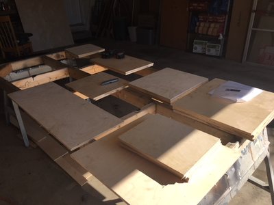

Started on another pair of OT12 this weekend. These are “regular” model, 1/2” BB, flat array, Delta Pro 12-450A, Duratex. It had been a while since anyone posted a thread building these so I thought I’d grab a couple pics. I started on Saturday morning with a trip to the lumber yard. I was pleasantly surprised to learn the price of a sheet of 5x5 BB had actually went down to $27. Working by myself in the garage I made good progress over the weekend, using a kit from Leyland at speaker hardware.
Panels rough cut
Panels rough cut

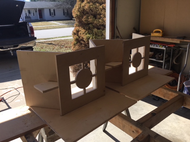

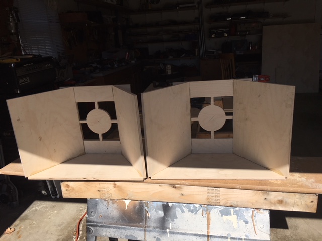

Horn sides and baffles
Horn sides
Horn sides

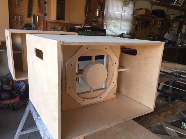

Rear view of box
Box rear
Box rear

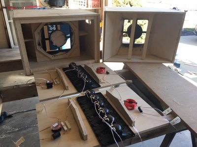

Front and rear of boxes, rear panel with braces, arrays and crossovers
Boxes and arrays
Boxes and arrays

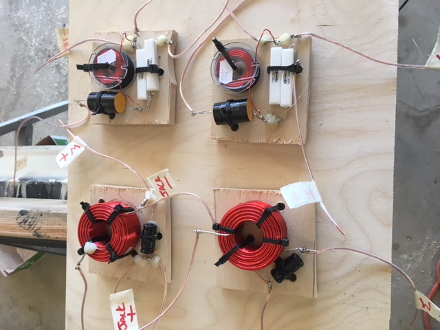

Crossovers mounted to boards
Crossovers
Crossovers

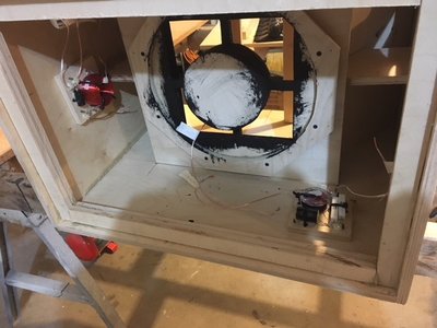

#11 Post by Preston »
Installed the backs prior to prepping for finish. I actually had a "bit" of trouble with this step... I broke two drill bits while drilling the pilot holes and countersinking.
