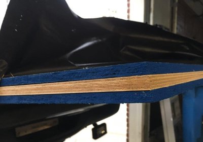

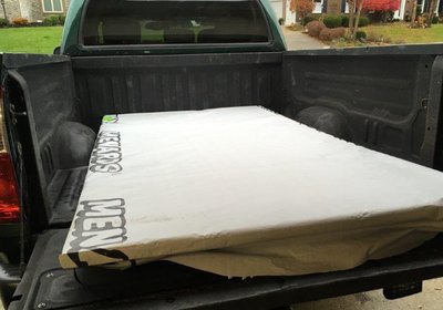

Here is the sheet of Baltic Birch when I got it home from Menards

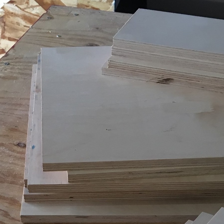

Cut all the pieces

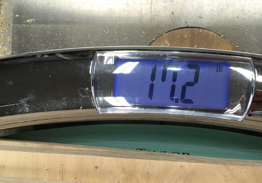

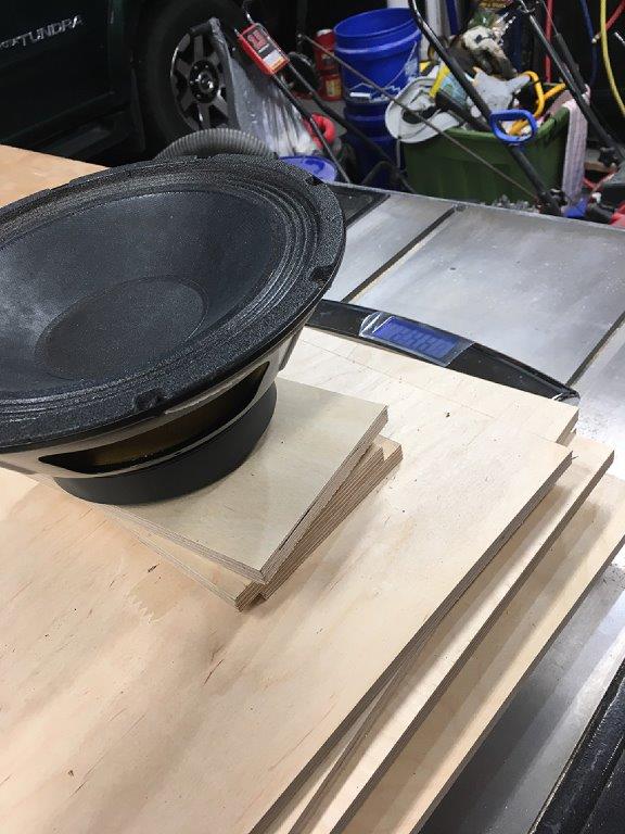

Panel weight for a single S110 came in at 17.2 pounds:

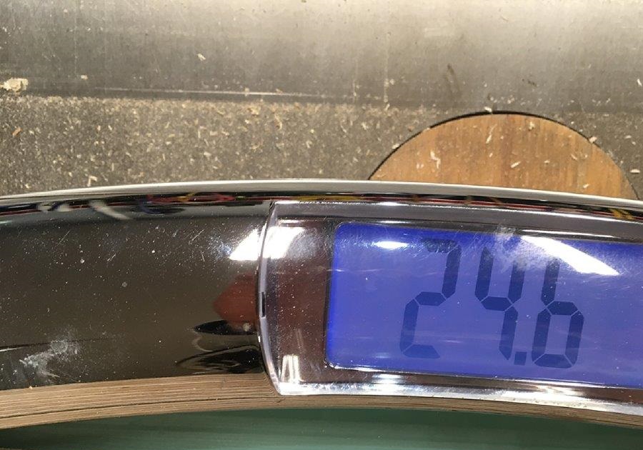

And with a BP102 it came to 24.6 pounds:

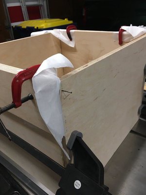

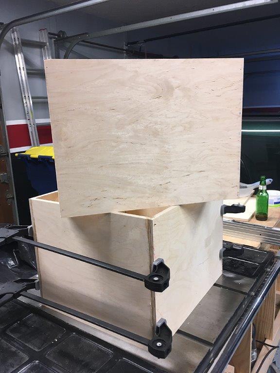

Gluing up the sides. I was not comfortable screwing the flat jigs into the cabinet so I used wax paper and C-clamps along with some finish nails to hold the panels in place. I removed the C-clamps as soon as I had the panels in place with the finish nails and left the bar clamps on for twenty-four hours.
Second cabinet in process:

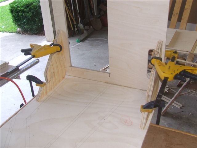

Next time, build you some of these......the only way to go when squaring up a corner....

Very cool!Bruce Weldy wrote:Next time, build you some of these......the only way to go when squaring up a corner....

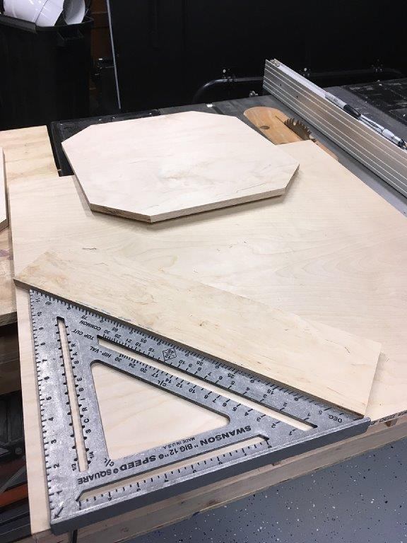

Cutting the angles on the baffle for the vent ports. I made a simple miter sled for my table saw out of scrap wood. The miter fence was set into place using my speed square and secured with clamps and the amazing PL.

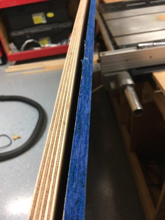

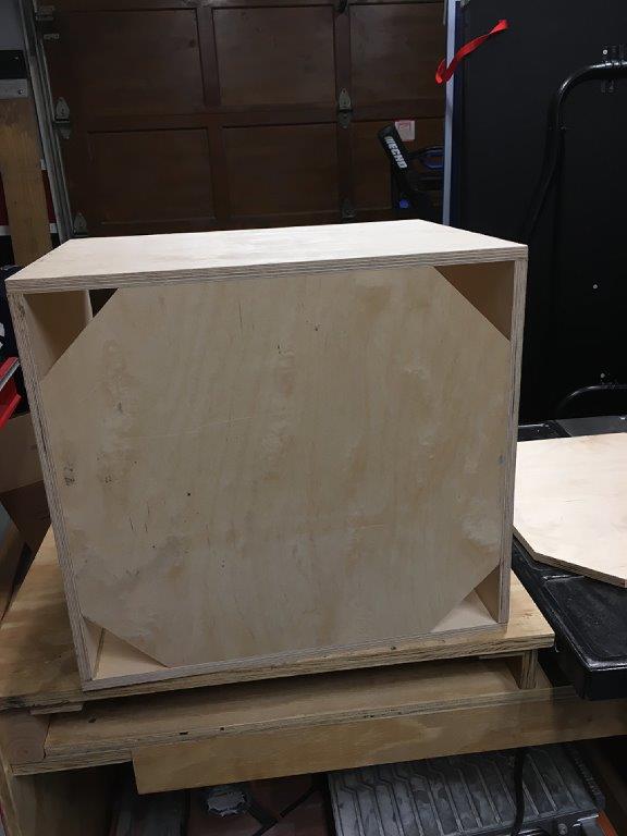

Test fitting the baffle. I will probably run this through the table saw and take just a hair off all four edges so that it fits a little easier and does not scrape off the PL during installation. Before anyone gets too excited here yes - the baffle sets further in. This was just a dry test fit for a photo op.
Presently making a jig for my router so I can make the speaker hole cut out and hope to have that done today.

I've been looking at the plans for this box because I'm thinking about building a couple.....seems to me that I'd install the baffle as I'm building the box instead of trying to fit it in later. If you measure and cut properly, that would be much easier. I'm sure the plans are the way they are to make it more of a "cut to fit" situation for the baffle for those with less precise tools.

You know the same thought crossed my mind as well. I thought about assembling two sides and the baffle and then adding the last two sides. Maybe if I build another set I will try that approach.Bruce Weldy wrote:I've been looking at the plans for this box because I'm thinking about building a couple.....seems to me that I'd install the baffle as I'm building the box instead of trying to fit it in later. If you measure and cut properly, that would be much easier. I'm sure the plans are the way they are to make it more of a "cut to fit" situation for the baffle for those with less precise tools.
