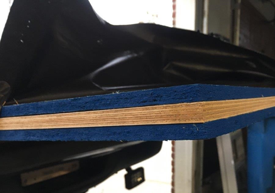

Here is the sheet of Baltic Birch when I got it home from Menards

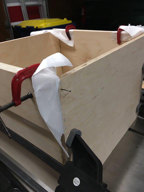

Gluing up the sides. I was not comfortable screwing the flat jigs into the cabinet so I used wax paper and C-clamps along with some finish nails to hold the panels in place. I removed the C-clamps as soon as I had the panels in place with the finish nails and left the bar clamps on for twenty-four hours.
Second cabinet in process:
