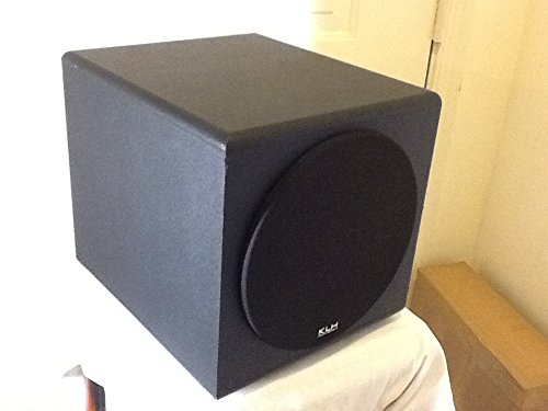

My current woofer is definitely the weakest part of the existing system. It’s a KLH “Bassbite V” 10 inch 40 watt self-powered woofer that originally sold for $49.99

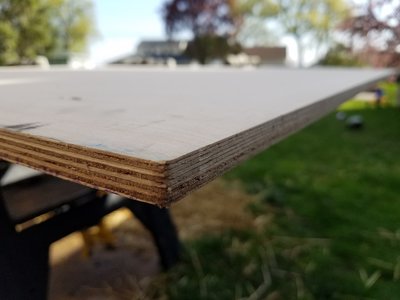

This is real 9 ply Baltic Birch plywood… different from the ACX plywood that Menards also offers.

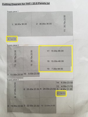

I’m going with a 24.5” wide THT. I considered going larger, but this is an efficient use of the plywood and will give me more options on where to place it. This requires ~2.5 sheets of plywood. Since I would have extra plywood, and since I plan on updating the rest of the system as well, I figured I might as well go ahead & cut out the panels for a 9 driver curved SLA center while I was at it. :D
I used a cutlist program to layout each of the panels before cutting (http://www.delphiforfun.org/programs/cutlist.htm). The panels circled in yellow are for the SLA center, and the rest are for the THT.

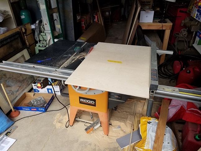

I’m fortunate enough to have a table saw, which I then used to rip the panels to their final sizes. I was able to run multiple panels thru the table saw with the fence set at the 23.5” panel width to try to keep everything consistent.

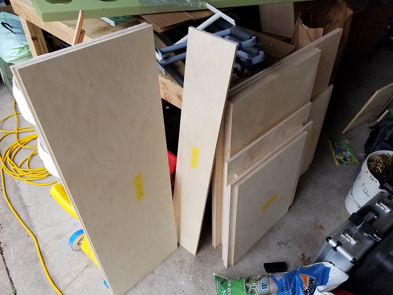

After a couple hours of measuring & cutting, I had all the panels cut for both the THT and SLA center. I used painters tape to label each panel as I cut them, with their panel # and intended dimensions. That way I won’t grab a finished panel thinking that it’s scrap. The two rectangular panels on the left of the picture are the top/bottom for the SLA center. Bill sure likes to design large speakers doesn’t he? :lol:

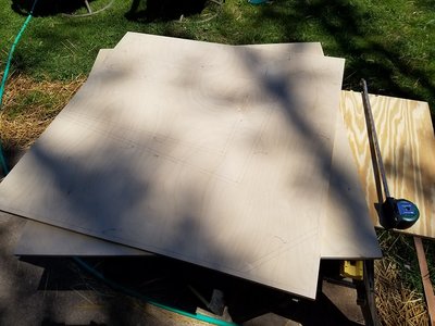

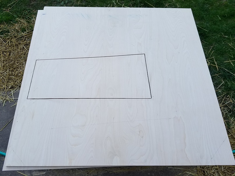

Continuing to work outside, I then carefully laid out all the lines on the side panel. I made sure to triple check everything, and then labeled each panel placement as recommended in the plans. I then used a 1/16” drill bit to transfer these measurements to the other panel.

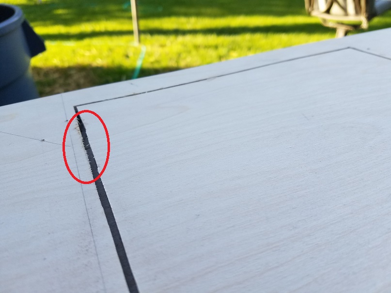

#8 Post by caleb105 »

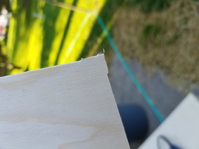

Next up was the plunge-cuts for the access panel. I once again used my sled. However, what I realized is that my circular saw does not plunge straight down… but moves to the side slightly as it plunges (circled in red below). Once it was plunged thru, I could make the remainder of the cut with the blade in a consistent location. Oh well… I’m probably just going to cover this whole thing with Duratex when I’m done anyway. Lol

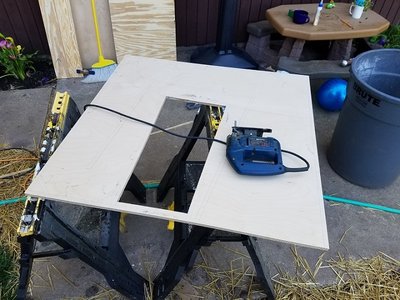

I used a jig saw to finish the cuts in the corner. It had a fine-tooth metal cutting blade installed in it, so I just used that.

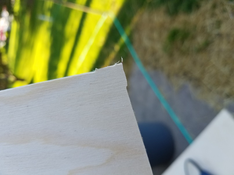

#10 Post by caleb105 »
I cut to the outside edge, leaving the extra material attached to the panel, then trimmed the tabs off the panel once it was removed.

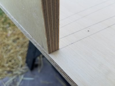

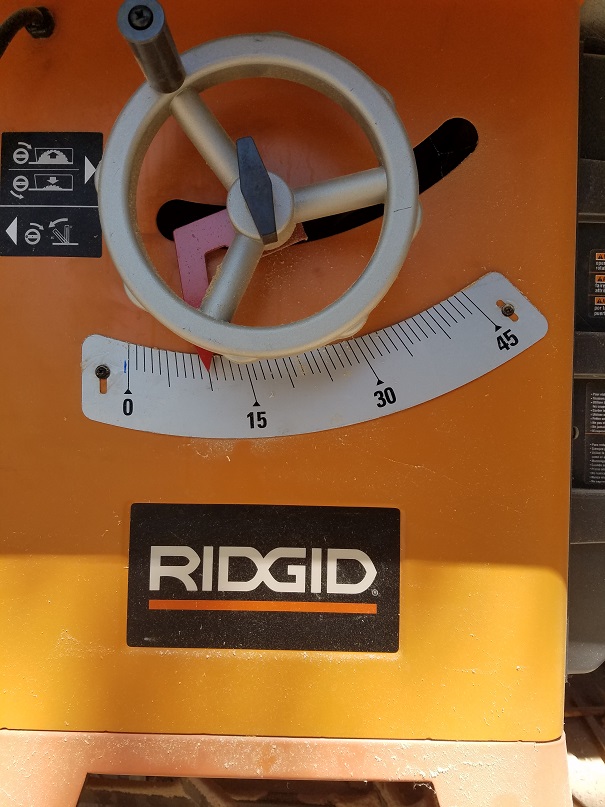

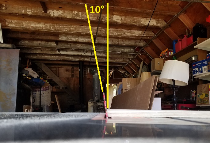

Another benefit of having a table saw is that I can easily dial in the angles for the panel edges.
