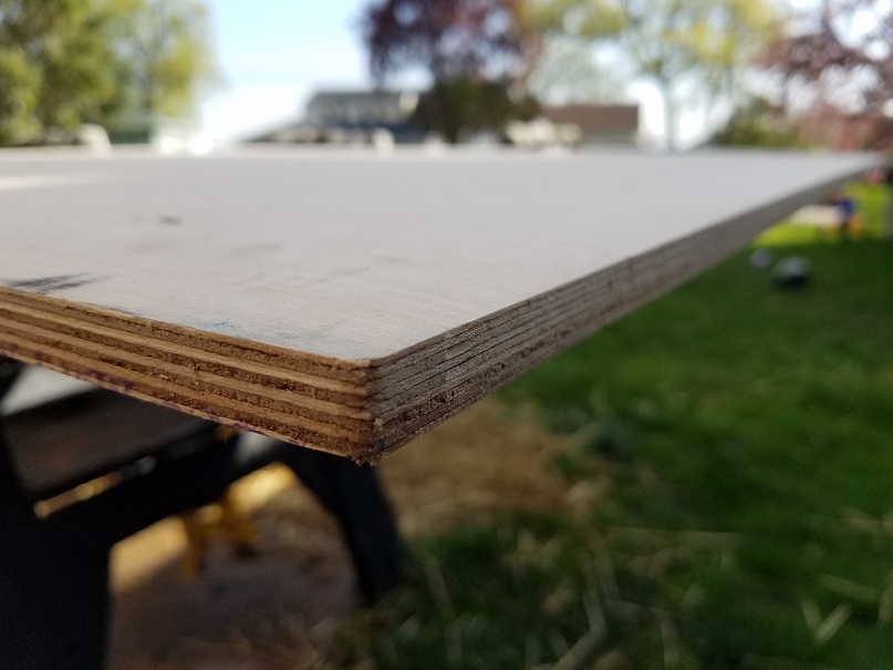

I live in Wisconsin. We have a regional store called Menards (similar to Home Depot or Lowes) that carries 4x8 sheets of Baltic Birch (item #125-3101) as a special order item. Current price is $57.99 a sheet. Compared to what some of you are paying, this is a bit steep, but compared to what the local lumber yards were charging in my area it’s a decent price. I also liked that I could get a full 4x8 sheet in case I wanted to build a THT-LP with 72” long panels.
I happened to notice that my local Menards had a single sheet in stock. Turned out someone special ordered it, then never picked it up, or returned it. They actually had it in their “Discount” section for $44 so I grabbed that, and special ordered another 2 sheets. Plywood total = $167.98 (w/ tax)
This is real 9 ply Baltic Birch plywood… different from the ACX plywood that Menards also offers.

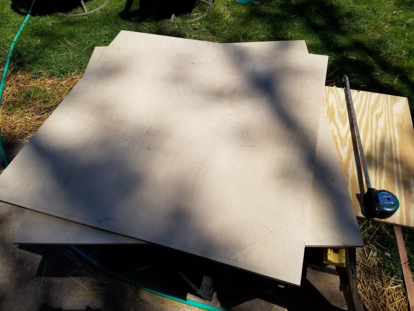

I’m going with a 24.5” wide THT. I considered going larger, but this is an efficient use of the plywood and will give me more options on where to place it. This requires ~2.5 sheets of plywood. Since I would have extra plywood, and since I plan on updating the rest of the system as well, I figured I might as well go ahead & cut out the panels for a 9 driver curved SLA center while I was at it.
I used a cutlist program to layout each of the panels before cutting (http://www.delphiforfun.org/programs/cutlist.htm). The panels circled in yellow are for the SLA center, and the rest are for the THT.

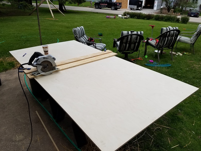

Since we just moved a couple weeks ago, and my garage/shop is in total disarray, I took advantage of the beautiful weather and worked outside on a couple sawhorses. I built a sled for my circular saw, and used that to rip the sheets down into panels that were ~1/4” larger than intended.
