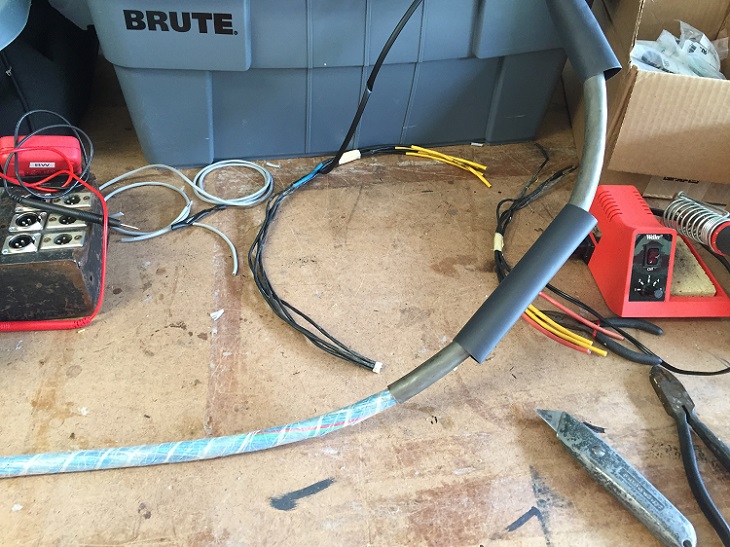

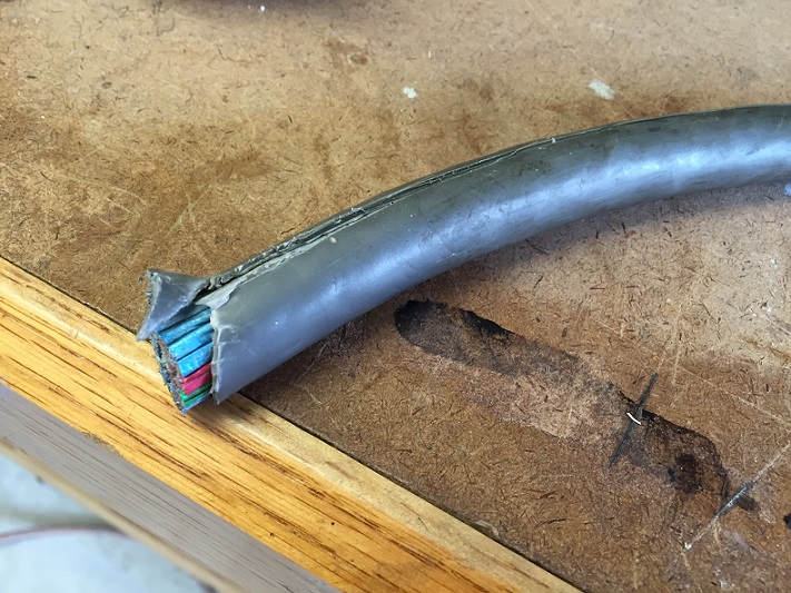

Cut the snake to make a clean start using a hack saw.....way easier and cleaner than trying to chew away at it with side-cutters.

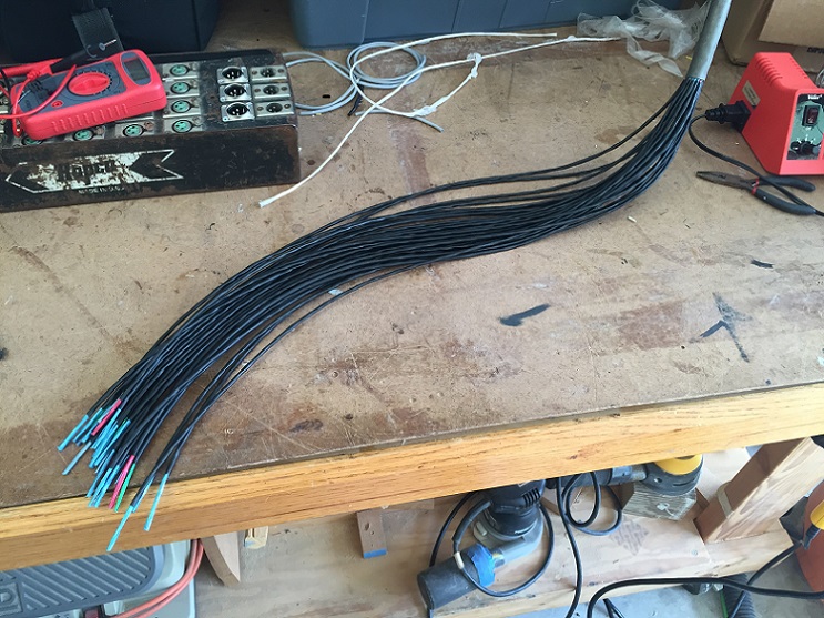

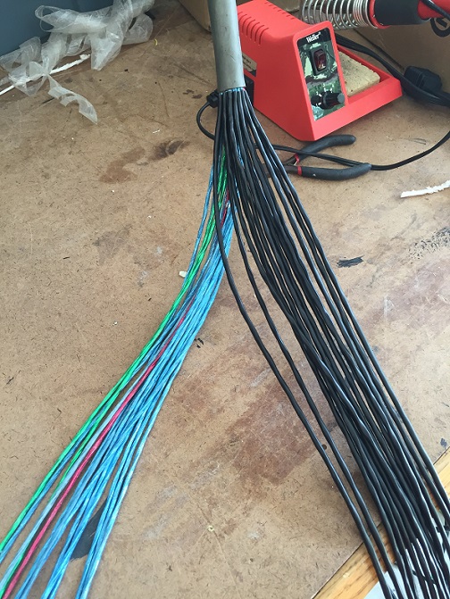

Got it all stripped back and slid on the new cable bale and the heat shrink for later. Half of the pairs have the heat shrink applied......I typically buy 4 foot lengths of heat shrink, but since I need so much, I bought a 100 roll on Amazon for about 17 bucks shipped to my door. All of the pairs are complete now.

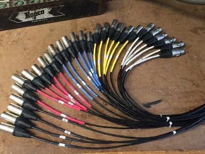

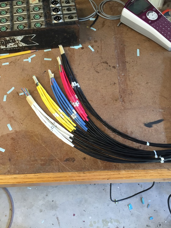

Next up was adding the colored ends, then applying a number on each cable with a label maker, then covering that with a two inch piece of clear heat shrink. Then, just added all the connectors and tested.
On the box, I used my punch to enlarge the hole left by the 1/4" jacks and added the XLRs for the additional returns....
Anyway.....it was something to do. Cost about $150 total to do the remodel on this old snake....
Now I have a spare and it's a hundred footer and my regular is only 75....so, more options.
