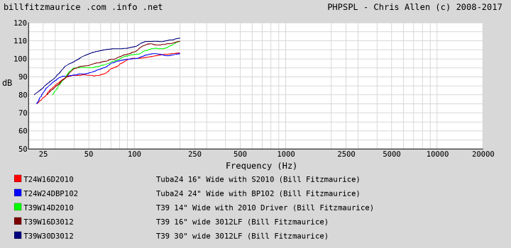

By your "dream signature", I'm taking a guess you and dad are building for mostly live music. If yes, I would strongly urge you to re-consider your sub choice. this chart will show why:
What does this all mean, you might ask... it means you get more bang-for-your-buck with the T39. It takes almost 2 T24 to equal the SPL of 1 T39. There is also the maximum voltage limits for each driver, 28V for the S2010, 34V for the BP102 and 50V for the 3012LF. As a bonus, the T39 can make use of the 3012LF, the T24 can't. For live music, and even for most DJ music, the T39 is all that, and a bag of chips!

Funny that you bring it up... Last night, I was reading a topic in the subwoofer section on the very same idea... My biggest "gotcha" is aspect ratio AFA pack space is concerned; which is one of the things that OP was also concerned about. That said, it certainly looks like a single T39 will out perform two T24's... which greatly mitigates that concern...
