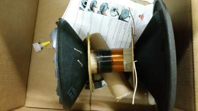

The original Lab 12 has double dust caps, the outer one is almost as big as the cone itself.
The recone kit has only one, and it looks like the inner one on the original. Is this correct with only this small one?
The cone, spider and voicecoil came all prefitted (very nice), but to me it looks like the wires are really close to the spider.
What do you guys think?

Since the dust caps are so heavy, I'd be worried that deleting such a large portion of the weight would drastically change something. Call them and tell them to ship it pronto.

Unless you've already destroyed it, you could probably salvage the old one.
