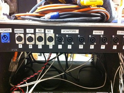

Re: Amp rack breakout panel
Photo courtesy of Bruce Weldy
A picture is worth a thousand words...
- Posts: 8665
This one is easier to see....
I built this one for a band I work with. This is their rack...
