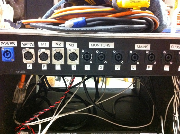

Photo courtesy of Bruce Weldy
A picture is worth a thousand words...
Posts: 8543
Re: Amp rack breakout panel
#4 Post by Bruce Weldy »
This one is easier to see....
I built this one for a band I work with. This is their rack...

You can buy panels with pre-cut holes if you don't fancy doing it yourself (like me!) or want a neater install:
