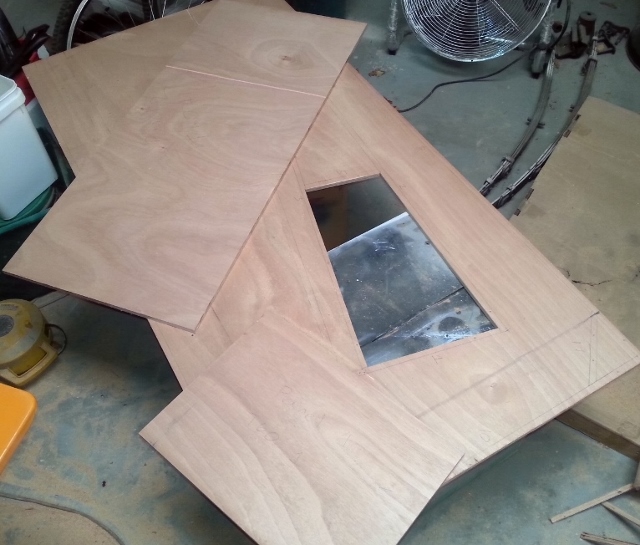

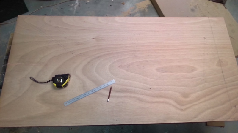

Marking out all the panels joins on one side

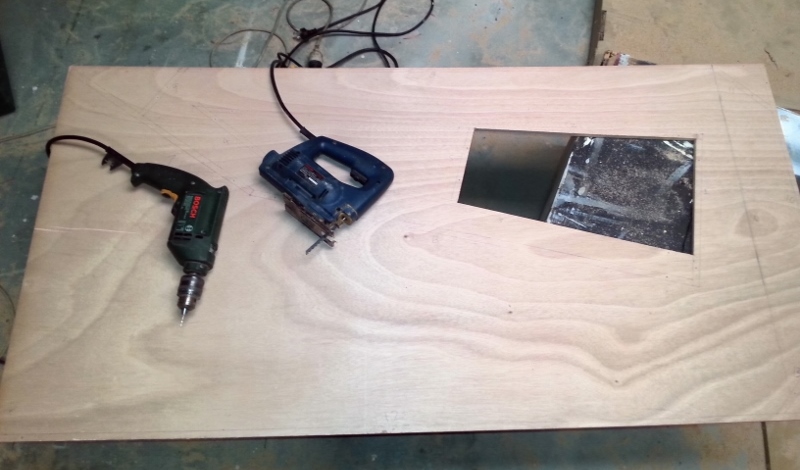

Cutting out the access cover

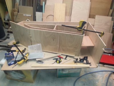

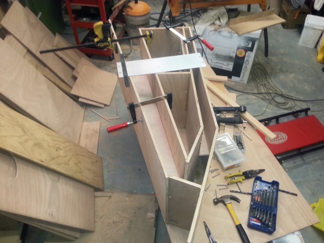

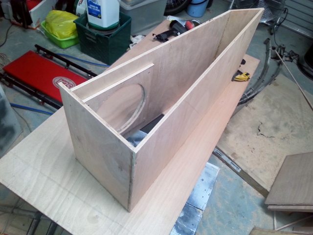

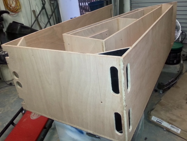

More progress being made
Top panel and brace installed

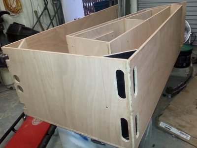

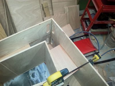

Handholds cut
Handholds cut
Back panel and brace installed
ordering the Duratex tomorrow
Should be finishing the first T60 soon :hyper:

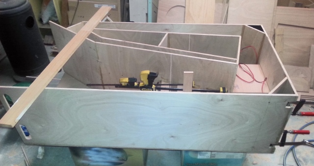

#11 Post by samaharris »
More progress. Power outage forced me to stop work for a day :cussing:
getting really excited to have the first one working :hyper:

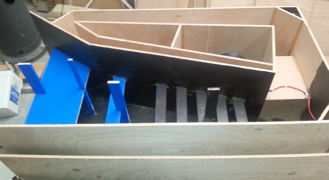

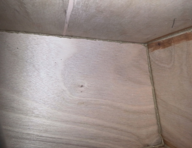

So close to finishing

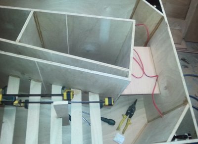

All braces installed and insides painted

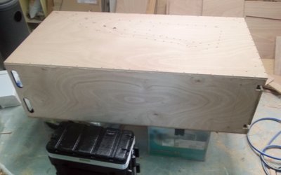

Second side glued and screwed

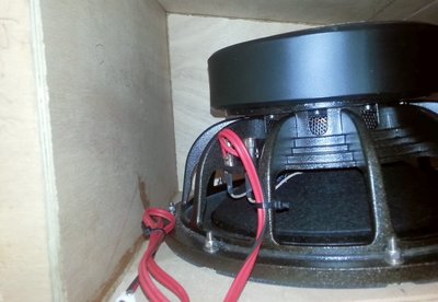

Driver installed and wired
PL squeeze out on all joins
Just have to do the air leak test, paint the outside in Duratex, install the cabinet hardware and seal the access cover.
