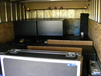

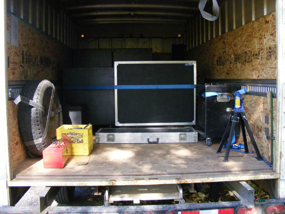

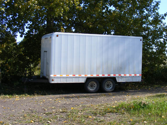

I built a trailer out of an old cube van box that was given to me free of charge, 16 feet long x 8 feet wide and 6 foot 8 inch high inside.
Because of the large floor area, I haven't had a need to stack anything yet. It has tandem 7000 pound axles, so weight isn't a problem. It's got a 15 foot aluminum ramp; I can load and unload it myself if there's no help available.

At that price, renting a cube van makes complete good sense. The problem I was running into with renting is you never knew for sure if a unit would be available unless you booked it well in advance of the date. Even then there were problems, usually at the end of the month when apartment dwellers were moving. Having this trailer eliminates the stresses of dealing with transport.
Some of the drawbacks to this trailer is it's high, a 32 inches deck height, which is a little high for ground level loading. I could have built it lower, but I would have had to cut wheel wells into the floor. I decided I would rather have an unobstructed floor inside and just put up with the extra incline on the ramp. The worst pieces of gear for loading is the cable trunk 22.5" wide x 60" long and the power distro with the AC cabling, both around 300 pounds each, however I can still manage to push them up the ramp myself. Praises to God for good ball bearing casters.
The other thing is it's heavy. The aluminum on the box is .100" thick. Oh well, I suppose it's better too thick than paper thin aluminum skins I've seen on some commercial cargo trailers.
