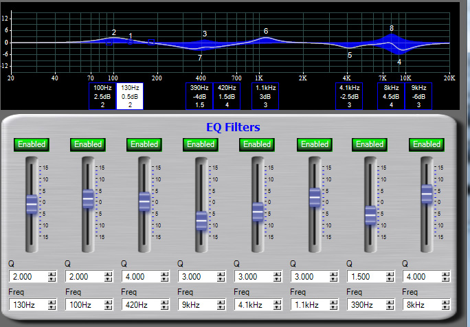

heres a pic of my current eq settings for the ot i believe.

Any boost or cut I posted is what the Driverack did on its own. Your eq curve kind of mimic's mine. That 4K seems to be an issue. When I had first checked the system in our practice room with my other sound meter the 4K needed to be cut 6db based on that too. So, maybe what I have is what would be expected for these speakers.sine143 wrote:dont trust the DBX mic above about... 4khz. wildly inconsistent between units imo.
Your measurement technique is not conventional, but for the sake of a "quick and dirty" test it does the job.
notes:
Dont boost 50hz (below crossover point, pointless)
How would you have done this initial RTA? What mic?

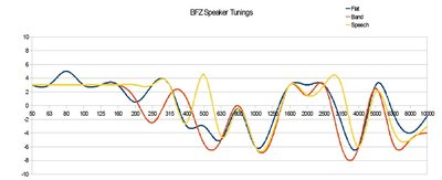

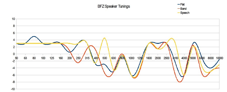

I got to redo my tuning today. I used the same setup (x overs at zero gain) and then ran it for Flat, Band and Speech. I recorded the db changes for each frequency and then charted them in a spreadsheet and graphed. Here is what I got.
Interesting where the changes are with each tuning type vs how similar.

I think I would forget about the various "tunings" and just set it flat as possible and then adjust it to taste from there. Full response more or less flat will sound good for music and speech.

byacey wrote:I think I would forget about the various "tunings" and just set it flat as possible and then adjust it to taste from there. Full response more or less flat will sound good for music and speech.
Yes, that is what I was thinking. But, I just wanted to see what it did and how it sounded. Running a song via the computer, flat actually sounds best. I'll hear the band tonight with it.
