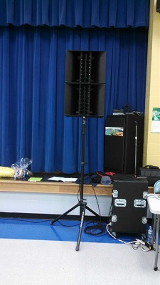

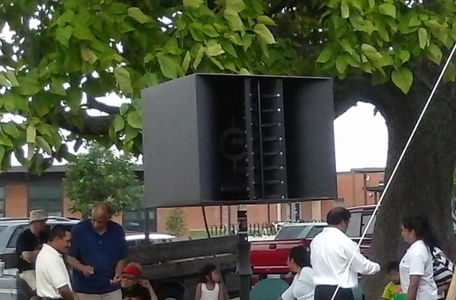

Well, I made four Jack 112L cabs, but only was able to load two (due to lack of fundage). Finished them Thurs, Aug 28 at 10PM, was able to squeeze in a short 20 minute EQ session indoors on Friday, then I ran them all day Sat for an outdoor church festival.
Long story short, I received one "it's too loud" complaint almost immediately, and several "sounds really good" and "sounds really clear" kudos throughout the day. Met one fine gentleman (even though he was a bass player, he actually was a gentleman :lol: ) who wanted to talk a little shop about the speakers. Once I mentioned BFM, he said he'd seen the website and got even more interested....
My verdict? Big thumbs up from me. I hate running live with untested gear, but the Jacks performed way above expectations. Outstanding design, Mr Bill.
Thanks.
:D

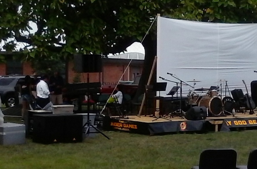

Now, for those so inclined, a bit more detail about Saturday's setup:
Behringer X32 Rack controlled by an Android tablet running Mixing Station, backed up with a laptop running X32 Edit
dbx Driverack PX
2 Jack 112L w/ melded piezo array and 3012HO driver
1 Behringer iNuke NU3000 for the Jacks
1 Crown XLS2500 for subs
2 Behringer B1800X Pro subs (awful, but I knew that going in...Titan 39's hopefully soon)
2 Behringer B215D's used as monitor wedges (awful, but I knew that going in...Wedgehorn's hopefully soon)
3 Kustom KPC12M wedges (awful, but I knew that going in...see above)
The Jacks completely killed the subs, which were flat out all day. Originally crossed the Jacks over @100Hz, dropped it to 80Hz and got more hit. I am going to set back up and see if the Jacks full-range will have more low-end than using the Beh subs....I'm betting it will be close.
I didn't get a chance to check voltage to the Jacks, but I do know the iNuke 3000 was running out of steam before the Jacks...
As far as the Jack build process, I'm an amateur woodworker...It took longer than I expected (of course) to build the four cabs, but the plans were detailed and precise. I really didn't have any issues other than the bent throat sheaths, which had me stuck for a day or so... My duratex application (rolled on) leaves something to be desired, I'm not great at painting. I'd like to get a spray gun and shoot the stuff in the future.
I've got to put handles on them, and possibly stacking corners, but other than that, I'm a happy camper.

Cabs look good. Handles and corners will serve you well.
Do I see clustered subs?

NukePooch
Posts: 371
Location: Berea, Kentucky
Re: Jack 112L First Blast
#3 Post by NukePooch »
Thanks.
Yeah, both subs are to the left of the speaker stand in the wide view pic. The amp rack is right behind them.
I forgot to mention that I ran off two Honda EU2000i generators. I probably could have easily run off of one, but...I like to have backups for my backups.

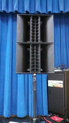

Two years later, still getting comments on the clear sound and unusual looks of my Jack 112L's. I now have all four working, and recently bought two more Jack 112's (non-Lite version with straight arrays).
The only problem I had was that I hot glued the PVC diffuser into the two original arrays...and due to heat, one became unstuck. So, reglued both with CA glue, and all is well. I did also rebuild my second two 112L's with melded arrays. I like the looks of the melded, and I wanted to be able to grab any of the four and have the same thing. (I was worried I might go out on a gig with one melded and one straight...)
They still continue to astound. Love these things.
Aren't they purty?

Aren't they purty?
Very.
