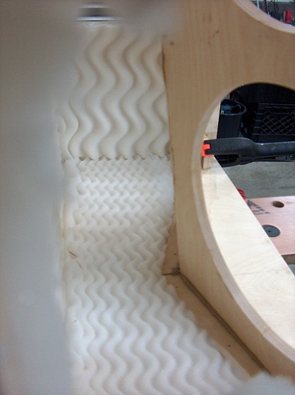

All stuffed.
10 stuffed.jpg (135.71 KiB) Viewed 3034 times
One more picture in the next post.

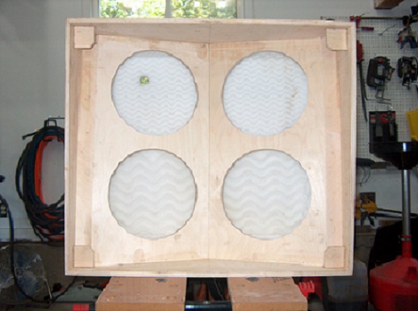

Last picture for now. The parts are ready to be assembled. I plan on doing that tomorrow along with adding the tabs for the grill and building the grill. Then it's off to my bass players shop for him to router the corners (I don't own one) and spray the duratex.
11 Parts complete ready to assemble.jpg (142.07 KiB) Viewed 3034 times
What looks like tabs on the baffles are just that. Because I'm using fill strips, I decided to add these pieces so that the fill strip has something to rest on besides the two end while assembling it. The tabs are angle cut and then were test fit with a small piece to make sure the fill strip and baffle edge is flush. The fit I have is tight, so this might not be needed, but...

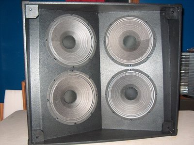

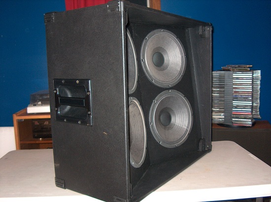

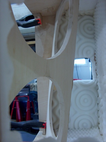

I finished the assembly today. Here are a few pictures. A couple are a look through the handle opening. Something different?

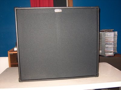

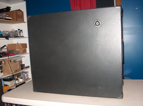

Well, this cab is finally done. Yup, just like with the T39's, I had to wait for my band member to get to doing the finish work. I got to put in the speakers today. Plugged it in to the Princeton just to make sure it worked. Yes, it does. :hyper:
I got some video of the original cab so that I can put up a comparison for people to hear what these designs do. I may be a couple weeks before I get to record this cab. I'll post a link here when it's up.
The camera had a hard time with the front view do to the angle of the interior. Kind of makes it look a little warped.
