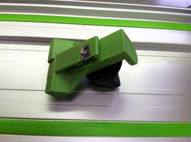

Aiden,

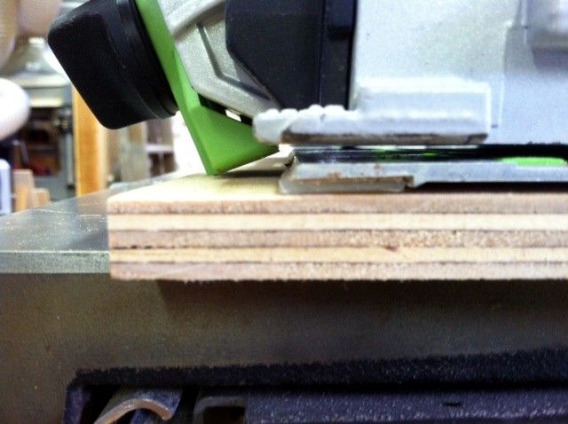

The Festool TS55 does a fantastic job on straight and bevel cuts. You do need to remove the outer splinter guard for bevel cuts, but that takes all of 5 seconds.
If I explain how the system works, this all will make more sense.
When you make a cut on any circular saw, the blade rotates in a direction so that the teeth cut upward at the front, making the teeth emerge thru the top surface of the board. This is done mainly for safety, so that the saw is drawn downward toward the work. Most splintering is on the top surface as the teeth pry away the wood fibers. As you cut a slot thru the wood, you are turning one board into two. Think of those as the "good" and "waste" sides of the cut. On the the Festool track, the plastic splinter guard just touches the blade, preventing the fibers from lifting (it is a perfect custom fit because you cut the strip with your saw the first time you use it - genius!). On the waste side, a removable green plastic guard does the same job of preventing fibers from lifting (yes, it is also "custom cut" the first time you use it). When you do a bevel cut with the TS55, the Festool engineers designed the tilt mechanism so that the blade always touches the "good side" track guard at the bottom edge, making cut alignment as easy as a straight cut and preventing the strip itself from being cut. On the "waste" side, for bevel cuts, the guard needs to be removed because it tilts down and interferes with (hits) the top surface of the wood.
The Festool blades are so sharp and the kerf so narrow that splintering isn't much of a problem anyway with the outer guard removed using the proper BFM "multiple even layer" plywood (no thin splintery outer plys for us).
I'll attached some pics to illustrate.
Hope this helps.

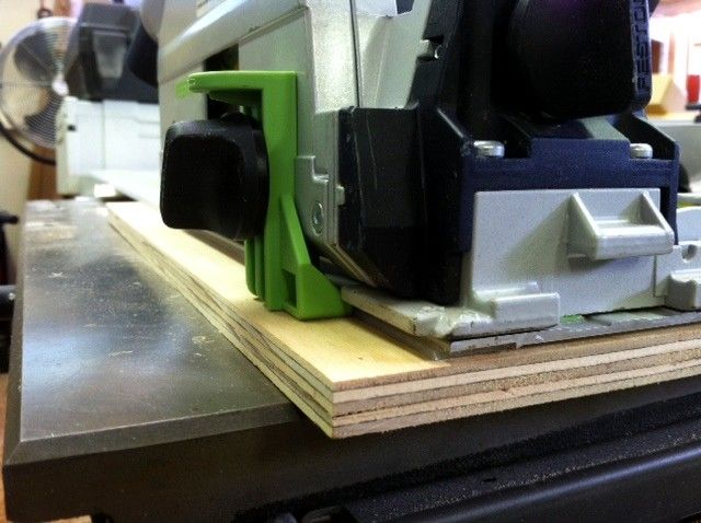

Here is a view of the TS55 ready to do a straight cut with the outer splinter guard attached
Here is a shot showing why the outer splinter guard gets removed for a bevel cut - easy on/off
The splinter guard itself, showing the cut made by the blade.
