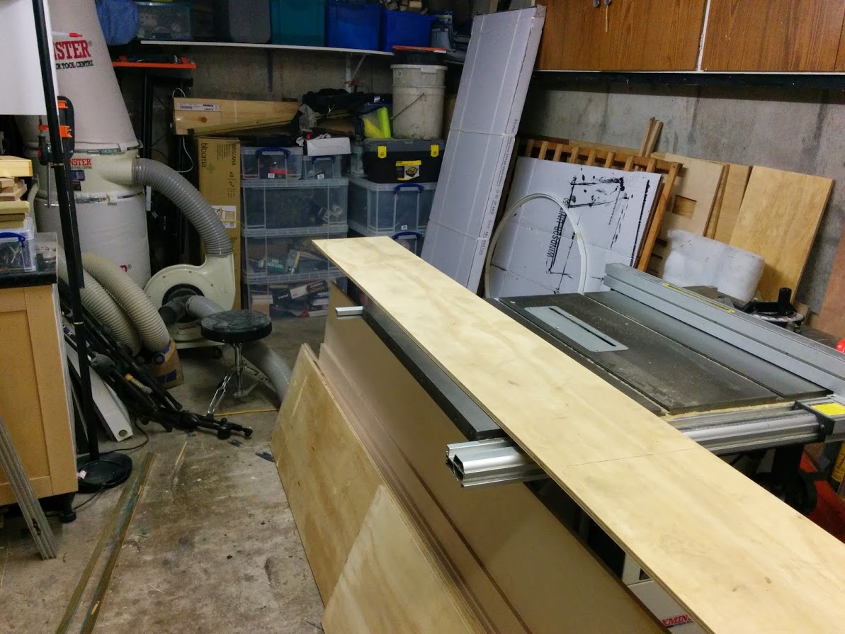

The first stage of this project was getting access to my table saw. The garage has been a tip for far too long and I've spent more time organising and binning that will probably take to build it!

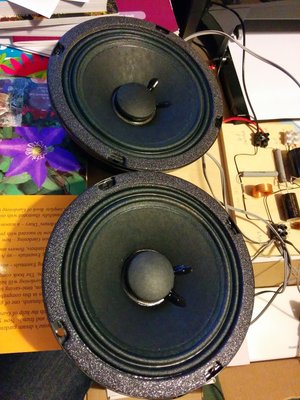

I've purchased my Alpha 6's already and they have been through a breaking in process. Although I shouldn't need them for a top, it can't hurt.

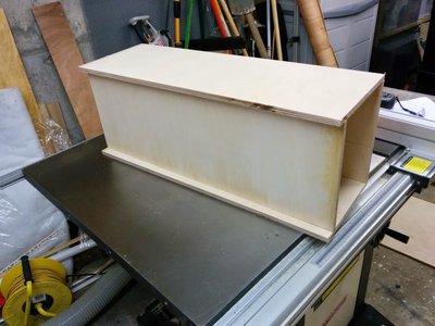

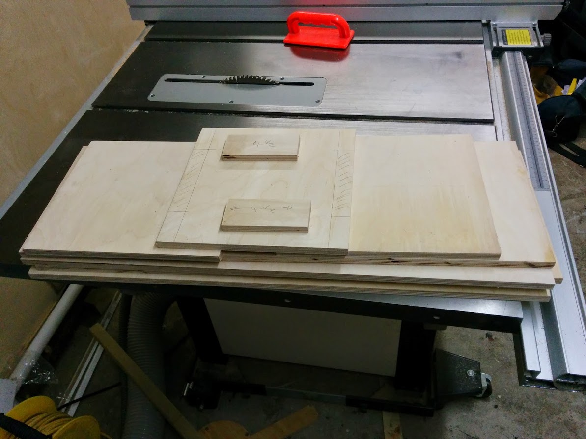

Four pieces cut, front back and sides.

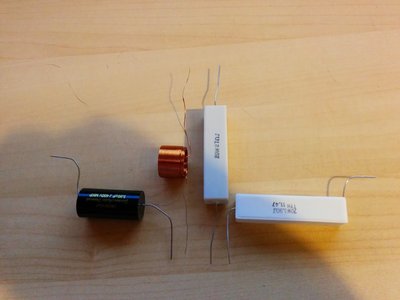

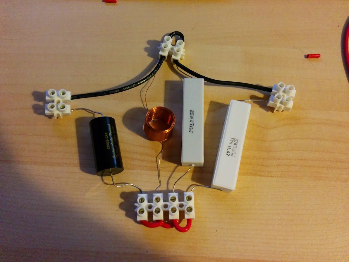

Also, the crossover components arrived but the resistors are different from the last time, so I'm not sure if I ordered the wrong ones. I couldn't get 30Ohm resistors, only 33 and 27 were available, so I opted for 27. I don't know what difference it will make.
Here is a picture of the Jack crossover and you can see the different resistor type. Do I need to get some different resistors ordered or will the ones I have do?
Re: SLA Pro build thread
#3 Post by Grant Bunter »
Wire wound, with ceramic white coating, as per your top pic, have been fine in my DR's.
Oh, and they came from Leland...

#4 Post by Bill Fitzmaurice »
The resistors are within the requisite 10% value tolerance.

There is often talk about the orientation of the inductor. Is it fine as it is or do I need to rotate it? I've never bothered before.
Hackomatic
Posts: 400
Location: West TN
#7 Post by Hackomatic »
No worries there . . you've got plenty of offset.

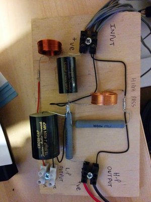

I've wired the crossover, ready to glue:

Got some more time this morning to do some more cutting.
The internal braces are cut:

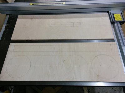

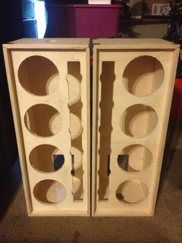

I've marked the driver holes and the piezo holes as well as the ports/handles. I made a trip to town with the Mrs since the protracter I had was quite simply rubbish. I'm going to redraw all the driver holes before cutting with a jigsaw:
This is all there is to an SLA Pro:

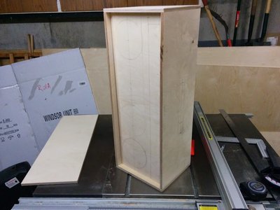

I alway like to do a quick dry fit to make sure everything is in order:
