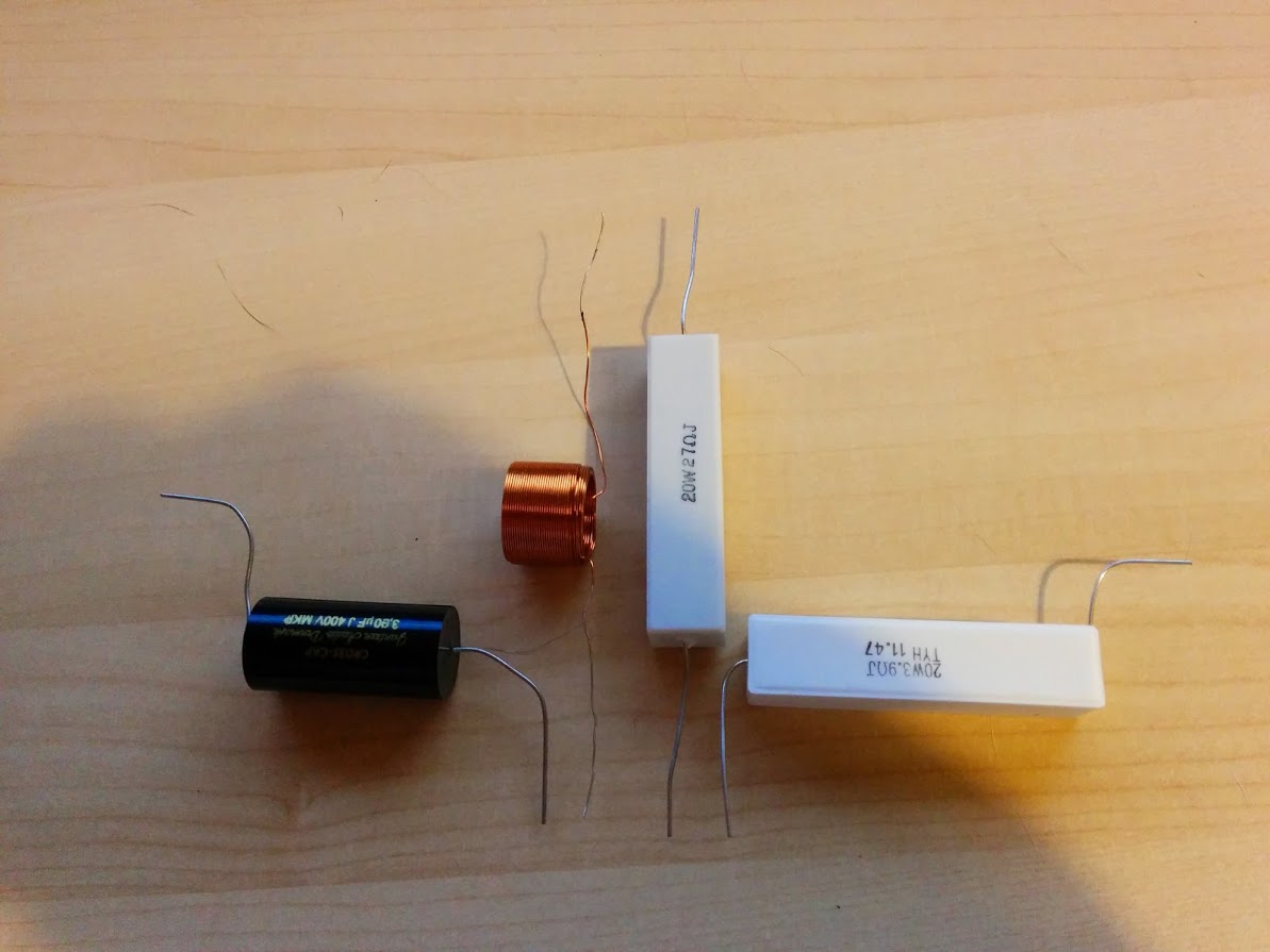

Also, the crossover components arrived but the resistors are different from the last time, so I'm not sure if I ordered the wrong ones. I couldn't get 30Ohm resistors, only 33 and 27 were available, so I opted for 27. I don't know what difference it will make.
Here is a picture of the Jack crossover and you can see the different resistor type. Do I need to get some different resistors ordered or will the ones I have do?

Wire wound, with ceramic white coating, as per your top pic, have been fine in my DR's.

The resistors are within the requisite 10% value tolerance.

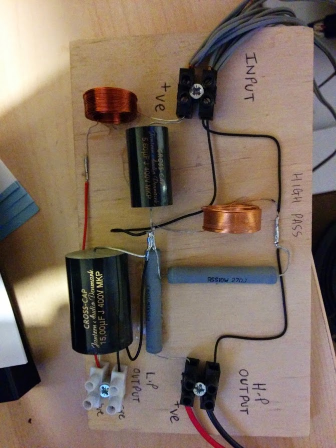

There is often talk about the orientation of the inductor. Is it fine as it is or do I need to rotate it? I've never bothered before.

I've wired the crossover, ready to glue:

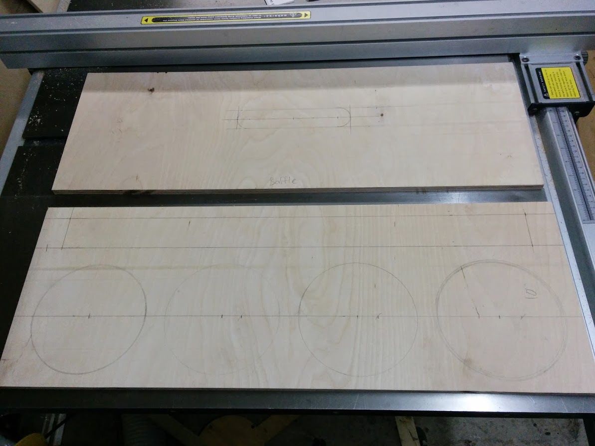

I've marked the driver holes and the piezo holes as well as the ports/handles. I made a trip to town with the Mrs since the protracter I had was quite simply rubbish. I'm going to redraw all the driver holes before cutting with a jigsaw:

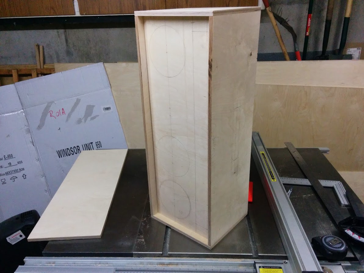

I alway like to do a quick dry fit to make sure everything is in order:
