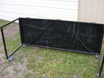

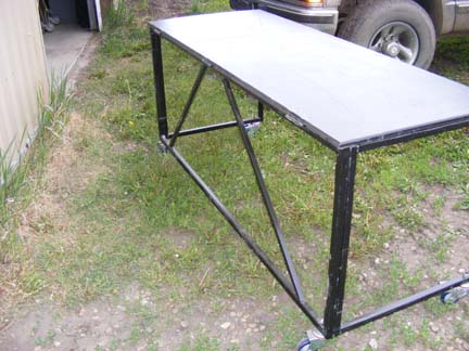

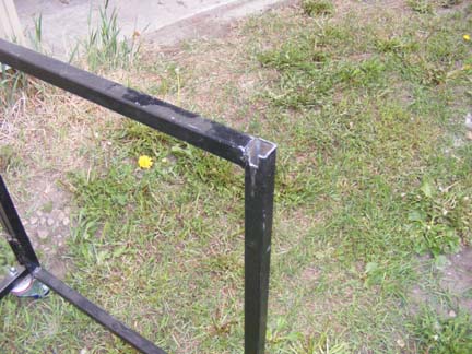

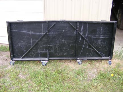

As I mentioned on a previous thread, here's pictures of my DIY folding FOH console table.
It's made from 1" thinwall tube, four casters, seven hinges and a sheet of 3/4" plywood.
When folded, two long wingnuts hold the whole thing together for transport. Not shown is a handle on the underside of the tabletop that is convenient for wheeling it around while folded.

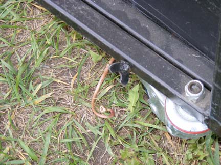

In Photo 109 you can see a closeup of one of the wing nuts (Wing bolt?) that holds everything together when folded. It's simply a 1/4" bolt that I welded half of a washer to the head forming the wings for tightening.

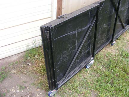

Here's the rest of the pics:
You can see the carriage bolt head that drops into the square notch when the top is flipped up into place. This locks the fold out sides so it can be conveniently wheeled around with the console and other FOH gear on the table top.

Thanks Grant. The main thing is it's solid, will support at least 400 pounds and is convenient to pack in the truck and move around.

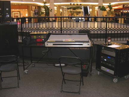

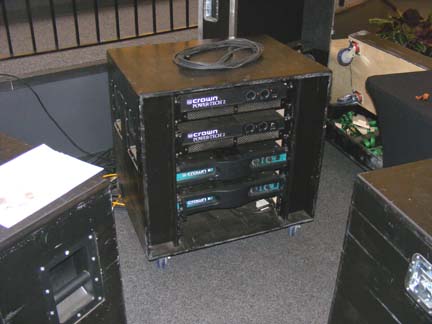

Here's some pics of the table in use:
